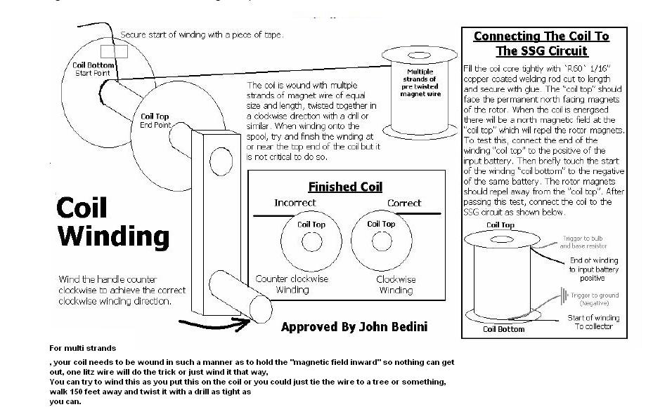

      Coil should be wound CW (clockwise) and as neat as possible, layer after layer. Start and end should be marked and wires checked for shorts and conductivity. See the pic below. Small black dot near coil diagram on the schematics usually means the start or beginning of winding. This is important.

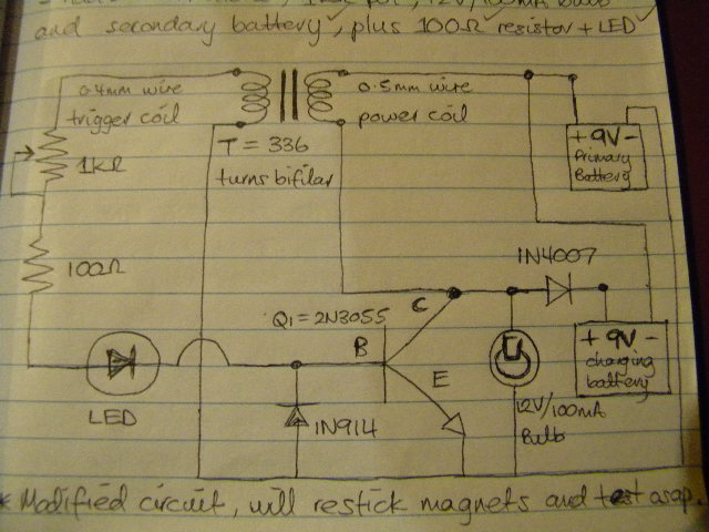

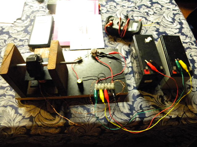

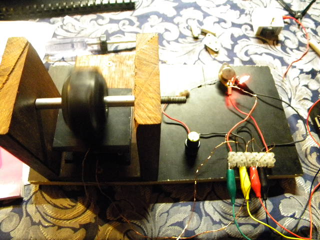

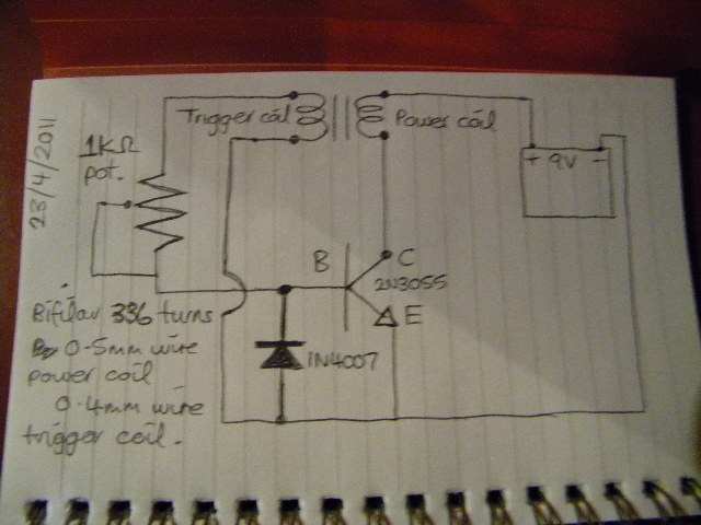

              Same problem as N8
              I have constructed the basic SG North pole motor from the old Bedini SG information online and have some issues with getting it to sustain the rotor.
              Thus far the results have been.
              1) When hooked up the circuit I had the same humming sound emitted from the coil, however no movement in the rotor. (This indicates the self oscillations are making the rotor act as single big magnet, need some input here please if people know my issue?)
              Have pic of circuit. ( will post when upload to facebook or is there somewhere here, I'm new to forum?)
              2) When I swapped to the SSG circuit with more components the rotor fired for a short time adjusting the 1k Okm pot to a smaller resistance but then self oscillations stopped the motion. 500k Ohm pot on 100k didnt get movement or at lowest or highest setting.
              Is step in the right direction, now to play around more with resistances untill the new wire spools arrive (AWG 23,26 I use, SWG 24,27.5)
              3) The 12V/100mA bulb is on all the time sure is a issue there even though I have the circuit hooked up right. ( Well is backwards to any circuit I have seen/used but that was the attraction to Bedini/Free energy technology 6 years ago that works. I just need to work out my errors and scale it up and make more advanced versions.
              Sorry to bombard you guys with heap of questions but I have played around and at a point where I need some help

                one thing you can try that gave me a lot of information is to hook up an LED with a resistor across your power coil and spin your rotor. if the LED doesn't fire, it is likely you're magnets are too small to trigger your power coil and get your motor to pulse.
                check the resistance of your power coil, it should be between 4 and 6 ohms.
                make sure your magnets are not too close together, that could be causing it to self oscillate too.
                Magnet size/strength, coil length, and overall resistance are the keys to getting these small ones tuned correctly. it's a lot to play with, and I have been told using neo magnets really makes it a lot more tough.
                I am about done building my bigger wheel with larger ceramic magnets, should have it done either tonight or tomorrow night!
                hope this helps, and good luck!
                it can be a bit frustrating to get running at first, but once it takes off, it's a blast to watch go

                    • #55
                      Thankyou for the input
                      Information I didnt state before in last post on the coil and rotor
                      Coil = 19mm bore (ID), 32mm width (OD), 37mm height
                      turns = 336 Bifilar #23,26 gauge (use SWG 24,27.5, same as AWG 23,26)
                      rotor = Standard skateboard wheel
                      bearings = Speed Demon ( I swapped the bad standard ones out )
                      Magnets = Ceramic ferrite 25x11x5mm ( 1',.5',.25' about)
                      Primary and Seconary batteries = 9V transistor battery ( will get 12V/7aH )
                      N8,
                      When I hooked up the LED in series with a 1k ohm resistor to the power coil and manually spun the rotor it didnt light. ( Not the result I wanted )
                      My power coil is 3 Ohms and trigger is 4 Ohms and is not in the 4-6 Ohm range needed. Winding new coil now with 400-500 turns of 0.3, 0.25mm wire ( AWG 28,30 looked it up ) I know this will get me the 4-6 Ohm range needed for my coil. Coil dimentions are 19mm bore, 65mm height and hope to get 50+mm width when wound.
                      As for magnets, I'm using 4 poles evenly spaced 90 degrees apart and have a Neodymium 4 poles rotor ( just finished glueing last on with epoxy ) but the Neo rotor I will hold off using with SSG circuit.
                      Thanks again N8, keep up the posts.
                      Blackchisel97,
                      I only used the 500k pot in place of the 1k Ohm pot once for test. I have swapped resistances from 100 Ohm to 500k Ohm ( to affect varying resistances )
                      After research and checking an older 150 turn bifilar AWG 23,26 coil I wound a year back I found my latest coil is not clockwise
                      And sealed with polyurethane so will be hard to unwind.
                      I reversed the coil but not trigger wires, thanks for the tip.
                      When I hooked up power coil to 9V battery it does repel the rotor slightly.
                      dR-Green,
                      Thankyou for the input, I will swap in the 680 Ohm resistor was going to try soon anyway. As I adjusted the 1k pot a few times it seemed that the rotor did speed up you could hear it, however, took notes but have not replicated yet.
                      Hope all this changes and fine tuning helps i'll keep you informed.

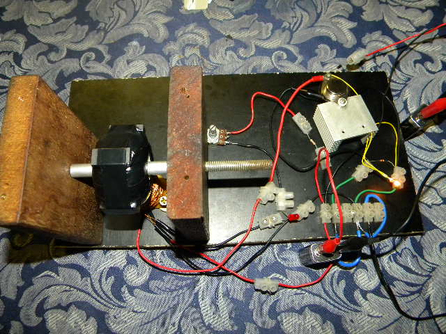

                        ZeropointEnergy Do me a favor and remove this 12V 100mA bulb from the circuit and try to spin.
                        Also, remove LED.

                          two things that come to mind...
                          1. your magnets look like they might be a bit close together. they should be at least 1.5 magnet widths apart, yours may be, but just thought to mention it.
                          2. i could not get mine to spin with 9V batteries. not my original setup, though i have not tried it since i have improved my setup vastly. I had to use some 12V lead acid batteries to get mine to work the first time.
                          just a few things that might help

                            My Bedini SSG Energizer/Motor is working
                            Hello All,
                            I got the Bedini SSG circuit working after adding more AWG #23,26 to bring the resistance to power = 4, trigger = 7. ( from 334 to about 600 )
                            I picked up a few Ne2 Neon Bulbs and added one to my circuit finally as well, then soldered all together.
                            Used:
                            D1 = 1N9148
                            D2 = 1N4007
                            R1 = 680 Ohms
                            P1 = 1K Ohm .5W Potentiometer
                            Q1 = 2N3055
                            Neon = Ne2 (Green, Red)
                            When I fired up the circuit it spun it the rotor fired for 30 seconds then began to slow down, but with a little tuning with the pot and the rotor sped up and was putting in 16V in a dead 12V/7aH battery from a PC surge protector that was broken. ( what spikes you guys getting across them? )
                            Have given it two 10 min runs and secondary battery is 5V from 3V, not great but really havent played around much, expect abundant improvement.
                            First test didnt have all the housing screwed in since didnt expect to work other was with secondary circuit soldered together. ( changes are 100 Ohm resistor in place of 680 Ohm to test rotor speeds, plus a green neon bulb.)
                            Will post video up when I join youtube and get the SSG circuit fine-tuned.

                                I have not quit trying since my last post here, and still cannot get it to work. I have a couple of questions:
                                1.Will the ciruit work if the resistance in the coil is less than 4?
                                2.Is there a big problem with using 6 volt batteries?
                                3. Could my problem lie in the fact that I'm using strong neodymium magnets?
                                I would like to point out I just made a new circuit because my old one was getting really disorganized. The circuit is doing absolutly nothing except for lighting the neon bulb, and is not occilating like yours did when it was not working.
                                Thank you
