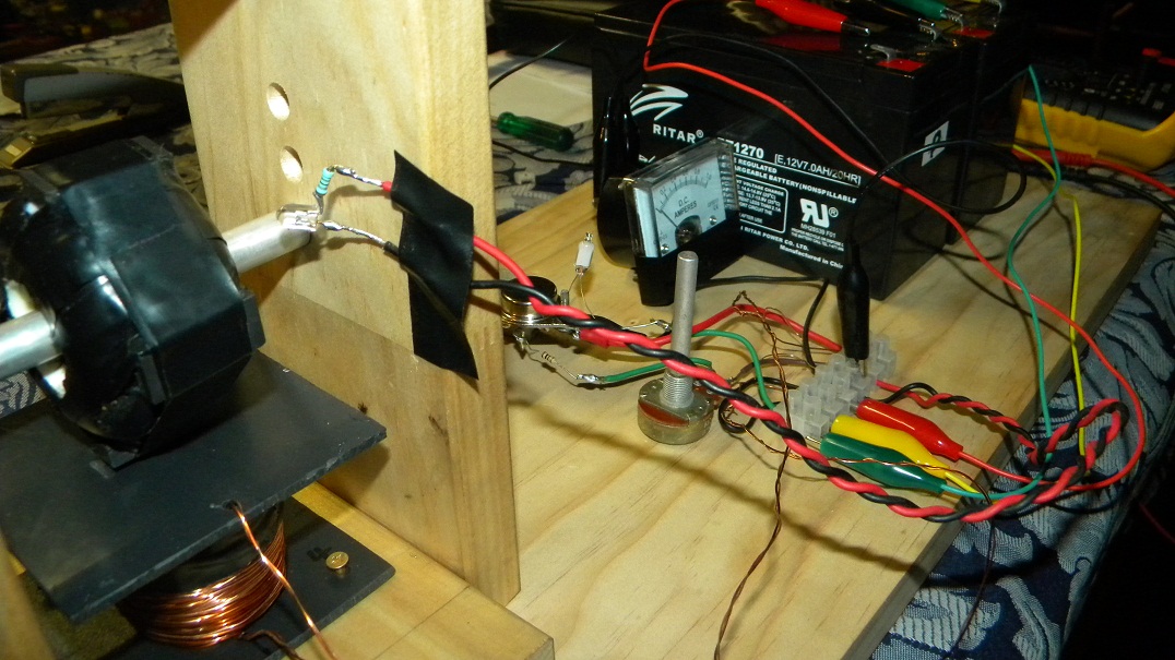

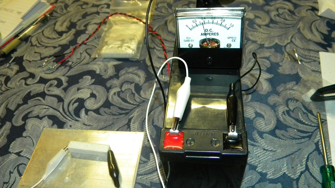

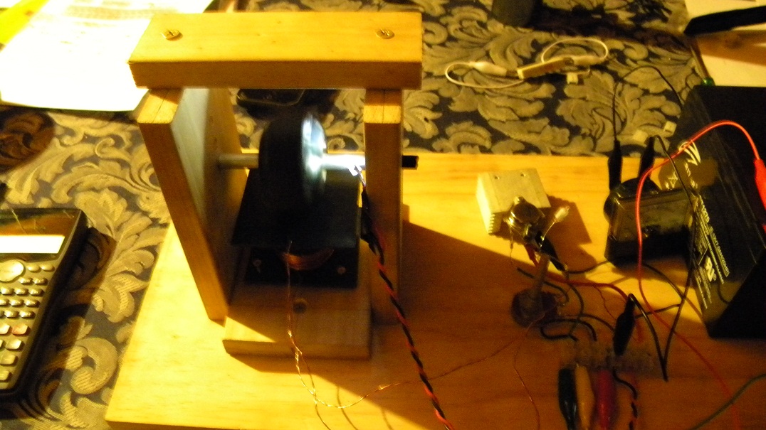

                          Hey,
                          I mistyped that and when I tested the light in the circuit with my panel ammeter hooked to the positive of the charging battery. ( read up on that to unsure correct COP testing ) And with LED in parallel the current input to the charging battery is 55-60mA, but uses 180mA from the primary battery.
                          I have been hooking up meter to verify current draw then remove it as they said in guide so the charging cycle isnt affected.
                          I need to change the tape colour on my rotor and will re-glue at the same time due to one pole was 3-4 degrees off 90 degree spacings.

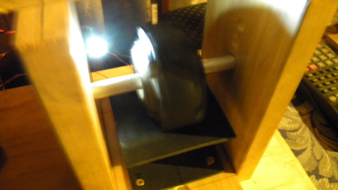

                          The hertz is 264Hz across the trigger coil and therefore with 4 magnets on the rotor I calculate:
                          264 x 60 / 4 = 3960 RPM
                          This seems to fast for a little unit drawing 180mA, however I have rubber stoppers on the board and still has an abundant amount of vibration from the units power.

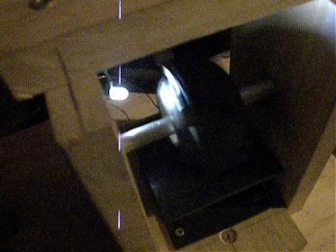

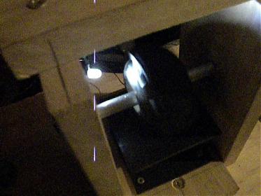

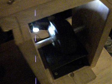

                          Finally I did note an anomaly with filming the tuning sequence?
                          As the Digital camera was close the the light at the front of the housing where the LED is taped on you can see broken lines as the SSG is tuned and comes up to speed ( the pulses were broken, uniform lines and was another great way to see the output trigger pulse. )
                          However, this only appears is the video as when you take picture the camera removes it ( maybe due to the HF of the pulse? ) but it did not matter if was in the light or the dark to see the anomoly on the digital camera.
                          I'll post a few pics of the tuning I do have great video footage of tuning in the dark but will need to edit it down to 3-4 mins.
                          I'm using a 33 Ohm/10W resistor for discharging tests there is a pic.
                          Zero

                          • #88
                            Anomoly
                            Hey Guys,
                            Here is the pic of the anomoly I mentioned a grabbed a snapshot from VLC player, enjoy.
                            Zero
