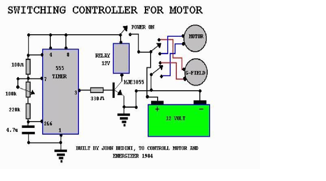

                  You say: "When JB moved away from a commutator and brushes he used a 555 timer cct to trigger a DPDT mechanical relay". Where does this come from? It is at variance with his 1984 paper on the "Watson" machine, a jumbo version of his original development. Maybe it is an improvement or possibly a misunderstanding and a move in the wrong direction.
                  Bedini said in Electricity's Watson thread, that Watson used his 555 timer circuit. In Electricity's Watson thread Bedini's ire was a bit raised and he made some valuable comments.
                  I've attached a copy of the circuit.
                  It looks like the duty cycle of alt to batt and batt to motor, are both close to 50%. I doubt if Buzzy's switch is more than 25% duty cycle for each.
                  This may allow for the use of an AF alternator instead of an energizer.

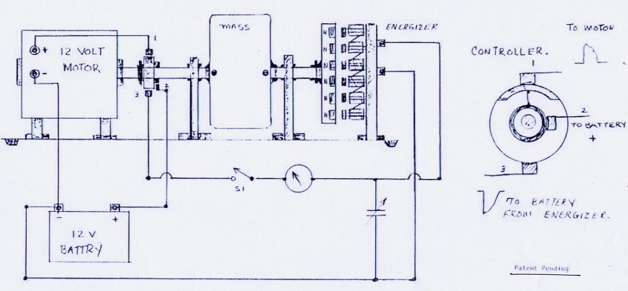

                  • The drawing I have in mind is as attached. But I recall a method of ensuring that the pulse to the motor is out of step with the pulse from the energiser. I can't remember how this is done. Possibly by rotating the energiser coils setup whilst watching the output on a dual trace oscilloscope connected to the motor and the energiser.
                    • With the commutator in the pic the motor is disconnected at least on the pos leg when the pulse is sent to the battery.
                      The pic doesn't show a bridge rectifier between the energizer and the cap which is needed.
                      John B is saying nonlinear energizer.
                      For example, 6 coils and 7 magnets.
                      The energizer would be pulsing into the cap when the motor receives it's pulse and it does look like one could use a dual trace scope to place the motor pulse in between energizer pulses as you suggest.
                      The energizer puts out AC, so maybe at the zero crossing once per revolution.
                      bro d
