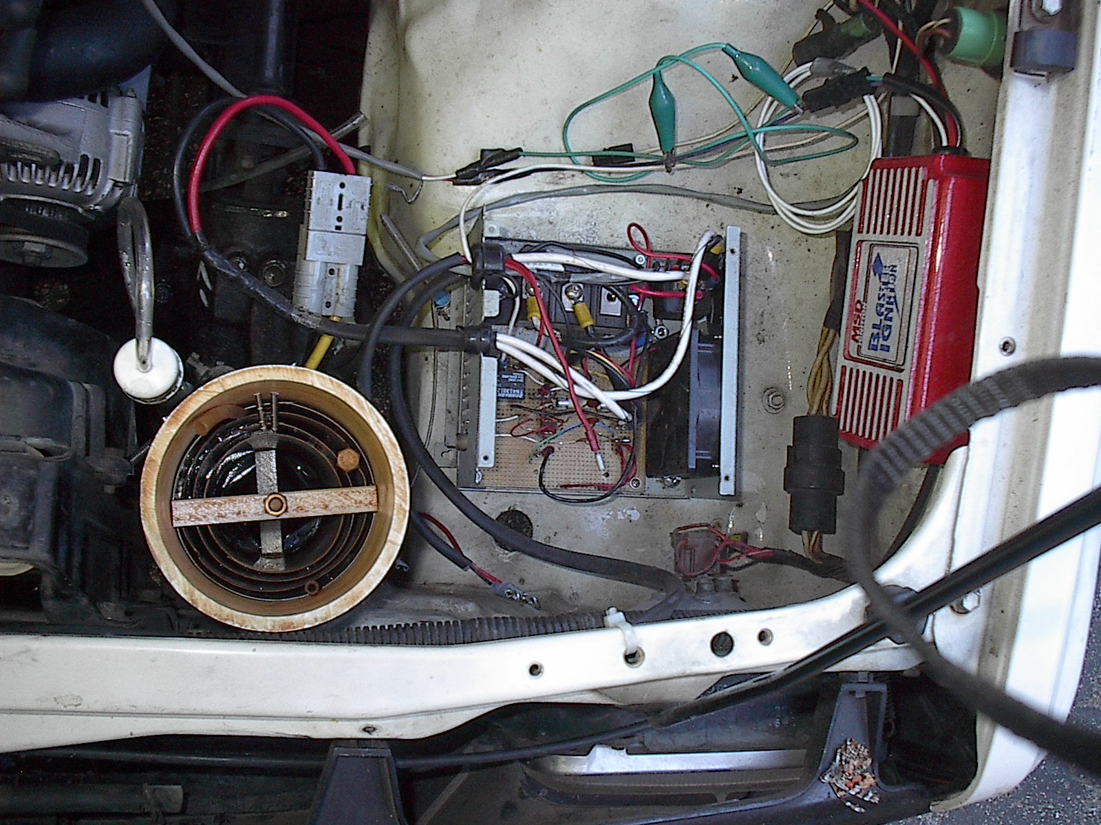

                  My dirt simple cell
                  This cell was my first working model and was thrown together on a Saturday afternoon. It consists of 4 tubes 7" long with .5" difference in dia. in a 12"X4" PVC chamber, the 2 middle tubes are Neutral or parasitic. A home built PWM running at approx 43 KHz
                  Tubes are 26ga. 304 SS rolled and spot welded.
                  Electrolyte is KOH @ 1 Tsp per gal.
                  HHO out put is close to 2Ltr a min with less than 20amps draw
                  Automotive PCV valves on top act as flashback arrestors.
                  Output runs directly in intake manifold
                  Vehicle is a 1986 Toyota pick up with 22R carburetter engine 120,000mi
                  MPG before 19mpg city/24 mpg hwy
                  MPG after installation 25 city/27 hwy
                  MPG after conditioning 27+city/ 32hwy
                  I have yet to install an EFIE (yes it has a O2)

                    Hey Tarkus
                    Pretty cool for a saturday afternoon project.
                    Can you help me understand why the two tubes in the middle are Neutral? It looks like this is a single cell setup vs. series cell from the description.
                    How does the system do with temperature over time?
                    I am still looking to see if someone has built an Archie Cell setup that I can learn from, its looks like a cool setup, but I need more information on how to build it than what I have found on the net...
                    Banshee

                      That sounds like a decent setup. Did you actually use any of the components of that computer PS or just the shell and fan? I've assuming that's what you're referring to as the PWM correct? How often do you have to change the electrolyte? When you say the SS sheets are rolled and spot welded do you mean the seam is completely sealed or are there places that the electrolyte can leak into the other cells?
                      • #26
                        Hello Tarkus,
                        I am considering a build similar to the one you show here. Is the innermost tube the cathode, and how full of electrolite is the unit? To use nuetral we have to separate the cells from each other.......correct? I am new here and am considering a multiple tube design using one or two nuetral tubes between the cathodes and anodes . Any further info on your design would be most gratefully accepted with open arms! I have only built one booster to date, a "five shooter", still in conditioning phase. I am a mechanic and replica Lamborghini builder by trade. Looking forward to more and exciting new advances as we progress!!

                            First the tubes are only spot welded @ 4-5 points along the seams, electrolyte leakage between plates is not an issue.
                            Neutral or parasitic plates:Plates or tubes between the anode and cathode that are not connected into the electrical circuit but react as though they are electrically active, generating HHO and cutting the amperage draw.
                            Most likely due to an electrical field effect caused by the anode and cathode.
                            Neutral plates are connected together
                            Hope this helps
