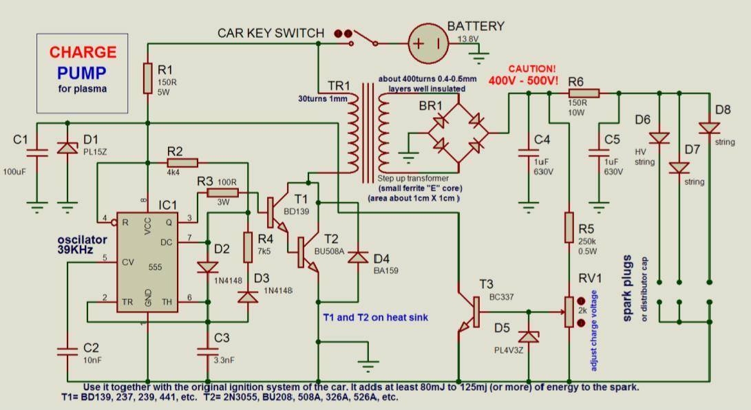

  • Hello, guys.
    In order to dissolve The Fried Inverter Club, I have a sugestion to make. It's about a charge pump to be used instead of inverter. It does the same job, and it is cheaper to make.
    I have just finished one and made some bench tests. It worked well so far. Nothing got significantly hot. I have set it to make 400V at idle and simulated points with a signal generator, as the engine would run at 6000rpm. At that speed, the voltage across the discharge capacitor lowerred a bit, to 350V. The plasma spark generated is about 1.5mm thick (the regular hv spark is 0.5mm thick).
    In order to obtain bigger sparks, one could increase the value of the discharge capacitor (e.g: 2.2uF, 4.7uf, etc). In that case the voltage could go down a little, but it should remain enough to make a strong discharge.
    I used a 25 string of 1N4007 in tests and didn't get hot.
    Hope in a day or two I will be able to mount it on my car.
    All the best!

      Your circuit is OK, but I see one problem...
      Your "fine adjustments" of output voltage, in my understanding is not "wise".
      If You take 10K adjustable (audio) resistor and put it between pin 3 and R3 (Your R3 must be about 560 Ohm) in "split" circuit (like in amplifier- audio volume potentiometer) and remove T3; D5; RV1; R5- that makes Your circuit more "flexible" and stable( because Your RV1 is working with High potential and it can start burn out, after some period of time). If You make this more simpler circuit with 10K adjustable resistor- You can start opening Your Darlington from minimal base currents and output voltage- is regulating from 0 Volts to maximal now.
      P.S. In Greg circuit, his output is only about 150 Volts DC (on Your C5).

        The circuit is using feedback to regulate the output voltage as set by the variable resistor.
        I must say, it is possible to use the reset pin of the timer to shut it down rather than T3 "shorting" the supply of the timer to ground.
        Reset pin is active low on 555, on reset Q is kept low and therefore turning off T1 and T2 until the output voltage has fallen back to the desired set output.

                    • Hello, everybody.
                      Ansis Freimanis, you are right. There are many (maybe even better) ways to command the 555. I think your's is a good one.
                      I have just used a setup that I thougt it would do. And... it did.
                      In fact, there is a most simple way to reduce the output voltage: add a few more turns to primary winding (or reduce the secondary winding by a few tens of turns and you're done. And it would not need any feedback regulation.
                      I used a transformer that I have allready wound prior to this, for another schematic. Anyway, the idea is to not exceed the capacitors voltage rated value.
                      On the RV1 we have a calculated voltage of only 3.17V, and the current that passes through it is only 1.6mA. It shouldn't burn too fast.
                      Greg, I have been waiting for your schematic for a few days. Thank you for posting it. I think it is a push-pull setup and should have a good eficiency. In fact you can calculate this after measuring the input energy consumption versus the output.
                      With the values on the schematic I posted, it manages to maintain 350V on discharge capacitor (C5) at about 6000rpm (simulated).
                      More information after mounting it on my car and runtest it.
                      Best wishes!
                      Real PEACE from the Prince of Peace: Jesus Christ!
                      • Hi, Kinetix!
                        I know- HV is always - "end of the road". Energy is much higher in HV if we compare it with 12-14V. My understanding is "no feedbacks" in HV area- reason is- if your circuit start burn out process there start another processes which are make scheme not stable and you don’t understand- why? If you make your scheme simple as possible- You’ll be the winner! Simplicity is the key to success.
