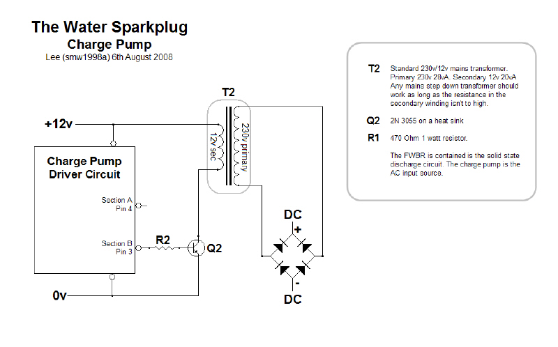

      Hi Lee
      So if pin 3 of 'B' connnected to the base of the 2N23055 then I assume that is the complete circuit in conjunction with the circuit in Video 2 ?
      When you say 'step up transformer' are you referring to the ignition coil?
      Did you also say that the circuit has a frequency limitation at approx 50hz?
      Gazza
      Hi Gazza,
      No. This is not the complete circuit. The charge pump has it's own step up transformer, one side of which is pulsed by the 2N3055 driven by the circuit I just posted. There is also a basic logic circuit that switches the carge pump circuit on and off, it also discharges the capacitor through the ignition coil.
      The only thing limiting frequency is how long it takes to charge the capacitor. 55Hz was the best stable frequency for the video. Any faster and the cap would not charge above 150v.
      Bare with me. I'm on nights this week...
      Regards Lee....

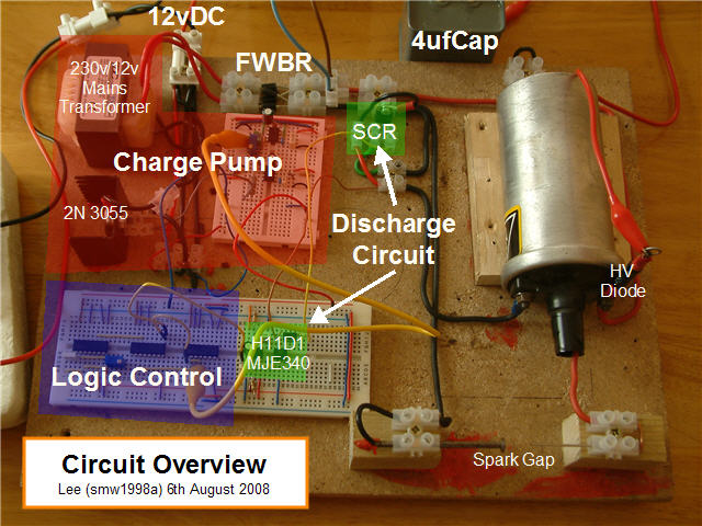

            • Charge Pump
              Hello All,
              I have attaced a circuit overview (should have done that first ) and the charge pump. I will try to add the logic module tomorrow, then the circuit will be complete, as I built and ran it.
              Regards Lee...
