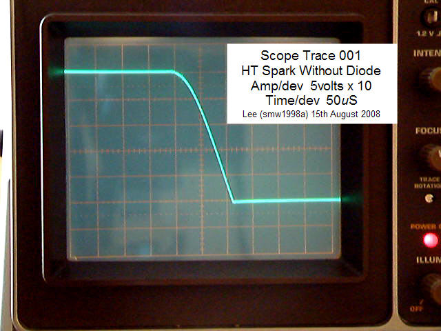

          Originally posted by smw1998a View Post
          uf capacitor. To my surprise, there was little difference in the waveform when the diode was connected to, and disconnected from, the circuit. IMO the enhanced spark effect was not the result of oscillations between the ignition coil and the capacitor.
          Looking deeper, with the scope, I set about measuring the discharge time of the capacitor. Without the HV diode, observing the standard high tension spark, the duration of the discharge from 250v was 140uu
          Hello All,
          I have attached two scope shots regarding the above observations.
          All The Best Lee...
