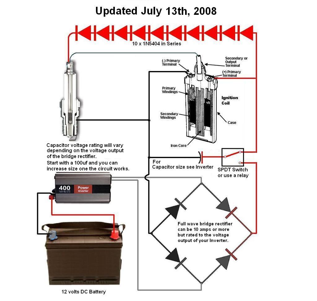

                      I may have missed it but I'd greatly appreciate it if someone could post a 'bare bones' schematic showing the configuration(s) being explored with respect to HV capacitor(s) being placed parallel the coil secondary. I seemed to have missed something. Is this in lieu of the HV diode?

                        Hi Greg, here is my first simple circuit. You don't need an inverter. Just plug the bridge in the wall ac to charge the cap. I have also found that 1N5408 diodes work better than the 1n5404. You only need about 7 if you use the 1N5408.

                          I'm running your original circuit now and it works great except I'm using Peter Lindemann's 'isolation configuration" (DPDT relay) as also shown in my videos. I'm referring to talk of achieving the same effect using a HV cap INSTEAD of the HV diode(s). If no one's actually doing this then I must have misread another post. Am I correct in assuming that the effect is ONLY realized when the HV diode(s) is fed parallel the coil secondary? That seems to be what works.
                          I almost have my DPDT mosfet switch built so I can run it isolated like with the DPDT relay.

                            It's not really parallel the secondary. It's more like a feedback loop steering the current from the primary's field collapse to the output of the secondary.

                              Oh I see, yes here: http://www.energeticforum.com/renewa...html#post26623
                              It is Jetijs that brought this information. He has a video demo of this: YouTube - Water spatk circuit using HV caps instead of the diodes
                              I don't know if anyone else tried this wet
                              Hey, I'm also working on a mosfet switch to replace the relay. I'll share once I have it working. Please share yours if it's ready.
