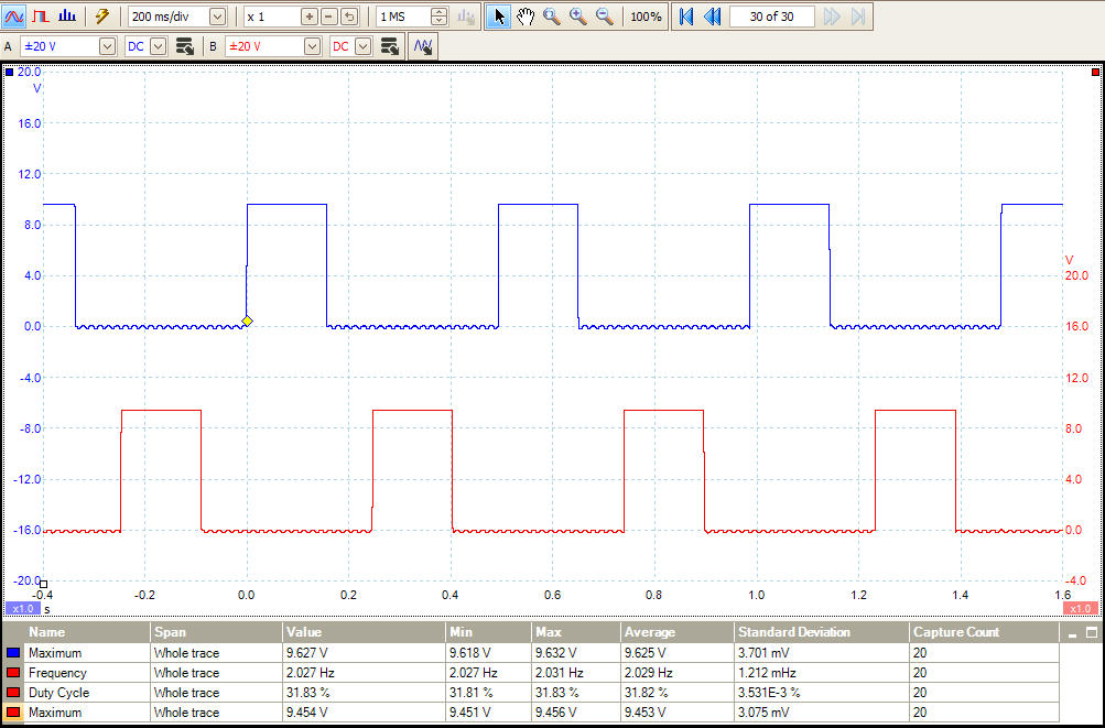

It is the same layout as JB's 2 transistor, 2 load setup except I have transistors in place of the top two diodes. I attached a scope shot of the timer output. I might be getting some kind of interference between opto's. The opto's are in series with each channel terminated by an led and a 330ohm resistor to common ground.Originally posted by Bit's-n-Bytes View PostYour right, something is not quite right. Can you post your schematic?

Alex, what kind of tranny's are in place of the diodes (NPN PNP). I posted a schematic (v2.2.3) for Vtech a few threads back. Is your setup like this? What I can deduce from your scope shots is a whole buch of square wave going on with no work being done. You also have some noise on the negative leg but that could be due to radiant energy from another source that is close by. Put your positve scope probe right on the collector of Q1 (no need to hook up the gnd on the probe) and show what that is.Originally posted by hherby View PostIt is the same layout as JB's 2 transistor, 2 load setup except I have transistors in place of the top two diodes. I attached a scope shot of the timer output. I might be getting some kind of interference between opto's. The opto's are in series with each channel terminated by an led and a 330ohm resistor to common ground.
Alex
