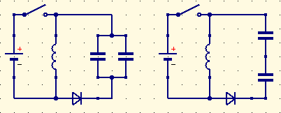

Originally posted by lamare
The switch is manually set to on, then to off again (coil saturated, spike goes to caps).
* In the parallel test the voltage on the caps went from zero to 13.7V.
* In the serial test the voltage on the caps went from zero to 32.4V (16.2V each).
Energy(serial) / Energy(parallel) = 16.2^2 / 13.7^2 = 1.4
Its definitely more efficient with the caps in series.
But why?
Is it because of Your proposed explanation with the equations, or is there other explanation?
Comments anyone?
