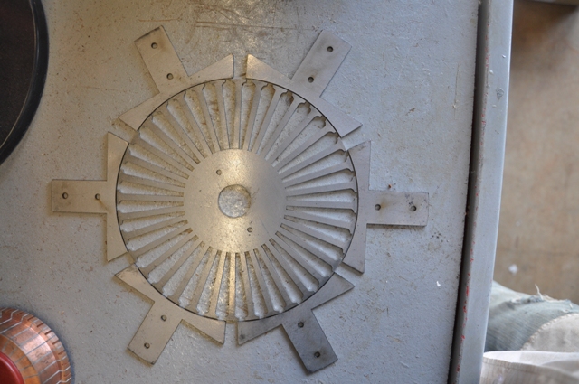

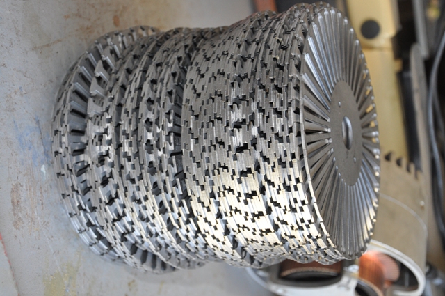

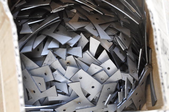

    Hello UFO, and all, my laminations have finally arrived.
    I had them lasercut, it was a lot cheaper than watercutting, over here anyway.
    Would love to show pics but attachments are full.
    I have dropbox on computer now but buggered if i can work out how to use it. Probably Kids in preschool now this s--t.
    Any way Love to all, Cornboy.
