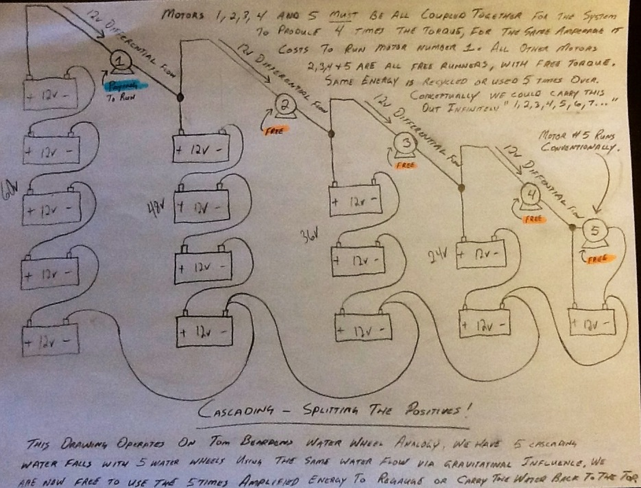

          • #35
            What is free energy???
            What is free energy??? This is free energy!
            I have proven this concept on the bench and it in fact does work, if you want energy amplification that is.
            Thomas Bearden has stated or hinted at the fact the modern electrical community has failed to realize or suppressed the knowledge that energy can be used more than once in a system, as it can neither be created or destroyed, we are free to use multiple pass techniques if we can find such a way to do it efficiently.
            -Dave Wing

                    • #40
                      @jettis,
                      Either you or Tom B. missed a point somewhere. Look at your drawing.
                      Motor 1 uses energy, on this we agree. There is 12V across it and there is a current flowing, roughly stated P (Watt) =V (Volt) I (Amp), and E (Joule) = P (Watt) t (sec).
                      Motor 2 gets its current from motor 1. Assuming they are all identical motors and identically loaded, all current from M1 goes to M2 and none is flowing into or out of the second battery stack. So we can remove this second battery stack without any change to the electrical system.
                      For the same reason all other battery stacks can be removed as they do not perform any function. Now, after having removed all redundancy, we can clearly see what is happening.
                      The 60V battery stack runs 5 12V motors in series.
                      Suppose 1 Amp flows, then 60V * 1 Amp = 60 Watts are spent from the batteries and every motor gets 12V * 1 A = 12 W. 5 motors taking 12 W, consume 5 * 12 W = 60 W.
                      Think again.
                      Ernst.

                            Hi Ernst.
                            Simple basic electrical question... When taking current flow from the 60volt side to run the motor... Which flow path is the path of least resistance? The series electric motors at 3 ohm's (1 ohm for each series motor) or the .092 ohm (.0023ohm's per battery) 48 volt battery bank?
                            -Dave Wing
                            • #44
                              Hi Dave.
                              Simple basic electrical answer...
                              If you think a 48V battery stack can be compared to a 0.092 Ohm resistor, put 1 V across it and explain why you don't see 10.87 Amp flow into it.
                              BTW, electricity does not simply follow the path of the least resistance. It follows every path in accordance with the law of Ohm.
                              Ernst.
