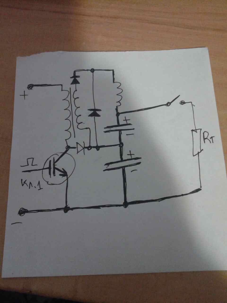

      Circuit attached. Both primary and secondary is used.

          • #80
            Interesting considering what I discussed with Ted Ewert. This makes the transformer output and the inductive kickback from a pulsed transformer travel in the same direction. Not only that, this output is pulsed into a third, not magnetically connected coil which will then have its own inductive kickback.
            ((1x2)x2) = 4
            The first capacitor is set up in an LC circuit with the secondary and the free coil.
            oops its not a LC because of the diode

              • #82
                I just ran the circuit in a simulator, Interesting but I cant get a gain out of it as it is
                Power from source = 2Kw
                Power to load = 1Kw
                The problem is all the gains run their current through the source, therefore draining it.
                This circuit is interesting but I am sure it is part of a greater circuit and we would need to know what that is to make a judgement. Merely disconnecting it from the source and providing an alternative path after the pulse does not result in any ability to use the gain.
                I will play around with it some more and see if I find anything.
                • #83
                  I have just tried the following:-
                  If the transformer were to have a 1 to 1 ratio and an inductance of 10mH with a resistance of less than an ohm.
                  The free coil was actually a motor such as a car starter motor with a resistance of 0.045 ohms and 10mH inductance
                  The capacitors were 100uF
                  The pulse was 72v 4A at 10% duty cycle 60Hz. The supply isolated from the circuit after the pulse with a diode providing a path for the inductive kickback in the position of the source.
                  The resultant current flow through the motor would approximate a saw tooth wave jumping to 72v 2A at the start for 10% duration. over the next 90% the current would taper off to zero.
                  Our input would be 72v x 4A x 0.1 x = 28.8w
                  Our motor would run at (1/2 72v) x (1/2 2A) x 60 = 36w
                  The motor would be running purely off inductive Kickback
                  All theoretical of course but we just exploited the gain.
                  If we played around with things we may be able to use the current in the pulse to power the motor too which could give is 63.8w output for a 28w input.
                  Its just a matter of recycling.
                  My conclusion is that the circuit has potential but it is not the whole story.
                  • #84
                    After more playing I am coming to the conclusion that the 2 caps could be there to remove high voltage spikes that would damage the transistor.
                    The third coil has the effect of increasing the duration of the inductive kickback at the expense of peak current.
                    The component Rt could be a rheostat.
                    Its still a very interesting circuit

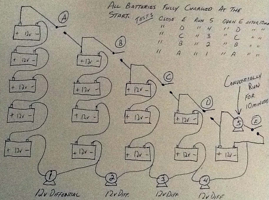

                      Hi Ernst,
                      I would like you to perform the following tests each in the sequence listed on the diagram. Carry out each run for 10 minutes use a dc load of your choice... That includes a 12 volt light bulb. I am sure you will find it interesting.
                      I do disagree with your statement "If you convert electrical energy into mechanical energy, then that energy is no longer in your electrical system, so it can not be recycled in that way." Electrical energy does not convert into mechanical energy and get used up... It simply flows through the load and can be recaptured after use. So basically an electric motor is close to a free running device if we stop the current from completing its path back to ground.
                      -Dave Wing

                        • #87
                          In the beginning of this conquest, I posted the plans to Keelynet on the "school girl motor". I know that several of you on Keelynet tried very hard to build this motor, but I said in the beginning, just build the motor the way I said to do it. In short, do not change anything until you have something working!!!! There is a learning process here for those who built this motor the way I said to do it (about ten people). I did not say to hook meters all over the machine, I just said make it run first and then move to the next step. The work on this little model was very important to get an understanding of what the energy was and how it worked, and how you would trigger it in the end. Also at the same time, Tom Bearden went out of his way to write what my process was with my permission and E-Mailed it to Jerry Decker at Keelynet. What ever happened to that paper, I don't know, but if you did not understand the paper you did not understand the motor/ energizer. All along Keelynet was given the information.
                          The US Patent office made me change the name of this device to fit into a category of motor generators. I was very lucky that they let me keep the mono pole part of it. The next fight with the Patent Office was the timing of the machine and how this device charged it's batteries, but we worked this out (with a few word changes by them).
                          I said to Jerry Decker and others in the beginning that their were three patents, even if in my own mind it was one machine that the patent office would never allow. I had already moved so far forward in the technology on the radiant energizers that I was into the solid state inverted circuit machines. The next step was to get the mechanical machines to be verified by some "expert PHD's". As it turned out all of these people were just "money suckers" and did not live up to their word even when the machine was performing in front of their own eyes. (The problem was the test equipment would not read the energy flow to the batteries even though they were charging). My "coke formula" was kept out of the patent by the Patent examiner changing words in the text . (new speak). To over come this I broke the machine into three patents, which cost my company three times the amount.
                          Bold text and underlining added to quote.

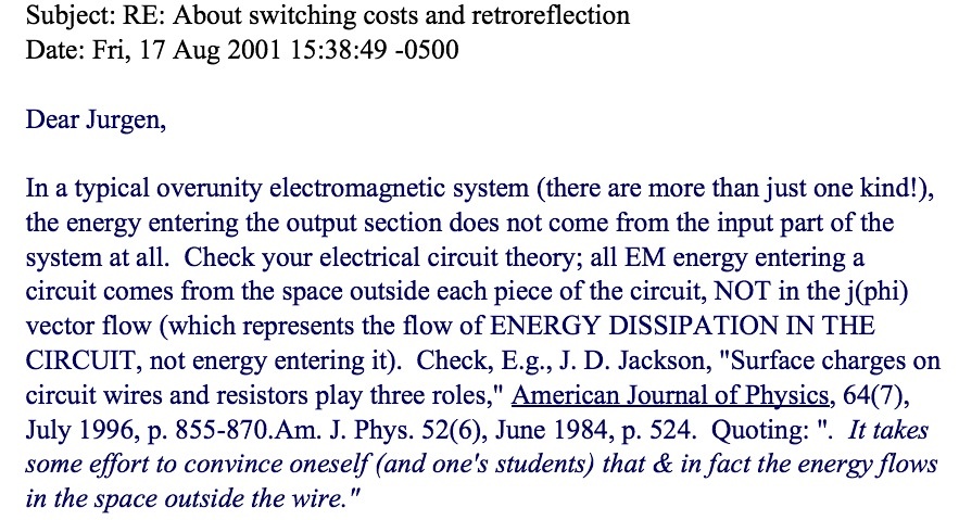

                          Taken from...I have set up this page you may review what has been going on in the past three years
                          The paper to Jerry Decker can be found here... Keely Net Mail List: Re: Negative Resistance discovered??
                          Here is a snippet, form the email to Jerry Decker from Tom Bearden...
                          Anyway, the process shows that AFTER I use energy once
                          in a component to do work, the escaping energy resulting
                          can be regathered (reconverged by retroreflection) and
                          used again. And again, and again, and again. The
                          universe does this all the time.
                          We are told that all the energy in the universe existed
                          shortly after the big bang got going originally. And every
                          joule of that originally energy has been doing joule
                          after joule of work, ever since.
                          Most researchers do not comprehend the real conservation
                          of energy law: Energy can neither be created nor destroyed.
                          And it can be "regathered" and reused, without limit. You
                          can get many joules of work from a single joule of energy,
                          IF you iteratively retroreflect and keep bringing much
                          of the energy back, over and over.
                          Unfortunately, our profs unwittingly ASSUMED one pass of
                          the energy, no multiple passes allows and no retroreflection
                          allowed, and so taught us erroneously that a joule of
                          energy could produce only one joule of work -- failing to
                          add "in a single pass work (energy scattering) process.
                          The diagram, with the test, I posted in my post previous to this one is basic but it does much the same as retroreflection it just does it at a lower frequency, once every 10 minutes... When we manually disconnect the load. The Bedini Tesla Swith or Benitez device does the same thing flip flopping back and forth and taking the AC wave between the negatives.
                          The point is energy can be reused over and over again repeatedly as it cannot be created or destroyed.
                          Does anyone know how to read the current going back to the small side battery? Was this not the main issue that the patent office would not recognize even though the small side battery was charging on one wire, the negative wire, leaving the load... this was not recognized, purposefully, by the patent examiner evaluating the patent. Because they teach different in the educational system as we all know.
                          So where does this leave us now? Are we going to concede that those who are taught that the energy used in an electric motor can be captured and reused over and over again and not just for one pass as the universities and schools have lead us to believe?
                          Perhaps some have wondered how a light build could be used instead of a electric motor and still see the same energy recaptured by the small battery? Here is a shot of a email response taken form Tom Bearden's website. I believe the energy flows from outside the wire and is diverged onto the circuit after the load scatters the energy... Link:The Tom Bearden Website
                          -Dave Wing

                              • #90
                                Originally posted by jettis View Post
                                Hi Ernst,
                                -Dave Wing
                                I will do it in my mind, if that is OK with you. Much quicker and less expensive .
                                - I close sw-E and motor 5 runs for 10 minutes consuming 1 unit of energy from the last battery.
                                - I open sw-E and close sw-D. Motor 4 runs for 10 minutes consuming 1 unit of energy from the 2-battery stack. But that is not all, at the same time we are charging the last battery also with 1 unit of energy from the 2-battery stack. So, after 10 minutes the last battery is recharged (assuming no losses) but the 2-battery stack has lost 2 units of energy. (one unit for each battery in the stack)
                                - I open sw-D and close sw-C. Motor 3 runs for 10 minutes consuming 1 unit of energy from the 2-battery stack. But that is not all, at the same time we are charging the 2-battery stack, each battery with 1 unit of energy from the 3-battery stack. So, after 10 minutes the 2-battery stack is recharged (assuming no losses) but the 3-battery stack has lost 3 units of energy. (one unit for each battery in the stack)
                                .... I guess you can fill in how it will continue and you will end up with the 5-battery stack being drained of 5 units of energy (1 unit for each battery) all other batteries are full.
                                I know what you were thinking, but you have been misled by the famous Bearden. Current alone usually is no energy, you need a current and a voltage difference.
                                I say 'usually' because there is an exception to this rule: eddie-currents.
                                You may not agree with me (yet), but that time will surely come. An electric motor is no free energy device. Wish it were that simple!
                                Ernst.
