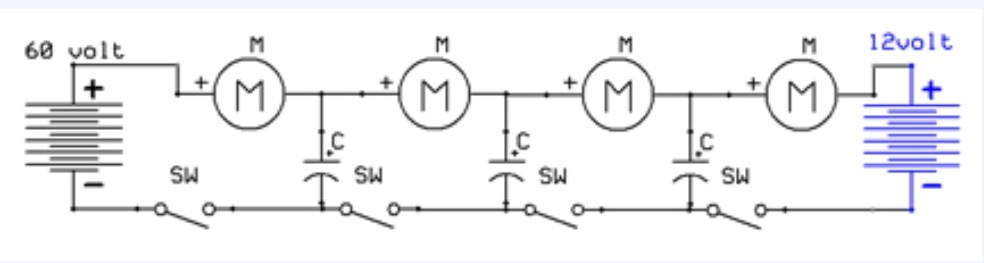

        @jettis,
        Either you or Tom B. missed a point somewhere. Look at your drawing.
        Motor 1 uses energy, on this we agree. There is 12V across it and there is a current flowing, roughly stated P (Watt) =V (Volt) I (Amp), and E (Joule) = P (Watt) t (sec).
        Motor 2 gets its current from motor 1. Assuming they are all identical motors and identically loaded, all current from M1 goes to M2 and none is flowing into or out of the second battery stack. So we can remove this second battery stack without any change to the electrical system.
        For the same reason all other battery stacks can be removed as they do not perform any function. Now, after having removed all redundancy, we can clearly see what is happening.
        The 60V battery stack runs 5 12V motors in series.
        Suppose 1 Amp flows, then 60V * 1 Amp = 60 Watts are spent from the batteries and every motor gets 12V * 1 A = 12 W. 5 motors taking 12 W, consume 5 * 12 W = 60 W.
        Think again.
        Ernst.
        What would happen if you put a switches in the system? Look at Matt's dawning he put together, that was taken from my thread. What is your opinion of that circuit... I posted it below.
        Is energy amplification or recycling possible?
        -Dave Wing
                  -Dave Wing
                  As long as the switches are open, no motor will run.
                  If you close the left most switch, M1 will very shortly run very fast (5x rated voltage).
                  The motor's impedance and the capacitor size determine how fast and how long it will run.
                  Then it will stop running when the first capacitor is charged to almost 60 V.
                  I do not know how you plan to switch but I do know this:
                  Energy can neither be created or destructed and therefore there will always be a constant amount. If you convert electrical energy into mechanical energy, then that energy is no longer in your electrical system, so it can not be recycled in that way.
                  But for the same reason, all energy can be called recycled energy.
                  If you recover the heat energy generated in the wiring and the mechanical energy then you can use that again.
                  Energy can not be "amplified" because that suggests that it would appear out of nowhere, or out of itself (as in 1 becomes 1 + 1). That simply will never happen.
                  If you want to generate energy, you require a source of energy. Next you will only generate what you obtain from your source. In other words you can only convert energy from one form into another.
                  All other schemes are illusionary.
                  Ernst.
