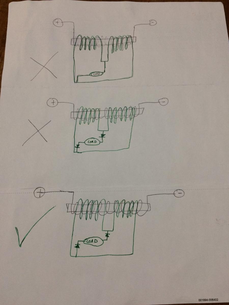

              • Hi Sky,
                Here is a quick hand draw of the circuit show what is working and what is not.
                What I want to show here is there is a way to rectify the bucking coil output so it assist the primary and reduce the input power when under load... this happen when using pulsed dc as input...
                When people know that, it is up to them to build and experiment with different way a pulsing primary can be (mechanical, solid state, same pole magnet, etc...)
                I have nothing more then to show then what I have share. I do it on this tread cause is where I firstly see it on your tread and I thank you for opening my eye on it.

                • Hi wistiti, thanks for sharing the circuit drawing.
                  It looks like the diodes are conducting, when the secondary coils induced field collapses, in the check marked drawing.
                  What i would like to see and try, is test the same thing, with the two diodes, though only using one continuous wound secondary coil, over the primary.
                  This, to see if the input decreases on load, in the same manner as the setup you are showing.
                  I think i will try it first, with the continuous wound secondary, all in same coil winding direction.
                  peace love light
