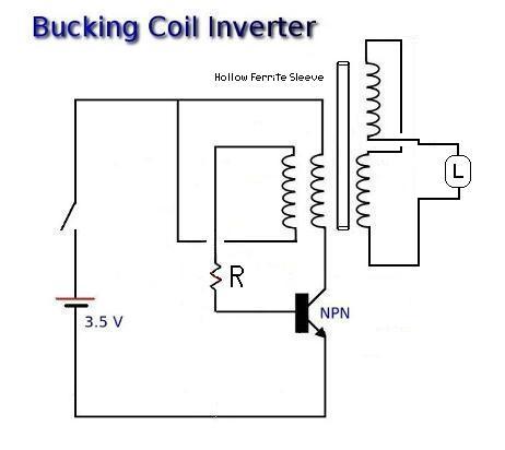

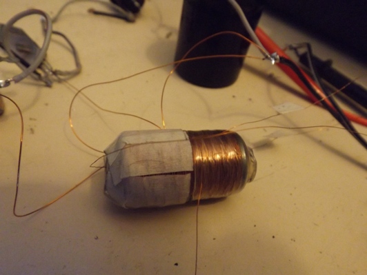

      ok.with a r and d budget of 85 cents the best i could do was 6 ferrite rings iv'e had for about 15 yrs.18mm od, 10mm id and 6mm wide,so only 36mm long, and they are held together reasonably well with just heatshrink.because there are 5 joins in the core i rubbed the faces flat with 320 wet and dry sandpaper on a perfectly flat surface,using plenty of water and turning the rings as i rubbed them in a circular motion, to try to maximize contact area between the rings.i don't know if it helps or not tho. i wound the secondaries with awg 34. then 2 half lengths of heatshrink over them. then about 20 turns bifilar of awg 27 over 1 secondary with tape to secure it, for adjustment or removal.to get the output voltage up for 240v led globes it has a turn ratio something like 1:8 between the driven primary winding, 1 of the 2 strands, and the sec it's over. i found an early model 240v led globe. it lights to about half of the brightness compared to mains power,when i adjust R to about 18 ohms. my light duty power supply sags to 1.5 v, so pic 2 was with 1.5v, .5 amp input.and the mje340 is only rated to 500 ma, so both need upgrading, but i think it should go well then. i will get a new generation led globe from bunnings next week as well.it works the same on 3 wires,but drops off with 2 wires,1 from each sec.
      also no gap between the secondary coils on this one. not sure if any of these design details are critical. maybe we can establish some guidelines after there have been more replications and results posted.
      i haven't tried it,but connecting the mains input of a switch-mode adapter,with the right output spec, to the output of these things might be an easy way to close the loop.
      cheers

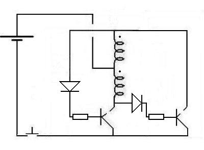

              hi sky. something like this might be worth a try. the bifilar primary flip flops n-s-n-s, providing a virtual ac input.both transistors are npn and the diodes help to protect the base emitter junctions from transients.
              *after i changed the bifilar winding on my attempt, a 1 transistor version, it would only go with no diode,but the 2 transistor scheme might need the diodes to run,not sure. so i guess try it with and without.

                Hi voltan, thanks for the circuit, though that's the one i'm using now, just without the diodes.
                That circuit is good, though some other versions of it, are more adjustable.
                Also, i don't think it can use only one primary wire with that flip flop circuit.

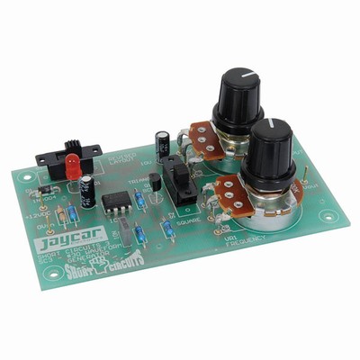

                      based on wistiti's early results, something like this wave generator kit from jaycar, on the input of a car amp that can handle 2 ohms on the output side might go well. both items on 12 volts.
                      square or triangle waves from 100-20,000 hz,probably adjustable limits.not sure if the kit outputs a signal that swings plus and minus.it may need additional biasing to drive the amp both ways.
                      nice work wistiti.
                      cheers

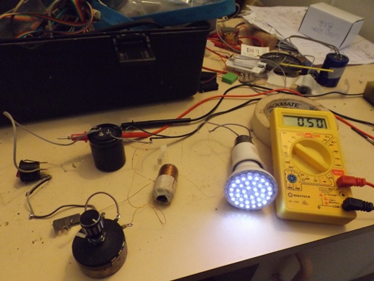

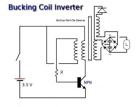

                            hi all. i rewound my primaries with about 80 turns of awg 34, so the turns ratio is more like 1:2 now. with the old lamp the best output was with the sec's connected like in pic 1.
                            then i got a new 4 watt led lamp. i couldn't get it to light until i tried a voltage doubler, maybe due to the low turns ratio and the lamps rated 220-240v. then i found the output scheme in pic 2 worked the best.
                            *i have since found the additional diode up the top improves the efficiency a bit more.
                            i might run a ground wire out the window and try that on it. still trying different connections on this.
                            cheers.

                              Good work voltan!
                              the way you connect your partned output coil is the way i have more output.
                              Try to play with the gap of your ferrite bed betwen the 2 partned coil output.
                              Ciao!
