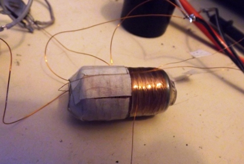

                    • It's alive!!
                      yes I know there's a lot of wires sticking out all over..... it's because I didn't wire it up in "conventional" partnered or bucking configuration.....
                      the way I do things is... well..... odd. I don't like to do things the way anyone else does. I guess I'm a "way far outside the box" kind of person.
                      [ the device self-resonates the way I have it configured - no matter what the input voltage is. even if it's 400mV. I haven't tried lower than that yet since it takes forrrrrrrevvverrrrrr to deplete an already depleted AA battery on this thing... but, while self resonating, when I measure the frequency - the caps are resonating at 7.9khz and the bulb at 18.9khz. I don't know if that means anything to me yet.... oh, and I said it's not in "conventional" partnered config, but it still is in partnered config. the bulb draws way way more when I have it hooked only to the outer or inner secondary, and isn't any brighter than it is now. however, without the caps in place, it won't self resonate, it draws more, and the bulb is dimmer in partnered config than in standard transformer config. ]
                      • Seems good!
                        Can you draw a schematic of it??

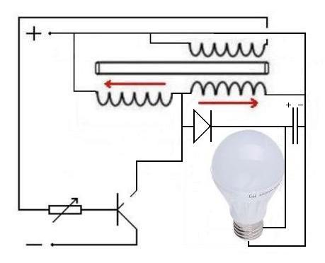

                          yeah I'll have to do it by by hand instead of on express sch tho in order to represent it all the way I want so it looks right and so I can add all the weird little details, so I probably won't be able to get it up until tomorrow sometime.
                          • Wistiti -
                            Here ya go. Sorry for the sloppiness. I just didn't believe that ExpressSCH could depict my experimental device the way I wanted to depict it - so that the basic concept of what I did could be easily understood and reproduced in whatever manner/device you choose to use it in.
                            (The 1/4" x 1/4" or 6mm x 6mm grid actually only applies to the core itself. I depicted the ferrite at the actual size, and in the bottom right corner, I traced the profile of one half directly to the page)
                            The one thing I am unsure of on page two of my diagrams, is what part of the LED bulb is anode/cathode. Can anyone clear this up for me? I'm under the assumption that the case of the base of the flashlight LED bulb is the Cathode (-) and the point at the bottom of the base is the Anode (+) since on regular lightbulbs the Negative is the screw part of the base. I'm fairly certain that I have it correct, but I just want someone to verify it for me. Thanks
                            -Brian

                            • Thank you Brian!
                              It seem to be a nice transfo. Did you mesure in/out power?
                              Does it react like our previous device (bucking inverter) less amp draw at the input when a load is connect on the output?
