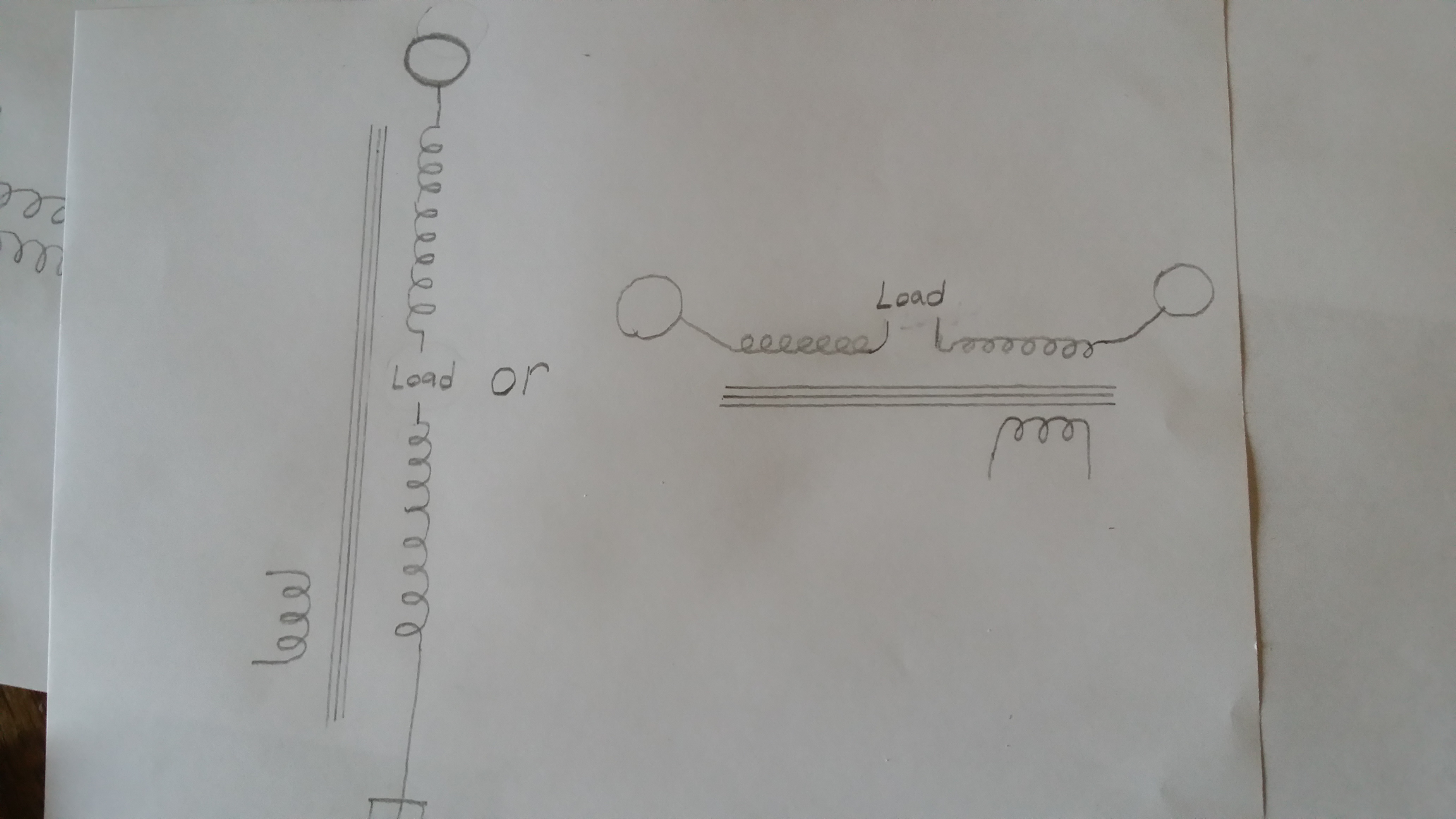

    Here is a sketch of what I was thinking.

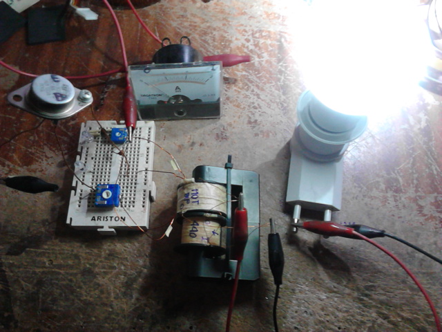

        hello all
        I made a replication as close as I could.
        Core: 5 ferrite beads
        secondary: each 174 turns / 26 AWG / total 348 turns
        Primary: bifilar 48 turns x2 / 22 AWG
        power supply fixed at 3.5 V DC
        Resistor: 1K variable / graduated at 640 ohm
        Transistor: 2N3055
        Load: LED lamp 220-240 V / 7W / 50-60Hz
        Best apparent luminosity - input ratio: 0.3 Amp / frequency unknown
        The camera do not show the real amount of light emitted by the lamp.
        Compared with normal input from grid it is quite dim.
        Anyway much fun, will try variations
        Thanks Sky Watcher

            Hi Sky
            My setup indeed has the secondary winded in Bucking mode. same as you show in your posts. The primary winded over one of the paired secondary. same schematic as yours, except the resistor is variable 1K. (and the led lamp 7W 220V)
            There is a sweet spot playing with resistance were the input amps decrease, and the light
            increases. (I guess related to the particular number of turns in windings)
            [B]Sorry I forgot to mention this most significant aspect, YES there is a slight reduction in input amperage when loaded. (my PS is regulated at 3,5 volts).[/B]
