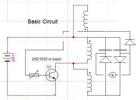

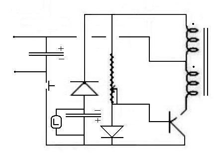

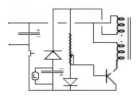

    • hi sky. nice work.i will try that today. i been playing with the circuit below. pic 1 for same wound sec's. pic 2 for counterwound sec's it powers the led lamp and returns some back to the source.lower most diode is a delete option. i use a fr302 and a 1n5189 in series. together they measure slightly higher forward v drop than the b-e junction. the circuit may not oscillate with less v drop in the diode/s than b-e.
      pic 3 runs. i'm still trying different connections on it.
