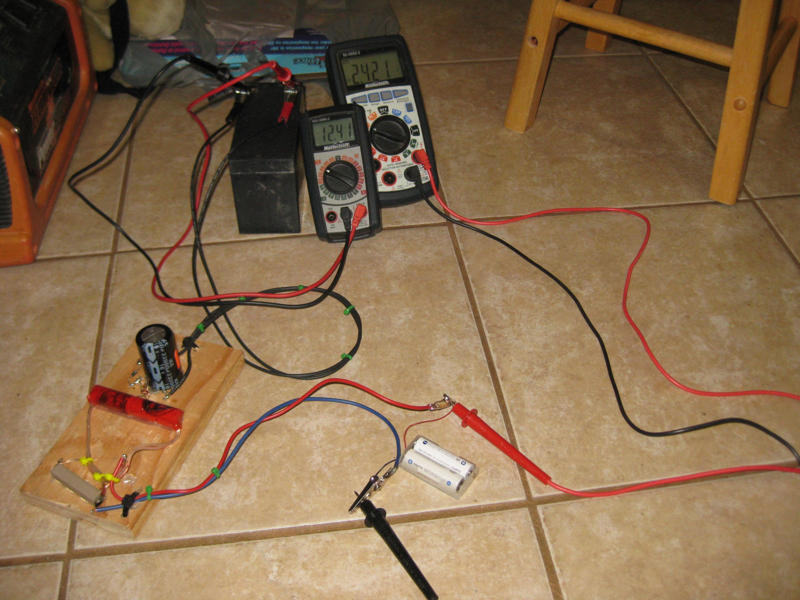

      • Hi Sky and folks!
        Today i have some spare time so i decide to play a bit with these POC (Partenered Output Coil) The bucking coil as name by EMjunky.
        After reading some old post, i decide to test what some folks here said about a kind of capacitance may happen between the primary coil and the POC . I mean here the distance between the primary and secondary .
        I also tough about what some people think then the magnetic field must be better under (inside) the primary than over...
        So i decide to re-do the first module i have done on the top of this tread with that concept in mind.
        I use an 8 cm ferrite rod i have found in a old radio. I wrap the POC on it with 20 AWG magnet wire (4cm each coil). I wrap a 18AWG speaker wire over it (the thick insulation may do the job for the capacitance...) I secure the outside with tape.
        The primary is drive by a blocking oscilator (joulethief). The transistor is an 2n222, the resistor is 1350 ohms.
        The output (POC) is conect the midle together and the end together. The both midle go to one ac of a homemade 1n4148 bridge rectifier and both end of the POC go to the other ac of the bridge.
        The - and + output go to a 16vdc 22000uf cap. I also use a 1n4007 blocking diode on the + of the cap for the final output.
        I decide to use it for charge battery.
        For now the result is quite interesting...
        My source battery is 2xaa 1.2vdc 1900mah nimh in serie. My charging battery is 12vdc 7.2ah lead acid.
        At the start (battery not connected) my reading is: Source--2.506vdc Charge--12.30vdc
        Now (3 hours later) my reading UNDER LOAD is: Source--2.406vdc Charge--12.43vdc
        I will let it run till tomorow and let you know about the result...
        It is slow; but it seem efficient!
        Happy holiday for everyone!
        • Ok after 5 run hours, i disconect the circuit cause my aa bat was deplete and i dont want to scrap them... I let everything rest for an hour and here is my reading.
          source-- 2.411vdc Charge-- 12.40vdc

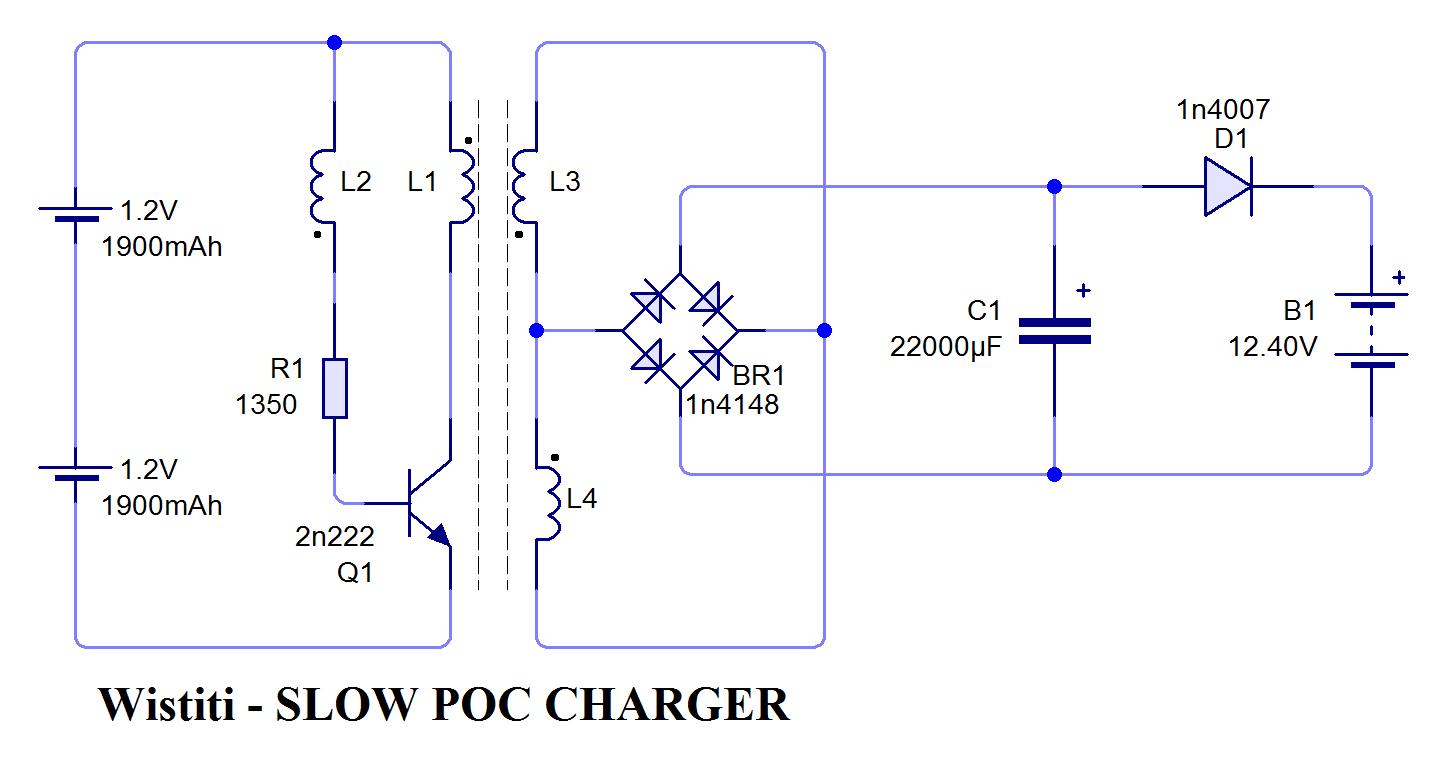

          • Just in case someone whant to replicate; here is the skematic!
            • Hi wistiti, thanks for sharing.
              Is the 18 gauge speaker wire covering both partnered coils, because the diagram looks like it's over just one partner coil, thanks.
              I'm going to make one, i'll probably use 18 gauge magnet wire or 24 gauge and maybe 18 or 16 gauge lamp cord.
              peace love light
              • Hi Sky!
                The bifilar cover all over the 2 POC wire. I use speaker wire for the bifi for their thick insulation. (Create a gap between the primary and secondary is the idea here) So if you just have magnet wire under hand place something (tape, paper, etc...) between the 2 set of coil. Also use biger gage for the bifi than the POC to have much more turn on the bucking secondary than the bifi primary. For example when i connect my circuit on a single 1.5vdc aa battery with no load i can read 140vdc at the output. But of corse with few miliamps...
