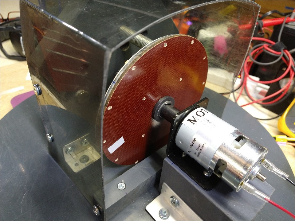

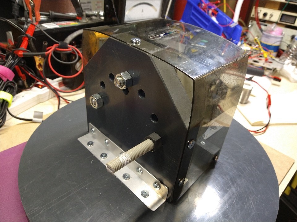

I've been working on my set-up. Had it functional to do the tests for a week or so. Got a Lexan scatter shield. Done 8kRPM. Just have 4 magnets on rotor so would like to do 15k. But thought I'd better get some data before going faster just in case. Ran some base data, no cores, one core, then two, then with the anticogging magnet and cores. I intend to plot the data.
Good to see you about to run some tests.

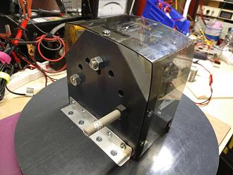

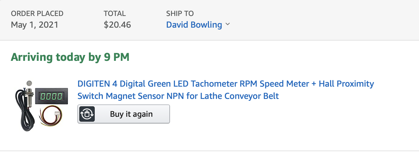

I will do testing when I finally get the tachometer. According to Amazon, it will be here by 9:00 PM tomorrow.
First I am going to test the output of a single coil with an iron core to see how many volts and amps it puts out running at a specific RPM with the new rotor. I am shooting for 3,000 RPM, which is the rated speed of the motor on 36 volts. I am also going to look at the RPM required for "NEUTRAL" operation of the core with each of the possible wiring configurations possible with a 12 strand coil as well as the output in voltage and amps of each arrangement at "neutral".

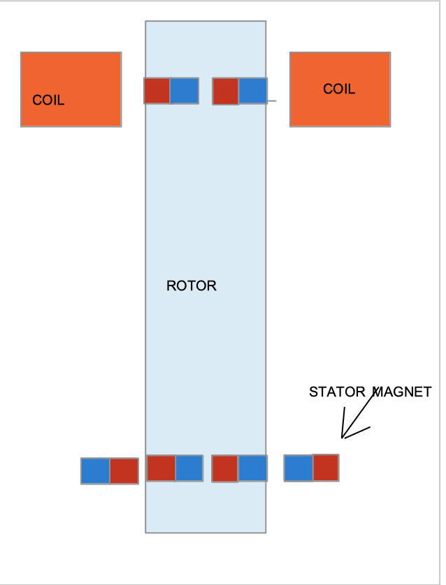

Turion,
All I'm asking is this, except using cores instead of coils as you show in the diagram.
Just run it at steady speed and back the stator magnets away showing effect on the motor current. You do it, and I'll do it. You go first. Afraid?Originally posted by Turion View PostVoltan,
Same principle at work as in my generator, which I show below. It's what I have been saying for YEARS now. What you have shown is EXACTLY the 7th grade science experiment I asked bystander to do that he hasn't got around to yet. It proves what I have been saying is true. I just configured it differently after many small builds. But I started with EXACTLY the configuration you show. Then I moved to a motor coil as well as a generator coil so I didn't have a motor turning it. And finally I went to the configuration shown below, where the rotor is turned by a small motor and I have multiple coils and multiple sets of magnets on the stator. One set of magnets for each coil pair. An odd number of coils and an even number of magnets on the rotor. If you watch my videos I explain why. I already know it works, so have fun.
I see no difference between running it with the rotor magnets backed off to begin with so the amp draw of the prime mover can be measured and the RPM can be measured and THEN slowly bringing the opposition magnets into position so that the prime mover speeds up and the amp draw goes down. This I have done HUNDREDS OF TIMES over that last 5 years. HUNDREDS. Every time I have moved my machine I have had to retract all the opposition magnets and retune it. This means that I do it for EACH of the 12 coils EVERY TIME it is moved. I have moved the current machine at least a dozen times, back and forth between my house and Greyland's shop. SO MANY TIMES that I finally just LEFT it at his place. And there were many, many, many versions of the machine before that. You want me to waste all my time retuning the machine just to DETUNE IT? I KNOW the result. Why is doing it "your way" so important? You want to do it "your way" you go right ahead. I may do it when I have the time, since you are only talking about ONE coil, but not until my tach gets here and I get it set up. By the way, as I have said many times before, the effect on the prime mover of one coil is "X" but the effect of 2 coils on the prime mover is MORE than 2 "X". There is a curve, and each coil added has a greater effect on the prime mover than the previous coil did. One coil BARELY affects the prime mover. Four coils can bring it to a grinding halt. Depends on the prime mover. SO the more coils you have on the machine the more obvious the NEED for magnetic neutralization is.
Oh, and remember, when I say coil, it means there is a CORE right in the middle of it. You seem to not be able to remember that.
I'm not afraid to do this experiment. I have done it hundreds of times. I know what the result is. You are the one who needs to learn a thing or two. DO you REALLY believe I could run my machine with all 12 coils in place on an amp draw of only 9 amps by the prime mover if magnetic neutralization DIDN'T do what I claim? REALLY? If so, you know NOTHING about the attraction of magnets to core material. Nothing at all. It's about time you built something and learned a thing or two that others have learned from ACTUALLY BUILDING and observing. Because it's not what you THINK will happen that matters, or what you READ IN A BOOK OR ON WIKIPEDIA will happen that matters. It's what ACTUALLY HAPPENS on there bench that matters. OBSERVED reactions and MEASURED reactions. Good thing you don't think the earth is flat or we'd all fall off the edge.
