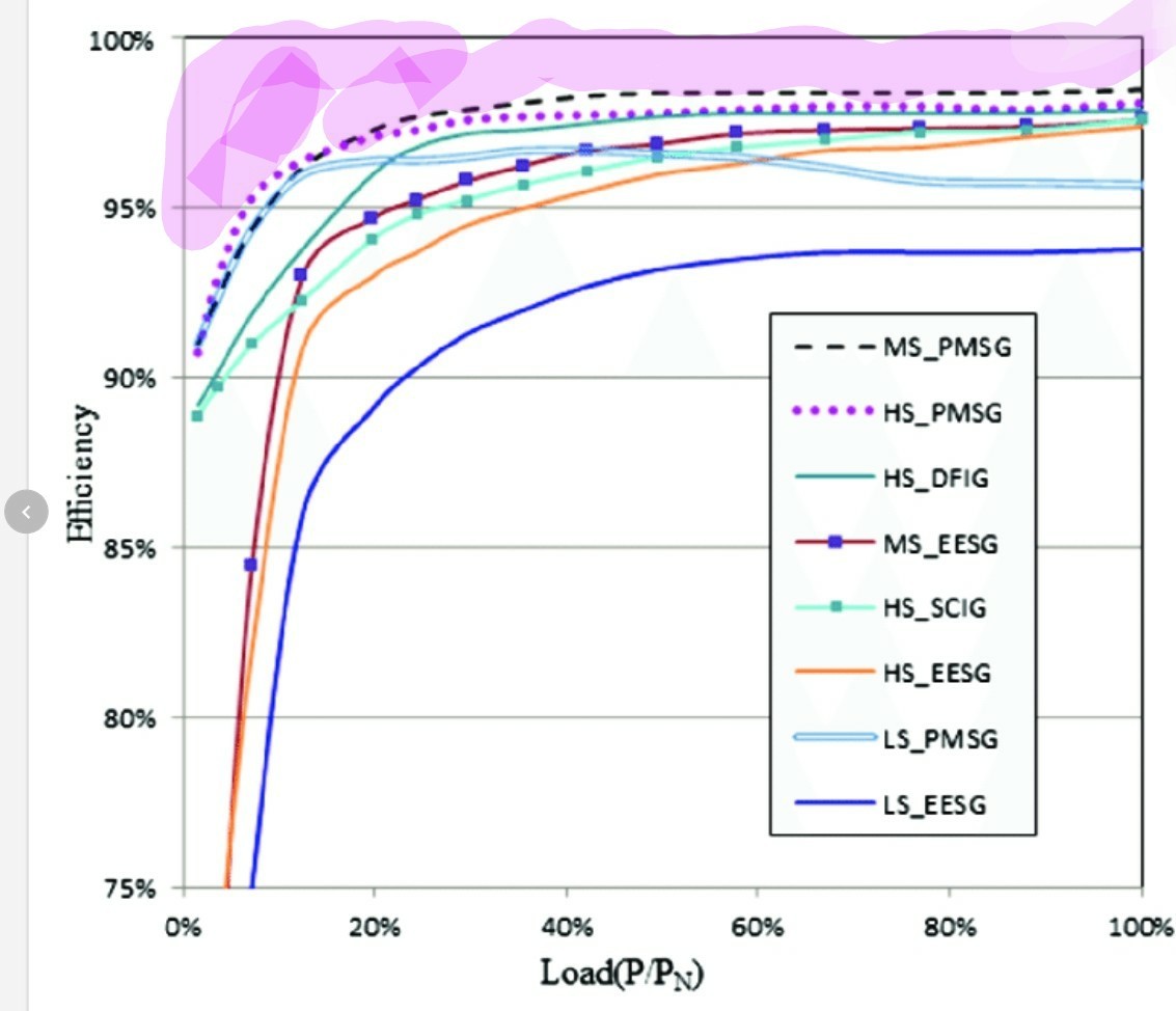

Here's an idea about the brutal facts.
I've tried to colour in purple the area you must be in to achieve enhanced generator performance.
You will see electrically excited gen. comes out the worst of the bunch. That's a definite no for the small electromagnets.
If you want to prove acceleration under load you've got to do it in the purple, otherwise you're just altering the efficiency of the system.
The easy winner is the medium speed permanent magnet synchronous generator, that's the one you've got to beat!
