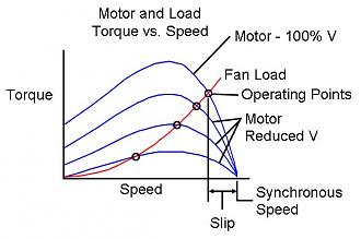

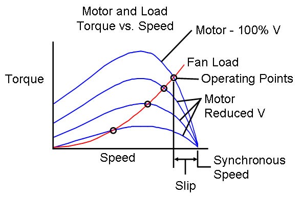

Thanks for posting data. Very nice to see. Load bulb # vs RPM trend is typical of increasing load applied to an induction motor. Unfortunate that input to the induction motor wasn't recorded for each point. Could they possibly put a killawatt meter on the outlet to measure induction motor amps, watts, PF, etc?
The proper method for speed control of an induction motor is frequency control. A variac will slow down the induction motor by reducing its breakdown torque such that slip increases drastically. In other words, a variac will lower loaded RPM but cause motor to heat rapidly and stall at a much reduced load.

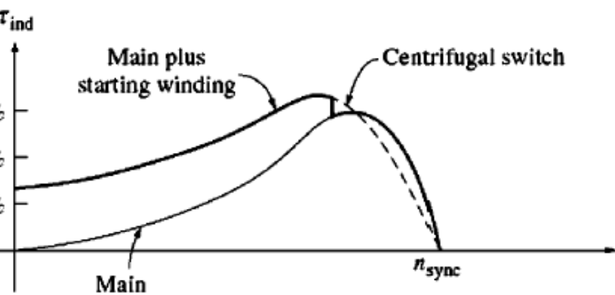

I noticed the increasing 'drop' in RPM when I first examined the data. It curve fits the classic induction speed/load curve well. I'll post an image of a typical characteristic curve.

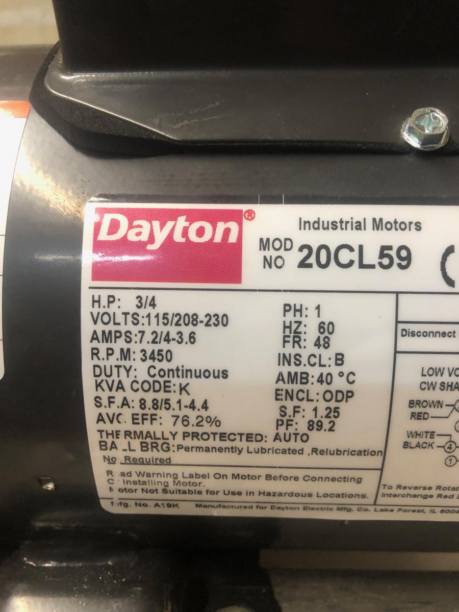

Also of interest considering the full load rating is 3450 RPM at 7.2 Amps, the starting RPM is 3460. You mentioned 7 Amps. That would indicate your freewheeling load, no bulbs switched on, is just shy of 3/4 hp.
Synchronous speed is 3600 RPM.
The load curve isn't a straight line. It is slightly curved with increasing downward curvature until you reach the knee, called 'breakdown torque', and once it reaches that point, the motor stalls and current skyrockets, tripping the klickson protector.
The kill-a-watt meter would confirm this.
Image showing shape of induction motor speed torque characteristic.
