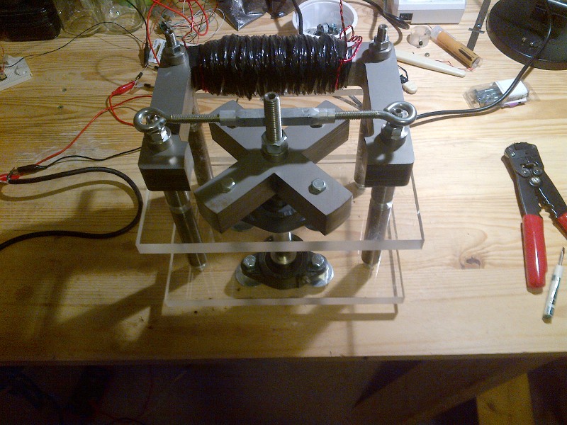

    Attached is a picture of my RAM but I'm having a problem. My coil is wound with 245 turns of two pair Litz wire 18 AWG. The resistance of the coil is 1.9 Ohms. I assumed if I connect it to a 12VDC power source it would draw about 6 Amps but in fact it draws around 17 Amps.
    Can anyone shed some light as to why?

    • Hi Vince,
      unfortunately it is only you who can this figure out, (you can do hands-on tests and visual inspectations... LOL)
      The 17A current indicates 0.7 Ohm coil resistance instead of the 1.9 Ohm. Maybe try to move the wire connections up and down, and also sideways when your Ohm meter is hooked up, there must be somewhere a short between the turns.
      I see the cross-spanner keeping the prongs distance for the air gap, is it magnetisable steel? sorry for this question...
      Gyula
      • Try touching the leads of your ohm meter together and read the ohms. Now record that number and then measure your coil. Subtract the the first number from the second and that will be a closer reading ( although still not very accurate ). On a harbor freight meter the first reading will usually be about .8 ohms.
        Garry

          You were right on! When I touched the DMM probes together I measured 1.2 Ohms! Here I was thinking it was a decent meter. No wonder my reading was wonky. I was able to measure the actual resistance by putting a constant 100mA load on the coil and measured the voltage drop across it to determine the resistance. It turned out to be 0.41 Ohms.
          Many Thanks!
