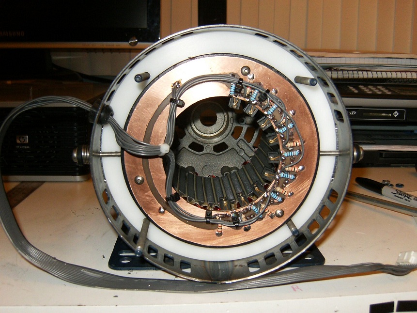

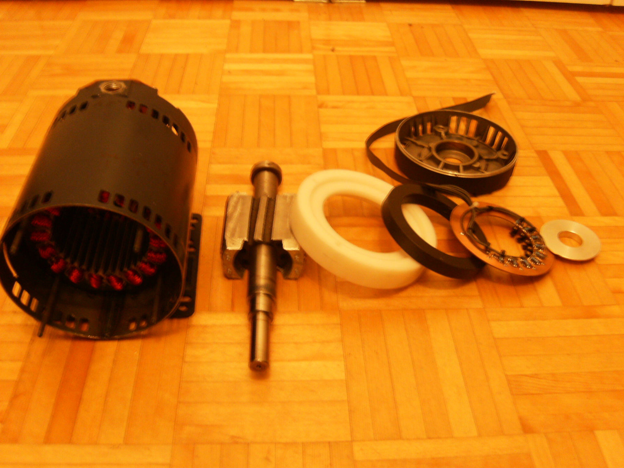

I have some to247 mosfets rated 40 amps and 300 volts with fast response time and only .040 ohms on resistance that I will try.
The motor runs at 2200 rpm when loaded.
My next version of this motor will be equipped with a modified version of the timing device I showed on post #1472 . It will be easier to adjust the width of the pulse with it. The sensors will have to be 120 degrees apart but the result will be the same.
The inductance of the coils varies with the position of the rotor from 1.5 to 4 millihenry.
And by the way, I studied and experimented electronics a lot but as for magnetism, I learn along the way with people like you. So do not assume that I know things .
Thank you again for your input.
Robert
