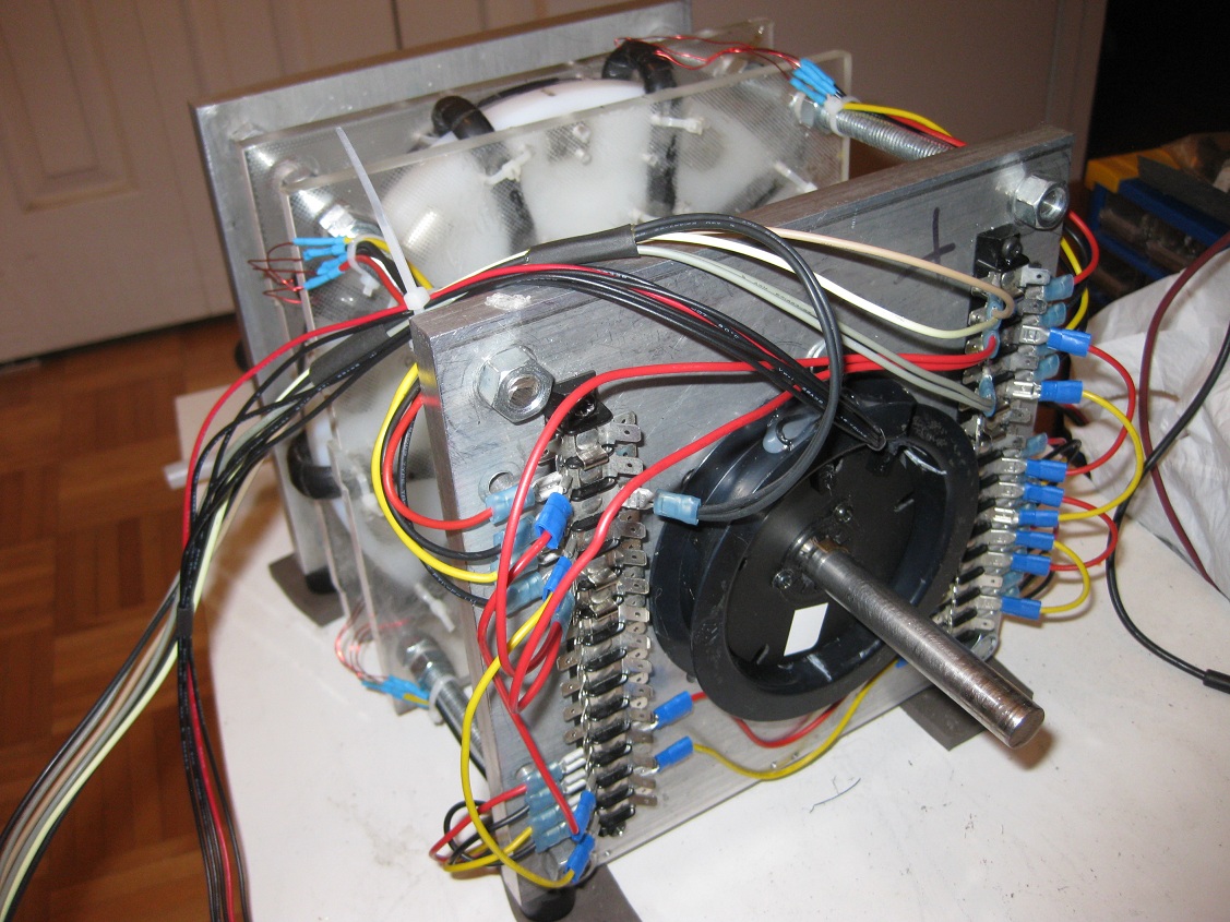

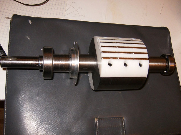

As Peter Lindemann suggested, I'm having my rotor modified. The actual gap
was .012 inch and the goal is to get as close to .002 as possible. I will use the same shaft for now (short on money).
The motor was already quite strong so I expect it to be very very strong after this modification.
I also tryed something crazy: I connected the recuperation diodes to the center tap of a variac, connecting one end of the variac to the motor and the other to the cap bank. I then ran the motor at 200 volt and with the proper adjustment the motor was drawing 800ma and was still very strong.
Anyway here's my new circuit with pulse width control which should make the motor more efficient. I include the board top layout .
Thanks for reading.
Robert
