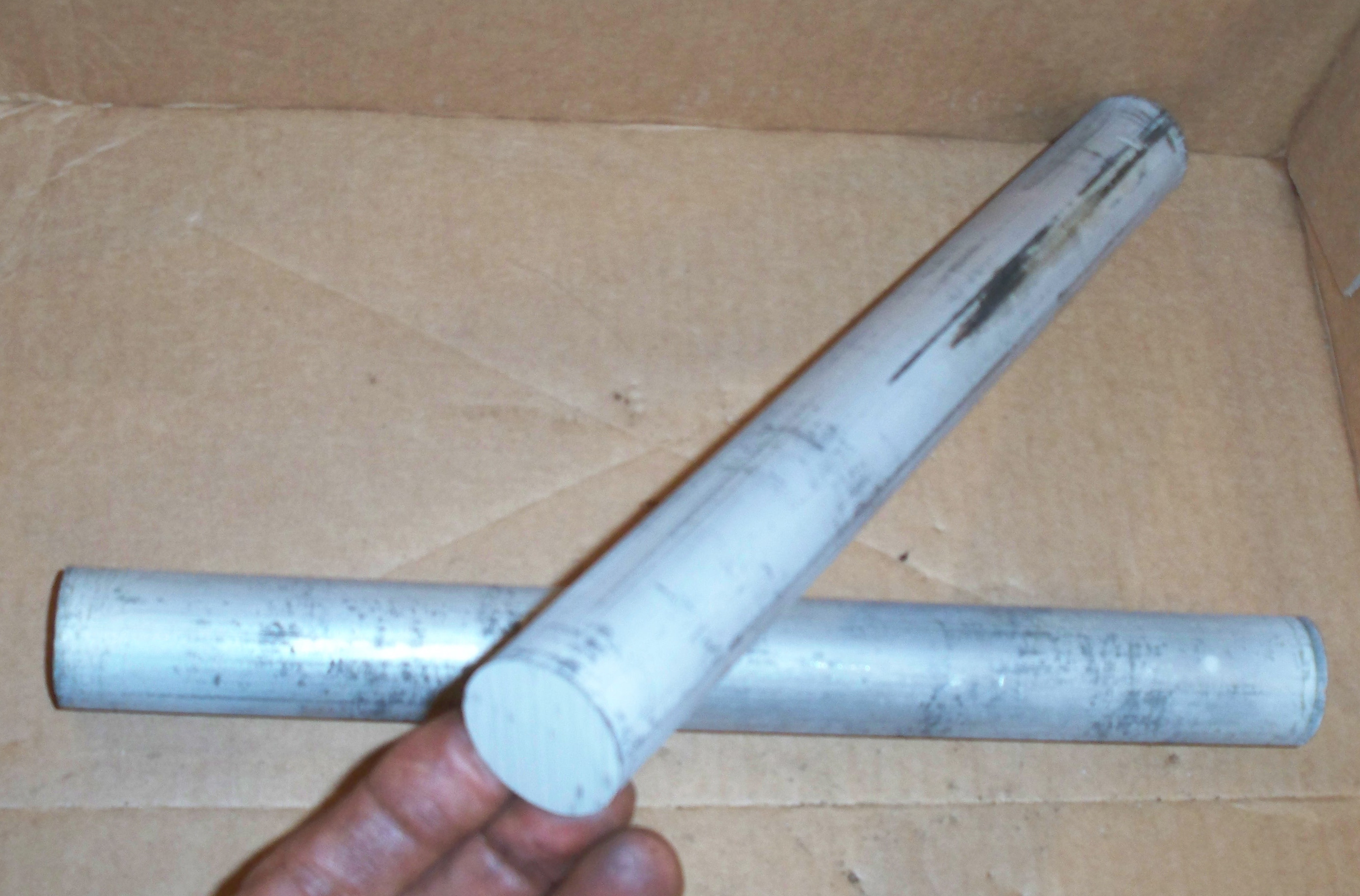

        Got My Magnesium rods today. 1" X 1' - 2 of them 20 more on order
        Will tap a brass screw into end for a lead.

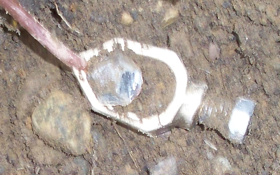

          First pic is of the connector to #6 ground wire about 4' away from 1st hole

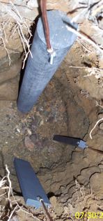

          Second is a pic of the elements in the 1st hole

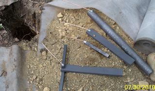

          Third pic is of elaments
          (The "T" is made up because I only have 2 of the big rods. Same length and aprox surface area. It will be in the middle hole.)
          Second hole 1/2 way there and 3rd is plotted
          1st hole is filled in with elements in place (Roger talked me into putting a 4th 3/4 sq x 8" high in the hole on the south side so we can see if depth has any effect. I'd say the bottom of it is at 1' deep)

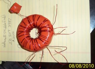

                      I have some various size LED's and have wound a JT 2.5"dia 1/2" thick
                      Sec is 3 layers about 100 turns ea. of 26 gage.
                      2 ea. - Pri wound on top 1-10 winds 2nd-20 winds, both 22 gage.
                      need to hook it up this week and see what I can get to shineee
                      FrznWtr
                      Ps I do have a bike wheel SSG and was thinking Nathen Stubblefield Coil to run it
                      But if I could get the EB to do it that would be RAD - Good Goal
