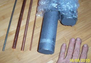

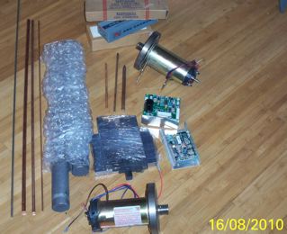

                    • Went out to dig around in the back.
                      No, no results yet just plot-in and plan-en
                      When I came back in there was my UPS "carbon delivery".
                      Wanted to share
                      (Think Copper is expensive)
                      I throught I'd throw my treadmill motors and PWM's I'll use to make a cotton winder out also.
                      They are about 1 3/4 hp ea. Overkill I think But speed controllable.
                      I also placed my copper rods and arc carbon's
                      and a Non-magnetic stainless rod I'll use for testing.
                      I intend to get some aluminum also and I have 1" X 1' magnesium Rod's coming.

                            Your pic looks like lasersaber's carbon. What a monster that is!

                              Got the big (Carbon) ones to consider a size to amp relation ship,
                              Carbons = 3/4"sq x 1' as compared to the 2"dia x 2' Both mg rods will be 1"dia x 1'
