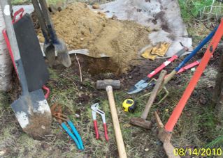

                    • EB Data
                      Well its been awhile - sorry
                      August 8 2010 4:30pm AST (Alaska Standard Time)
                      Last 30 days a week ago broke all records for rainfall here in my area.
                      I gotta work in it - so I will not be out in it if I don't have to.
                      This perhaps is the reason for the slight reduction from last voltage reading
                      3 - Holes (#1 & #2 with 4 ea and #3 with 3 Carbon rods)
                      All Current readings after 3min as initial reading drops right away
                      1st hole 2'7" deep to North has 4 carbon rods in it. All separated by 1' center fill. (Depth corrected as wires stick up 5")
                      A= 2" diameter x 2' to west at bottom of hole.
                      B= 3/4" Squair x 8" to north at bottom of hole.
                      C= 1/2" x 2" x 15" to east at bottom of hole.
                      D= 3/4" Squair x 8" to south at top of hole, Bottom of rod aprox. 1'
                      E= an 8' x 5/8" Ground rod driven flush 3' to west of 1st hole. (Lots of work this one)
                      I had the A-carbon shorted to the 65' magnesium and
                      the D-carbon to the 5' Mg
                      I hooked the DMM leads to the wire before disconnection.
                      A at disconnect time read 1.14V - Two minutes later read 1.317
                      D at disconnect time read 1.14V and 1.264
                      After a 10min rest with no connection
                      A read 1.49V
                      D read 1.29V
                      (No conclusion here just data)

                      PS Proper Digging Implements
