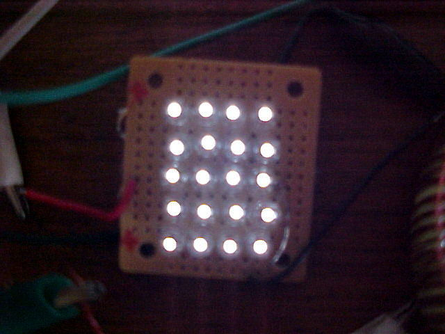

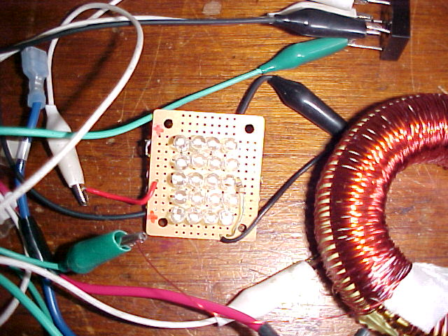

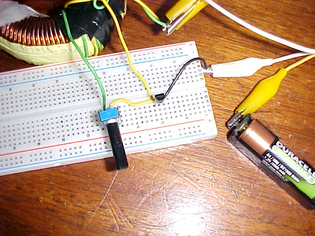

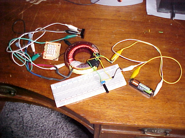

I have even sprayed uncoated magnets with cheap paint to help keep them from chipping work's pretty well.I have ran a JT with 6 and 6 removed led from e/c ran 64 leds in series on the secondary not real bright but a low drain on the 1.5 volt AA battery I will have to run a test to see how long it will run. Not sure of how many winds on the secondary lost count
.when I get time I will try around 400 to 750 and try the modified cfl.
