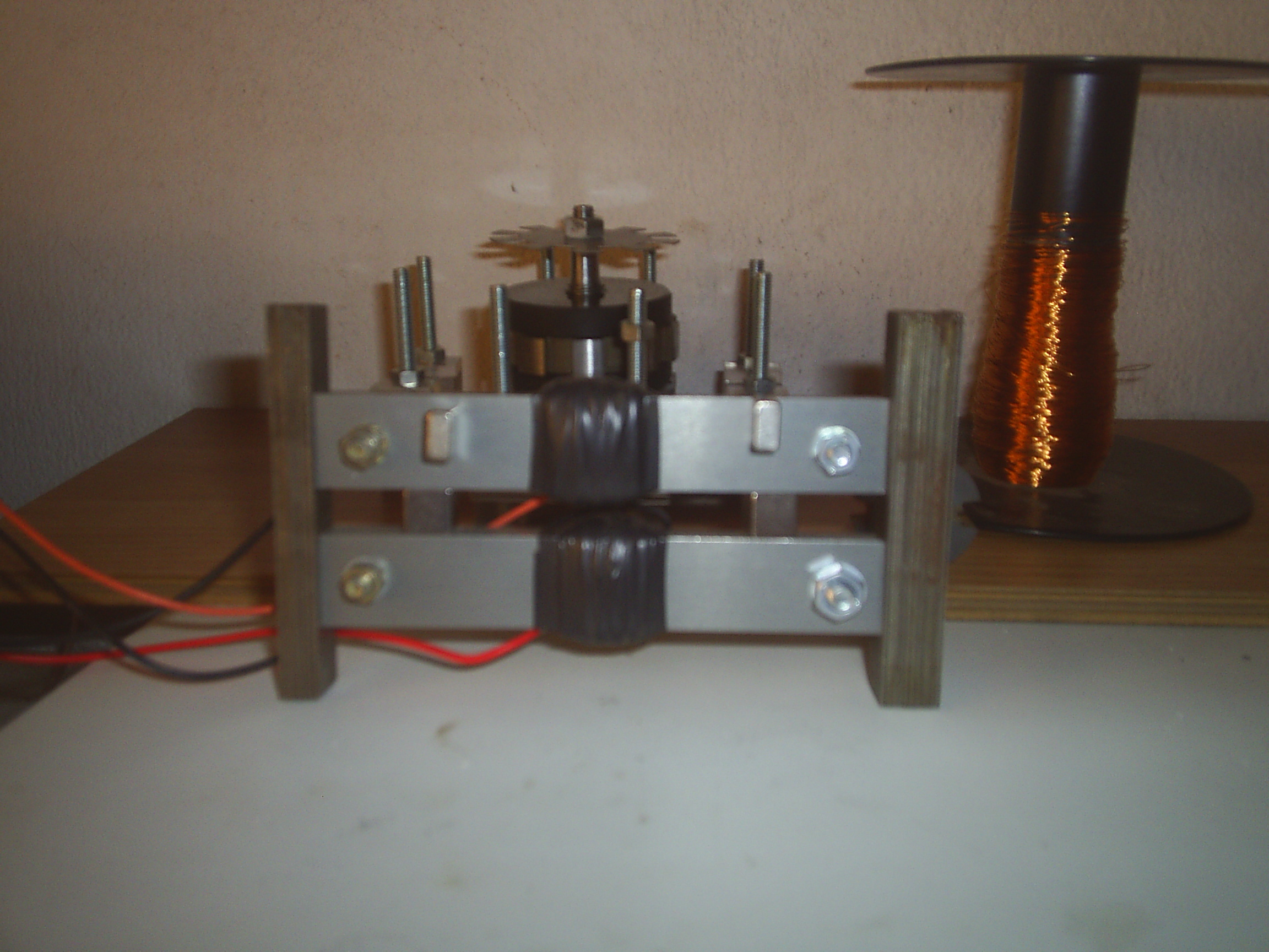

          • Glotuc , as I say on Jetijs trade you mast use second Laminate bar on Parallel path device because you mast provide flux path when divert flux. In thet case power consumption is much less. My setup use only 3v and 0,25A.
            • Yes Luc, zhorv324 is right.
              Can you do that experiment again and see what the current consumption is if the upper part of your setup has a closed path? Because now when you are redirecting the flux, you are trying to push it through the open end, through the air and air is a great resistance for magnetic field. Of course this increases the current consumption. That is why I was surprised by your current consumption, because there is a video on peswiki where this guy can easily redirect all the flux using only a one small 3v battery.
              • Holly Smokes zhorv324 and Jetijs you're right!!! I wasn't thinking.
                I'll redo the tests and post the results.

                • Okay, here are the correct results
                  It is just like you said. There is an ideal voltage, go past it and the flux comes back.
                  My ideal voltage is 2.75 volts @ 0.08ma = 0.22 Watts
                  I think this is a better score
                  Give me your comments.
                  Thanks for your help.
                  Luc
                  • Thats awesome
                    This is very encouraging news for me, because it bothered me for a long time. Now I know that the flux can be redirected with a current that small.
                    Great.
                    Thank you for the test
                    Jetijs
