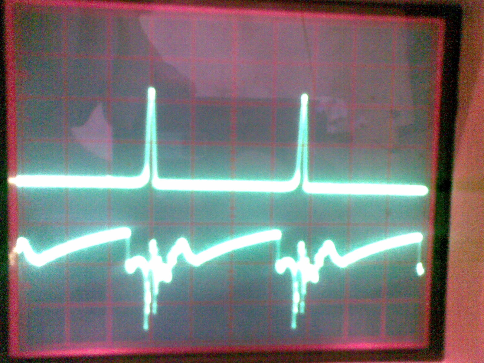

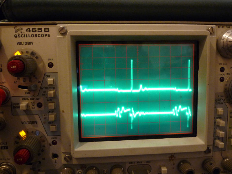

                  • test #10 - report
                    Hi all.
                    test #10 results and questions:
                    1. COP = 0.54, again failure to see gain.

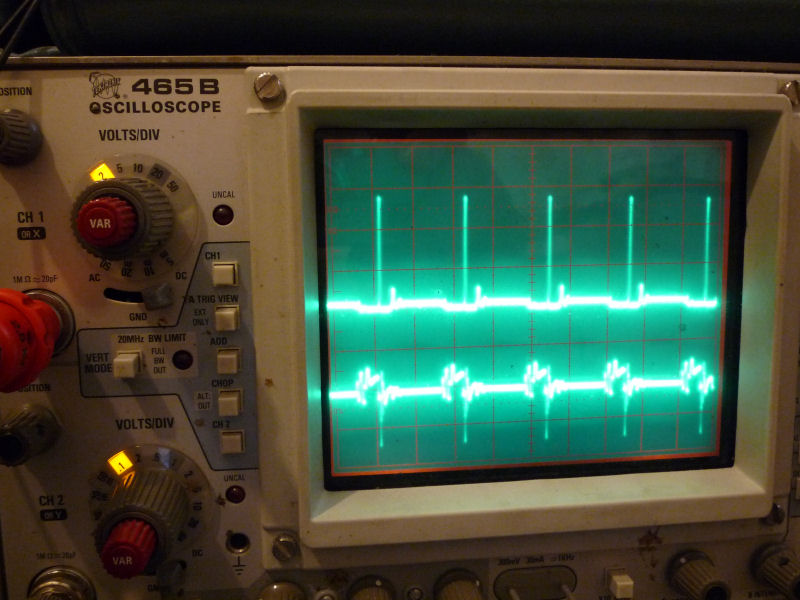

                    2. Green LED lighted ! i found that my led was broken so i replaced them both to 2x5mm leds, real green and red this time, and they both lighted when the parallel resistor (i use 500R pot.) was > 1 ohm (the more resistance - more light).
                    3. waveforms - better this time (see attached images). although the freq. was only 90khz. i'de better check the COP when using a higher freq, but i did not find such in this test.
                    4. the test lasted this time about 5 hours. but i was limited by the 555 battery (9v 200mah) capacity - i used 180mah in 5h = 36ma (10ma when no load connected). its a big improvment in the 555 circuit power consumption (Thanks to Harvey) but its still limited (ses next paragraph - related)
                    4. when i connected the 555 circuit to the 12v battery instead of my regular 9v one (as Harvey showed in previous posts), i could not reach any resonance in all pot. range ! the freq. remained always on the original 2.4khz.
                    is there any way to change that ?
                    Gad

                      • Thanks Harvey for your suggestions.
                        about the waveforms (4b) - could you tell me exactly what was not so good according to my attached images ? the upper section reprsents the load probe (500-600v) , which i think goes up and down "cleanly" and exactly what you've said. doesn't it ?
                        • Hi Gad,
                          The upper trace is your Drain pin on the IRFPG50 correct?
                          You can see in that trace when the MOSFET is turned on. The supply line at the Drain pin is at battery voltage just prior to the turn on sequence, and then it drops to near ground during the on time. So the supply is about 1/5th of a division. If this is 24V, then your BEMF spike is about 14/5th's of a Division, or about 336V. This would mean that the scope was set somewhere around 120V / Div. Your knob shows 2V/Div and the uncalibrated lamp is off, so it would seem that you have a separate attenuation (about 100x) between the circuit and the scope. If this were truly 200V/Div, then it would be showing your supply line to be nearly 40V. Of course at the settings shown with that intensity, your trace width alone is almost 12V thick so it's not real precise.
                          What I find curious, is all the ringing that is going on in the lower trace just as the MOSFET turns on. Both of your probes are tied to the exact same physical reference point correct? If the lower trace is across the CSR, then it represents the instantaneous current flowing through the MOSFET. It seems unlikely that this current would be ringing like that unless the MOSFET was ringing like that as well and if it is, it should be evident in the top trace. It may be there, but the trace resolution is such that we cannot see it clearly. Either way, it is not a clean turn on and it could mean that the gate itself is ringing like this.
                          That short upward slope in after the ringing is your inductive-resistor charging, and it looks as if we are turning it off too soon. See if you can lengthen the on-time a bit more to get that to a point that it is a little wider and more horizontal prior to the turn off point.
                          The MOSFET seems to be turning off rather cleanly and that is good. All of the negative ringing that is going on after the turn off completes is the BEMF collapse taking over and driving the circuit. Any positive current seen at that point would be capacitive pass through in the MOSFET, while the negative current is passing through the Body Diode. It is possible that we don't really have positive current there and what is really happening is that we have driven the Reference point down instead, thus making it appear that a positive current is flowing. This can happen when the battery inductance sloshes back and forth after the MOSFET cuts off the current flow. In other words, zero volts is not staying at zero
                          So, widen your on-time a little bit and see if that increases the BEMF spike.
                          And, check your gate signal to see if it is ringing when it goes high - if it is then we may have to find out why and try to correct it. That may be adversely affecting the retriggering.

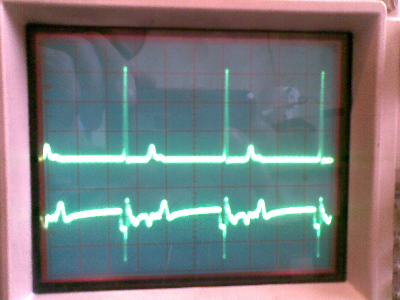

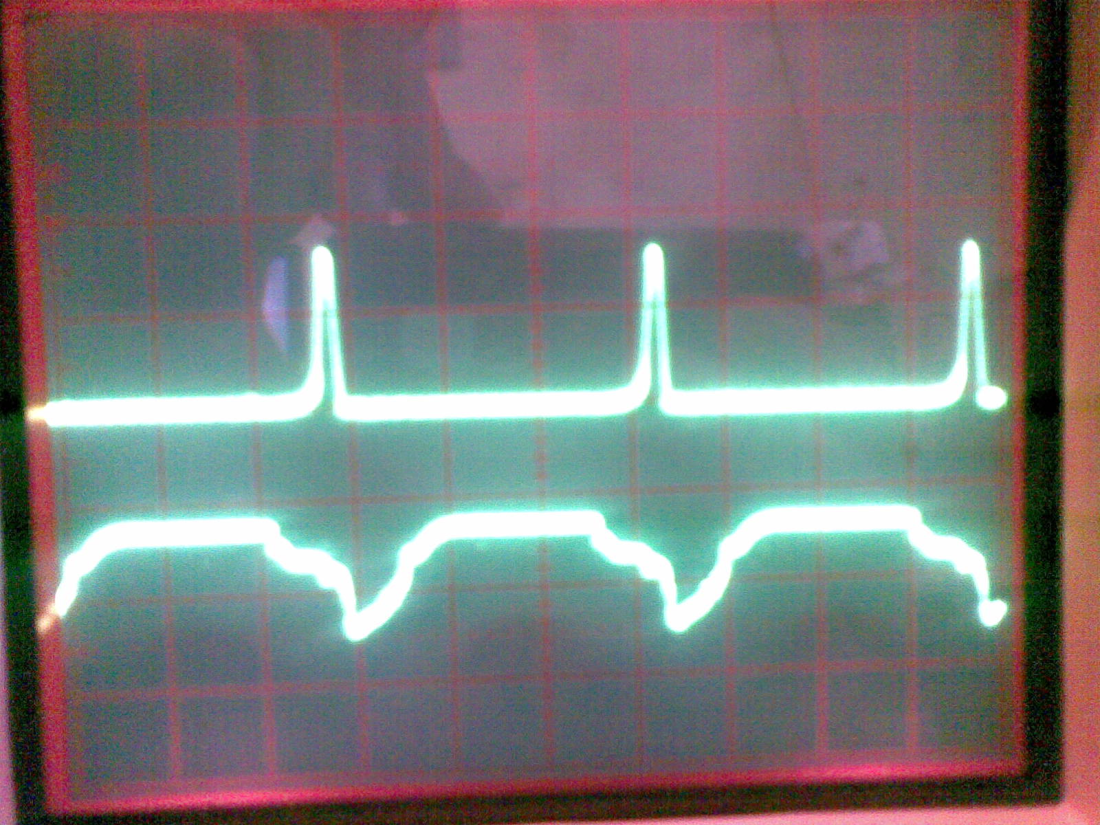

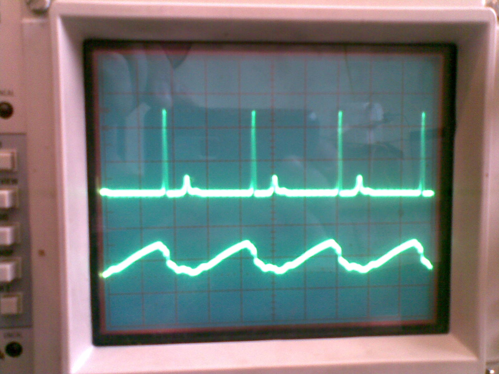

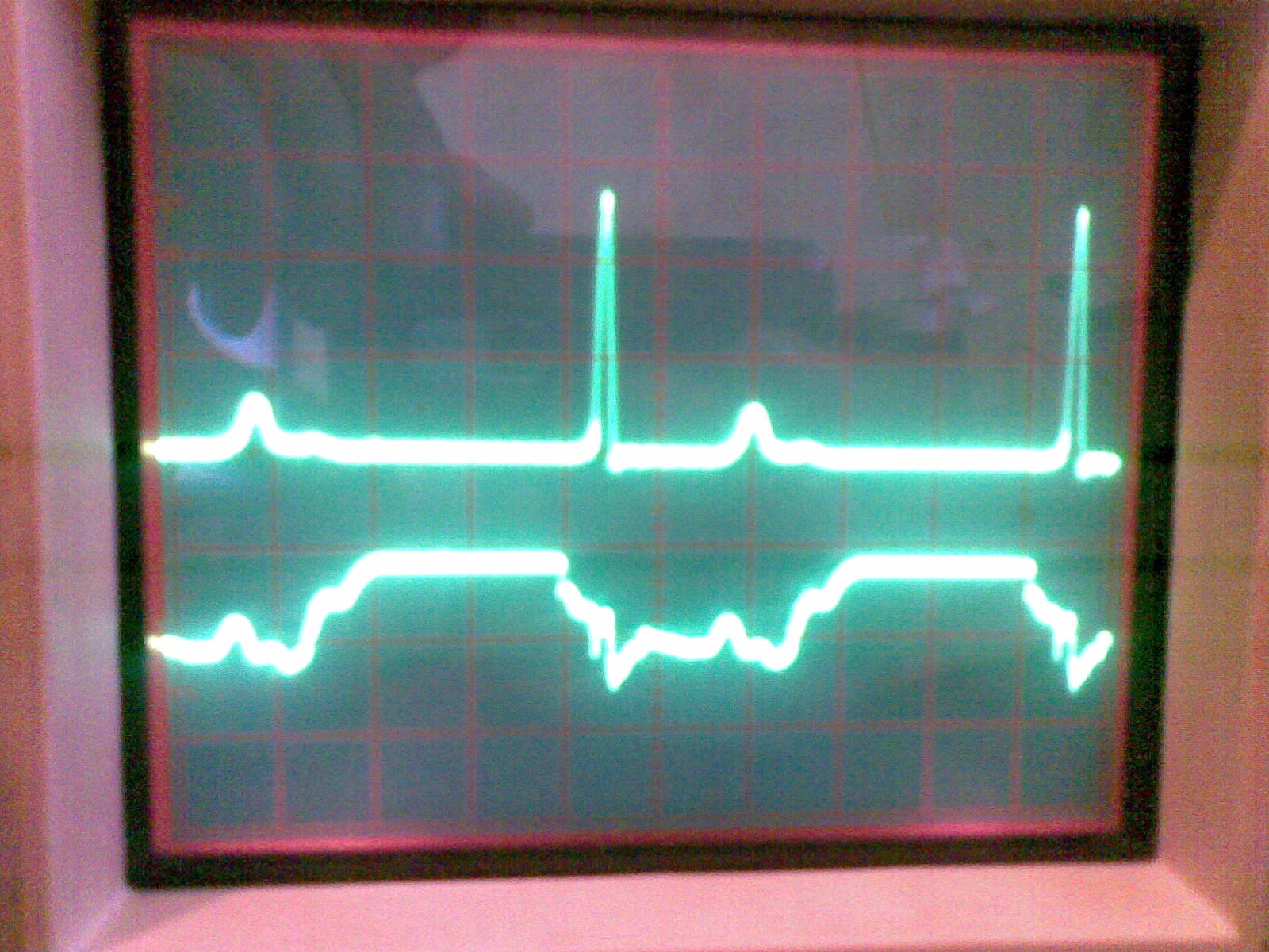

                            • Hi Harvey.
                              1. I attached 2 series of images:
                              a. 600v - shows the regular waveforms , "not clean" - with the small wave after the larger one + gate pot. waveforms as well.
                              b. 400v - this is the only mode i could get a "clean" waveforms at the load probe. However, you can see that the avgerage voltage on the shunt is clearly positive so this mode is useless for testing. how can i get also an avg. negative voltage ?
                              Also, this "clean" mode was very hard to maintain. the gate pot. was not enough sensitive so i could not hold this mode for more than a few seconds even when i connected a 10ohms resistor in parallel to it, in order to increase its sensitivity.
                              2. Q: when i connect the LEDs circuit, where should i connect the GND ?(the cable that connects the 555 GND to the battery '-' pole) - after the LEDs (CSR-LEDS-GND-battery) or before them (CSR-GND-LEDS-battery) ?
                              please see the images i attached: when using "after" (i think thats what your diagram showed) - i get different waveforms than the ususal, and only when using "before" - i get similar waveforms to the known ones. of course when i get similar i can rely on these settings when i disconnect the LEDs as you suggested, but when i get diff. waveforms i could not rely on them.
                              3. Test #11 - COP 0.66 - better than before but still no gain. this time i tweaked a lot the various pot. and i think i got the best "green" led luminosity so far, relative to the "red" one. i think the green was almost lighted as the red or equal - so how this did not affect the COP to be > 1 ?
                              Gad

                              • Hi Gad,
                                Good work on the Green LED
                                Your third image is closer to what we are looking for. The current (lower trace) tends to level off and right then we have that steep vertical drop indicative of a clean switching of the MOSFET to "OFF". At this point all of the energy stored in the magnetic field of the inductor becomes BEMF on the drain pin. The faster that turns off, the more voltage you get at the BEMF pin.
                                In the first image, you can see that we do not get that clean steep turn off, and this results in some of the field energy being allowed to flow through the MOSFET in a linear fashion where it becomes lost. Observable in the amplitude being reduced in the BEMF spike.
                                We can see in image 2 that the inductor does not have sufficient time to fully charge, and therefore the magnetic field does not contain as much energy as it could and this also leads to a reduced BEMF spike.
                                It would be helpful if you could include your time base settings for the shots also so we can see what the frequencies are that are involved.
                                The probe should be connected directly across the CSR and both grounds for the probes should be connected to the same exact point. This is absolutely necessary to avoid allowing current to flow through the scope ground wires. We know that the LED's will elevate the reference by their Vf, but this in not important to the CSR accuracy and the 1.6V differential in the top trace is unreadable as the trace itself is ~7.5 times thicker than that differential. Therefore, even with the LED's in place, the current reading is still very accurate and the Drain reading margin of error exceeds the elevated value.
                                However, it should be noted that the inclusion of the LED tool adds resistance to the path and therefore limits the maximum current that can flow in the Inductive Resistor. This is why it is only a tool to be used for dialing in the settings and it should be bypassed (with a short thick wire) or removed during the caloric tests. The waveform timing should not change much when the tool is bypassed. But the waveform amplitudes should increase in both traces.
