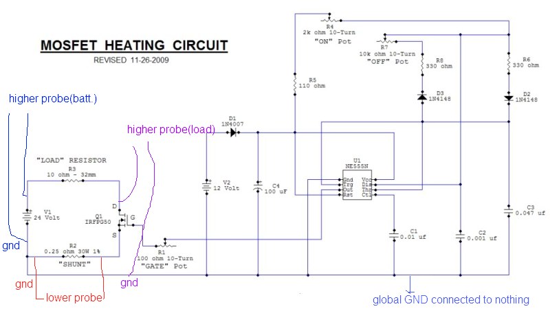

    Can you give us a snapshot of how your probes are connected to the circuit?
    I notice that in one of the shots we are getting good clamping by the internal diode but in the other there is some shoot through and that is the one that looks as if the CSR has a superimposed frequency on it. Also I notice (but very hard to read because of the blurring) that you have Volt Avg set on one screen and on the other you are setting the trigger? Hard to tell for sure what is happening. But perhaps something is setting the DC or AC coupling in different settings? I'm also not sure of what you mean by "Battery or load Resistor". Do you mean that one of the shots was across the battery and the other was across the load resistor?

      Hi Gad,
      See attached (ignore the 555 circuit part - mine is newer, according to your modifications)
      Yes, as i mark in the images filenames.

        • Hi Gad,
          Now I see the file names
          All three grounds (blue, red, purple) need to be the exact same physical position. Otherwise any voltage produced across the inductance of the wire between them will cause a current to flow in the probes reference leads and that can cause weird readings.
          One thing I see in your pics is that the BEMF energy is passing right through the resistor as if the resistor has no impedance to it. In Glens pics, it can be seen that this energy is almost fully dissipated in the resistor and according to my analysis that is where the heat is coming from.
          In other words, the battery shot should look almost flat except for an inductive bump from battery wire inductance and the energy should be greatly filtered by the battery capacity. You may want to review Glen's pics to see the difference between the Battery and the Load shots.
          If the energy is passing right through your resistor, then we have to ask why. Perhaps it is passing 'around' it via some type of capacitive relationship due to the Teflon between the windings. The dielectric of the Teflon may be storing the energy and passing it from winding to winding instead of forcing it to go around the loop of each winding essentially bypassing the resistor. I wonder if it would read on a capacitance meter
          I hope that helps. Please keep in mind that you are working in uncharted territory as your resistor is unique. But you are certainly asking the right questions
