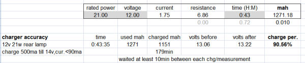

my digital charger accuracy
Hi harvey.
i measured its accuracy by using a car lamp (rear lamp) - 21w/12v rated.
results: see attached screen capture from my Excel.
In short:
used MAH: 1271
charged MAH: 1151
accuracy: 90% (means -10% from expected)
I assume the lamp took less than 21w, since in all my tests the charging process used about 5-10% more energy than used
My conclusion: maximum of +10% /-10% accuracy.Last edited by gadh; 12-01-2010, 12:28 PM.
