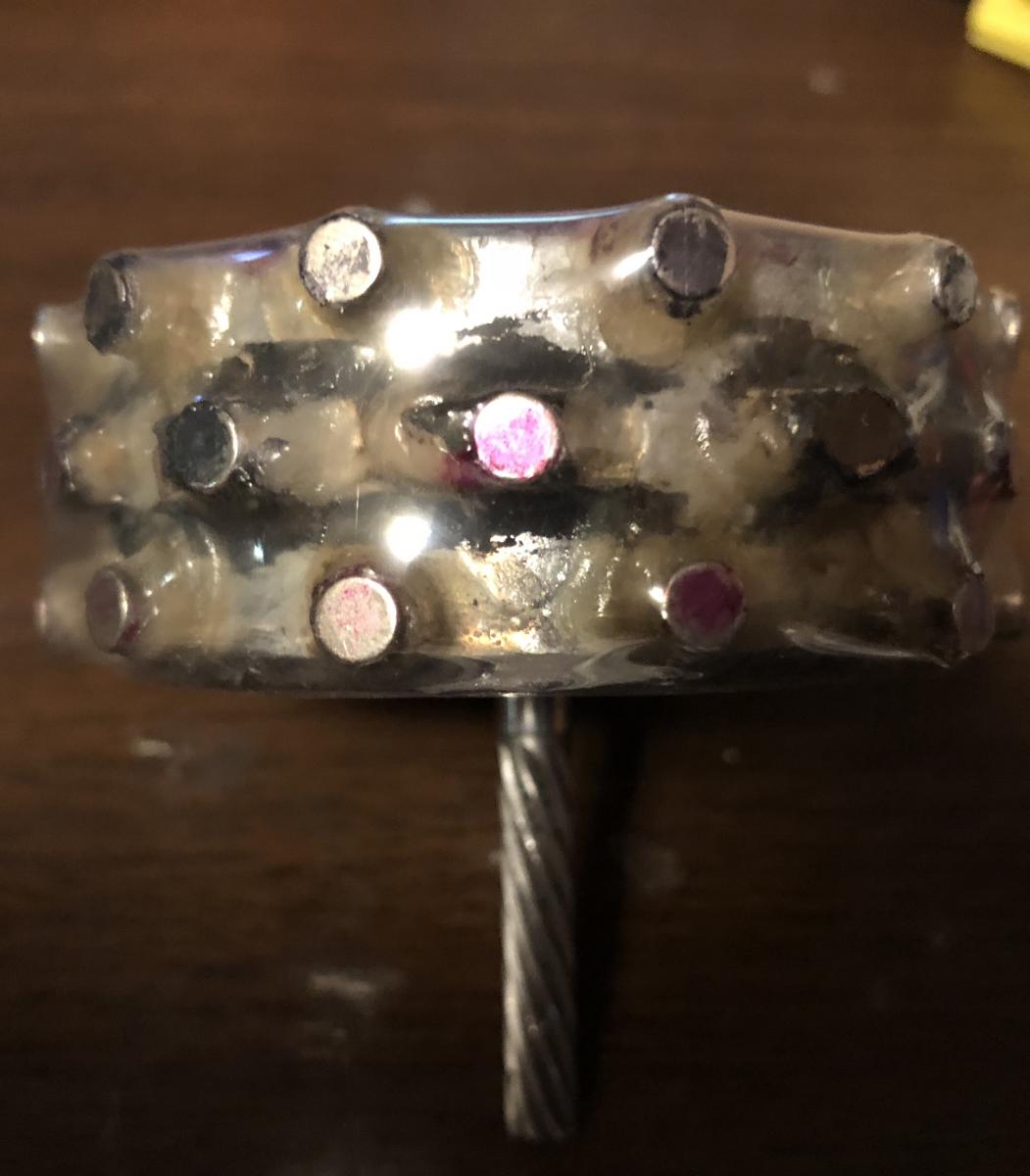

  • #76
    The photos are before rectification has occurred.
    Just plain old alternating current?
    What do you men see happening across the middle coil?
    The rotor is as much centered as possible by hand/eye.
    The middle of the rotor is nsnsns....
    The top row is nnnnnnn...
    The bottom row is sssssss.....
    The photos reflect this arrangement of
    pyramid stacking of magnets.
    Red magnets are south.
    Black magnets are north.

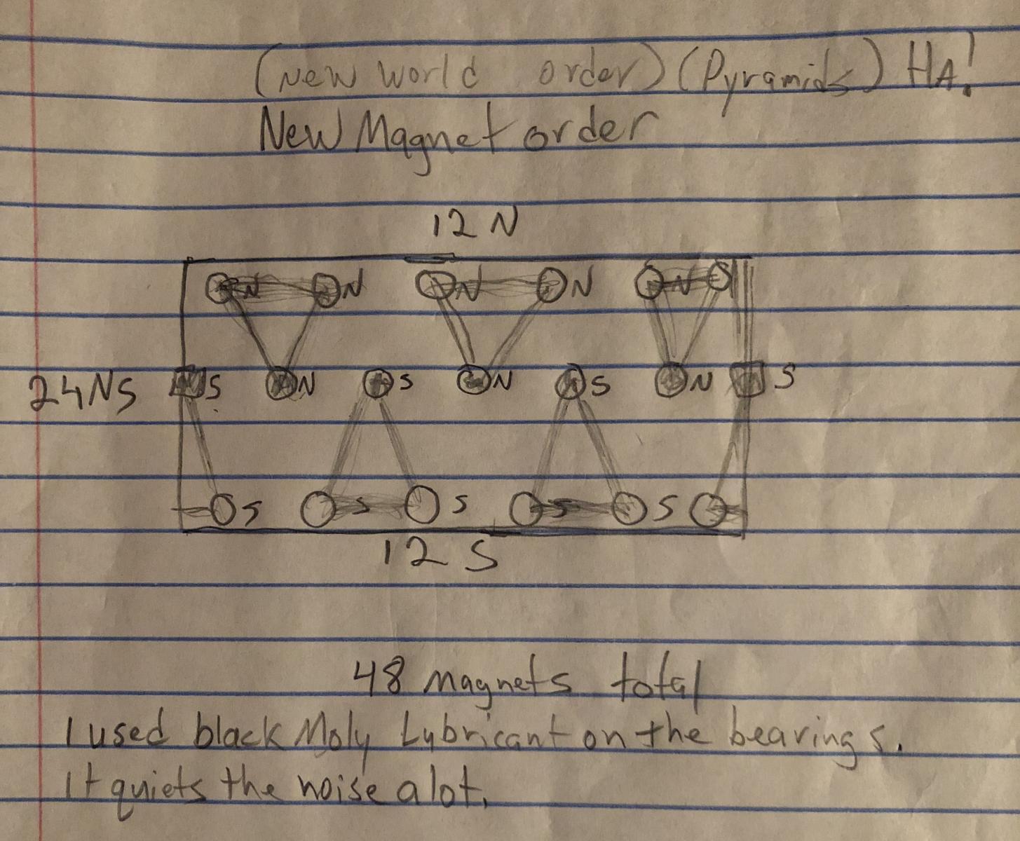

    • #77
      New Magnet Order
      Photo of the drawing of the rotor magnet arrangement.

        So how many coils? Does 1 core cover all the magnets top to bottom
        or will there be many many coils, one for each row? The shrink job is
        nice.
        Looks like your gaps will be 3/16" using this method which is fine.
        Some motors run 100-300 rpm's like a Bedini pulse motor. Or are
        you going to run 3600 rpm's?
        With those magnets you have and they look like strong ones you'll be
        able to pass some flux to cores. Any ideas on winding up a coil?

        • #79
          So how many coils?three Does 1 core cover all the magnets top to bottomthe center magnets go over the center of the coils and the top magnets energize the above area center of coil and the bottom magnets energize the bottom portion of the coils, hence the scope screen shots of ac with positive pulsed ac and negative pulsed ac.
          nice. Thin Q
          you going to run 3600 rpm's?I just let it run until it explodes.Then I cuss about it and watch porn.
          I was thinking about ordering some for the size of the rotor as is the alternator circuit, but I am going to build a new design.

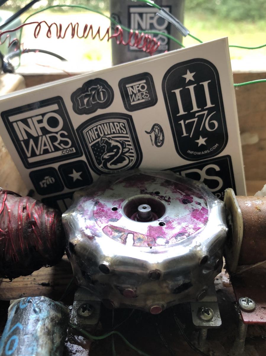

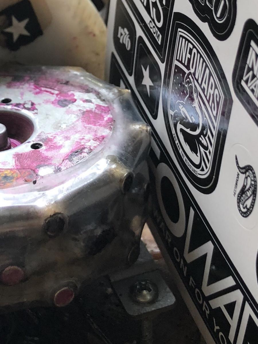

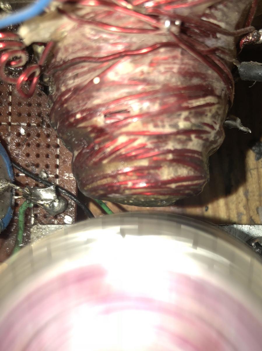

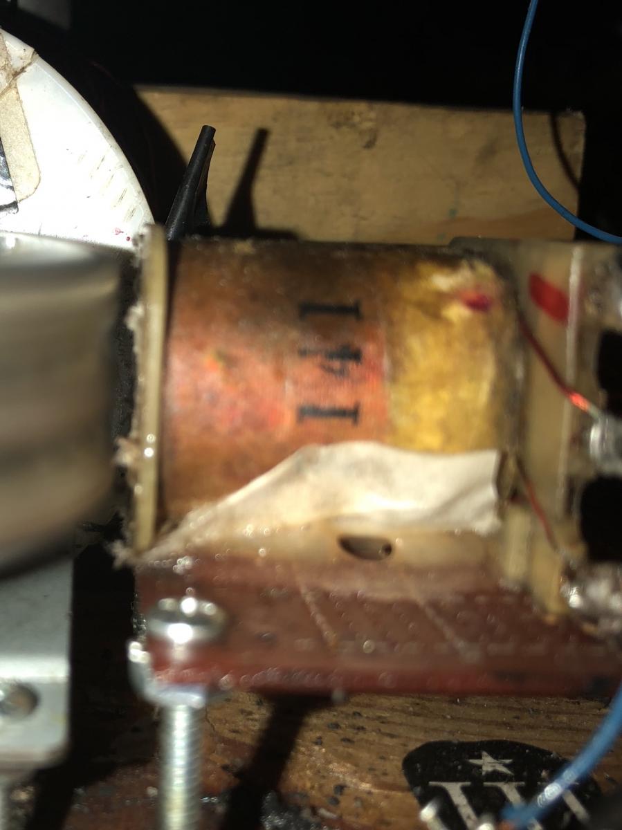

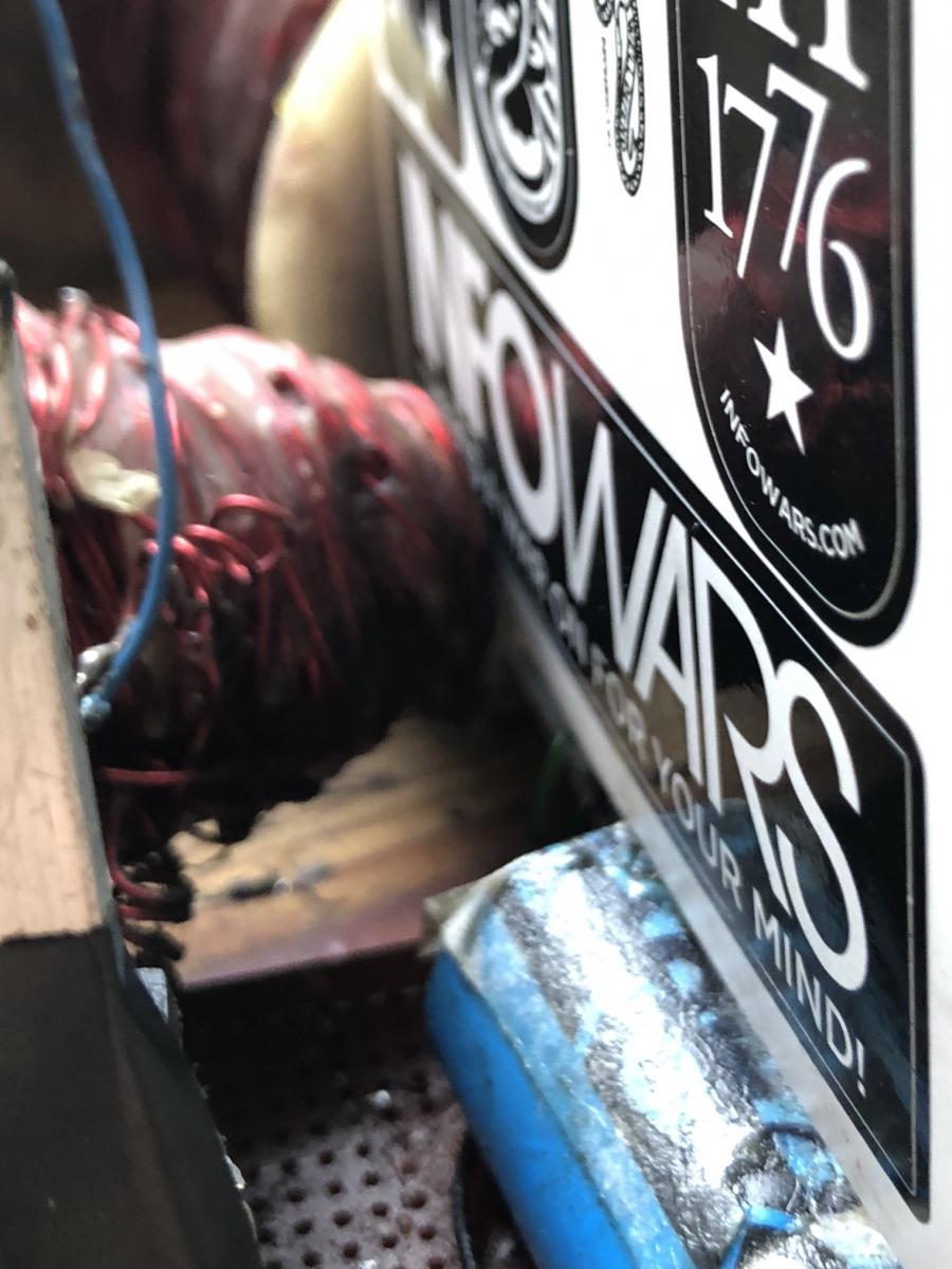

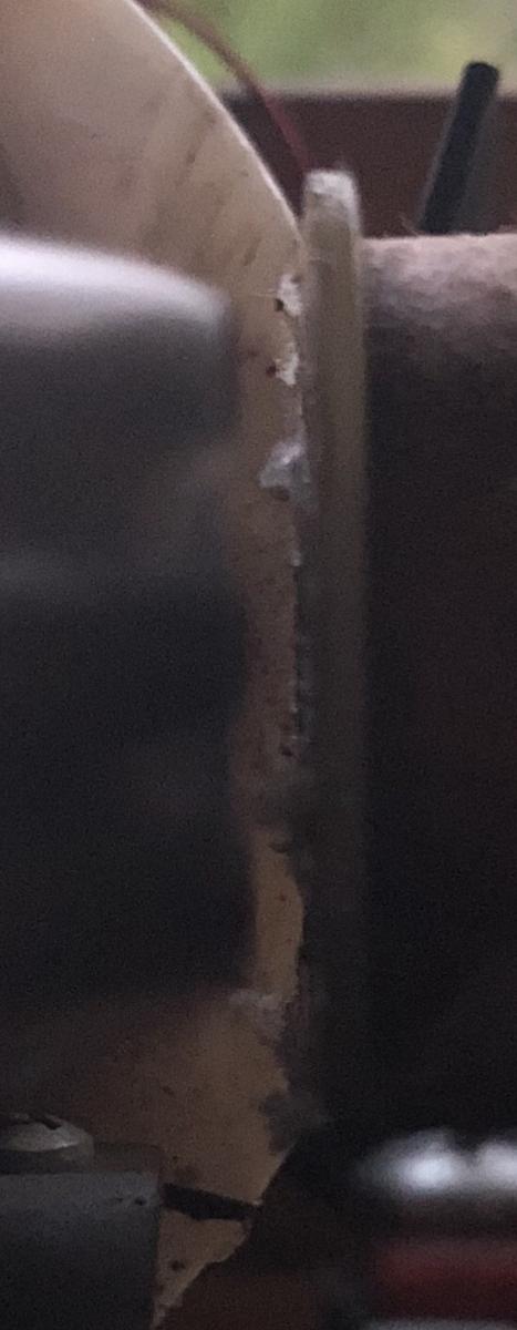

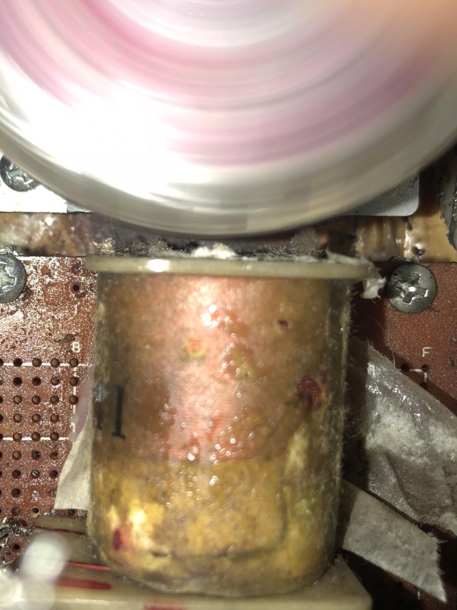

              Coil photos
              Just a few foe toes to gain more perspective of the magnets across the coils.
              • #82
                Hard to see foe toes, is that a 1/4" gap? Getting any readings?

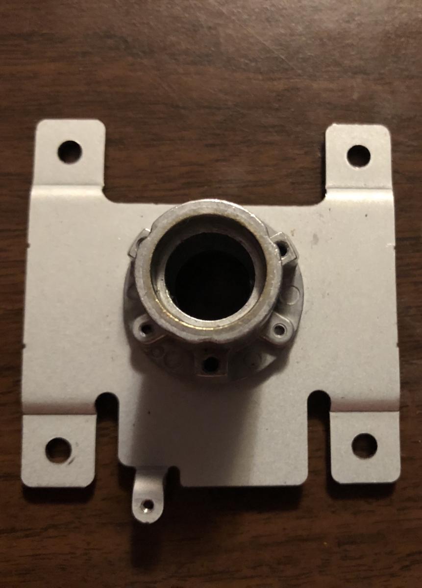

                  • #84

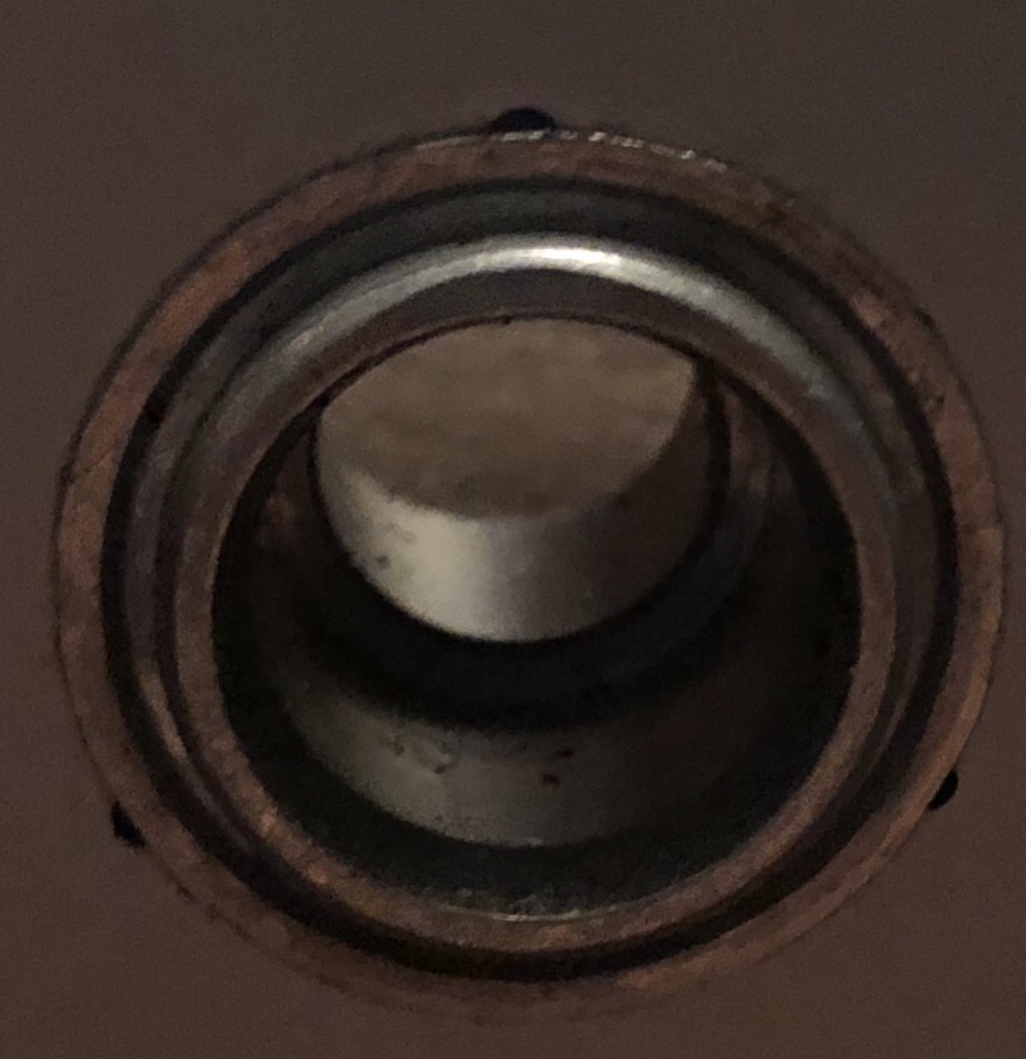

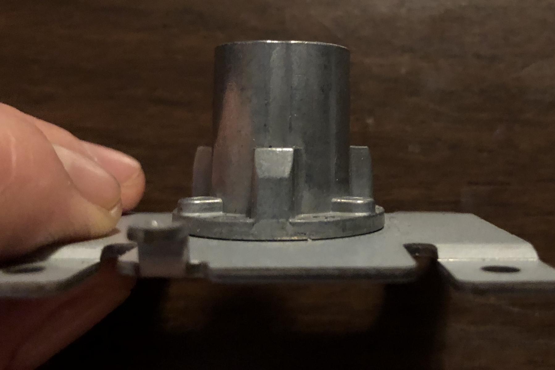

                    Little Spring
                    I have not seen or heard DadHav talk about the housing
                    or other components associated with this type of rotor.
                    There is a flat, thin washer type spring that
                    goes in the top before the top bearings.
                    It is a necessary component for proper operation.
                    When the top and bottom bearings run,
                    the tiny space the spring supplies is critical
                    for smoooooth running and sound suppression.
                    Top view
                    Bottom view
                    • #85
                      Hey Brother, the actual gaps are between one having 1/32 inch gap to another having a 3/32 inch gap. The photos are showing a few thin sheets of paperboard that are 1/32 inch thick.

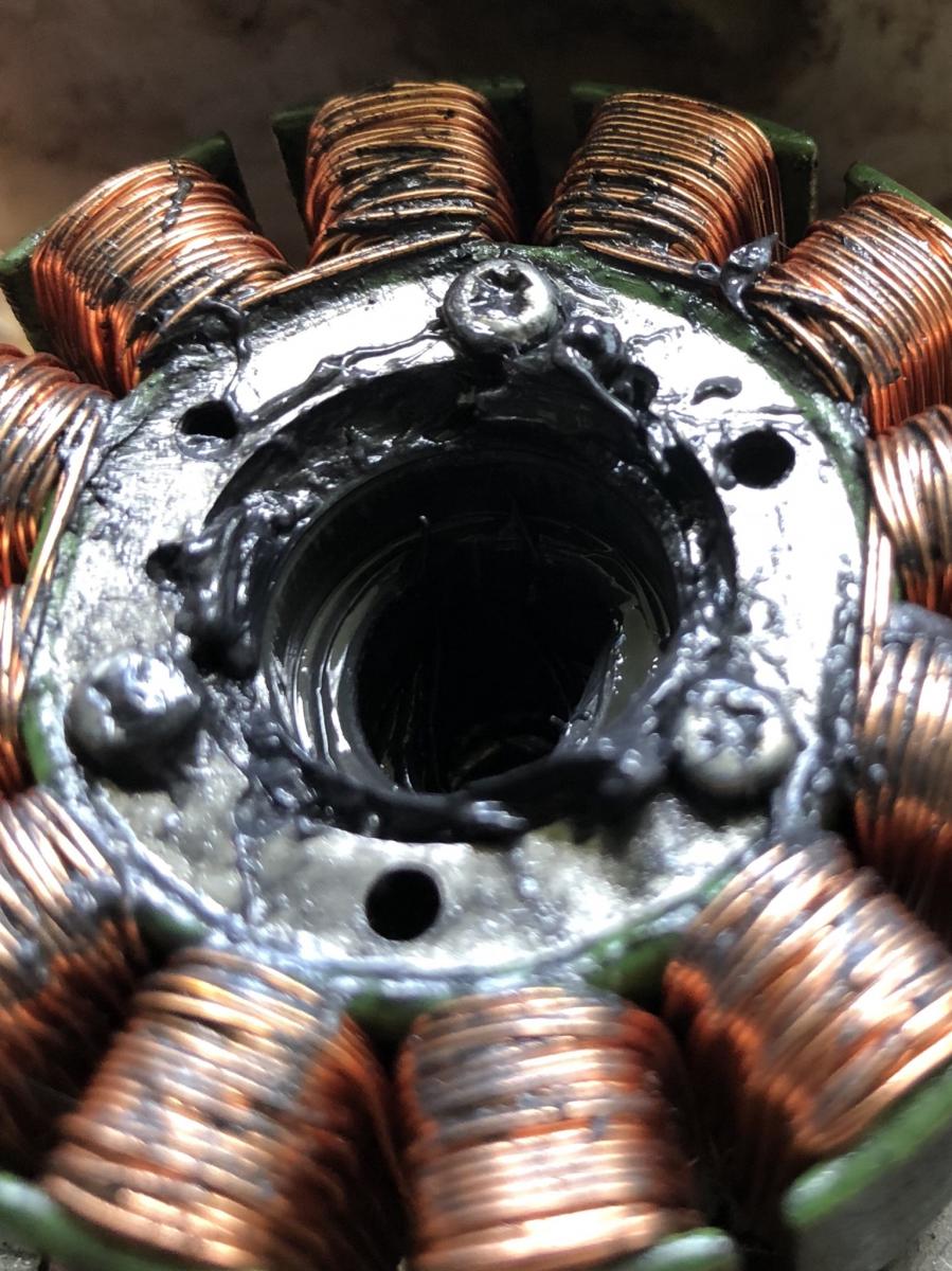

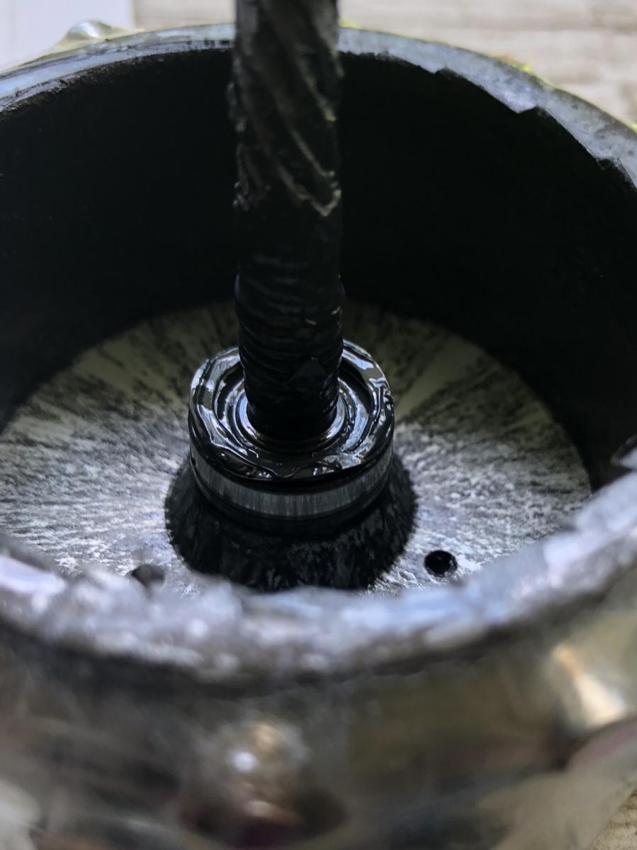

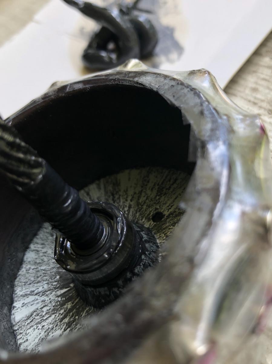

                        Spring time
                        Some greasy photos for your greasy minds!

                          1/32 gap at the corner of the magnet yes and 3/16" in the center.

                              • #90
                                I don’t know now if it’s 36 or more magnets,
                                I’ll have to recount.
                                No hanging chads to interfere with this election of freedom.
