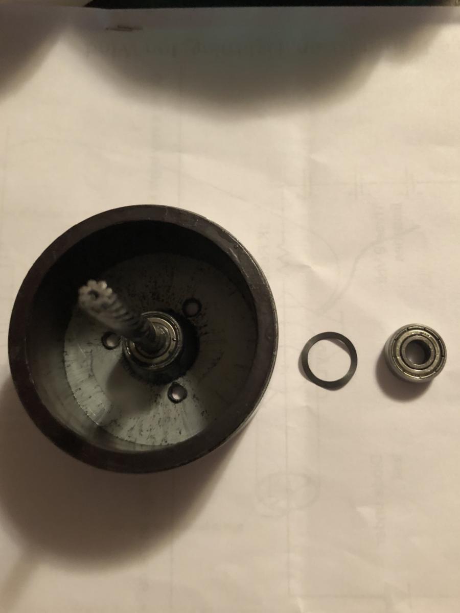

                Rotor Assembly
                Here is a rotor without any exterior magnets.
                It has an interior ring magnet that is designed just for this wind, from the factory.
                The inner bearings are the beast of burden for noise suppression.
                The little ring spacer is essential for smooth operation.
                Finally the bottom set of bearings.
                They stabilize the rotor but can fall out.
                Maybe the solution is to use graphite and lube.
                That is why experiments are crucial.

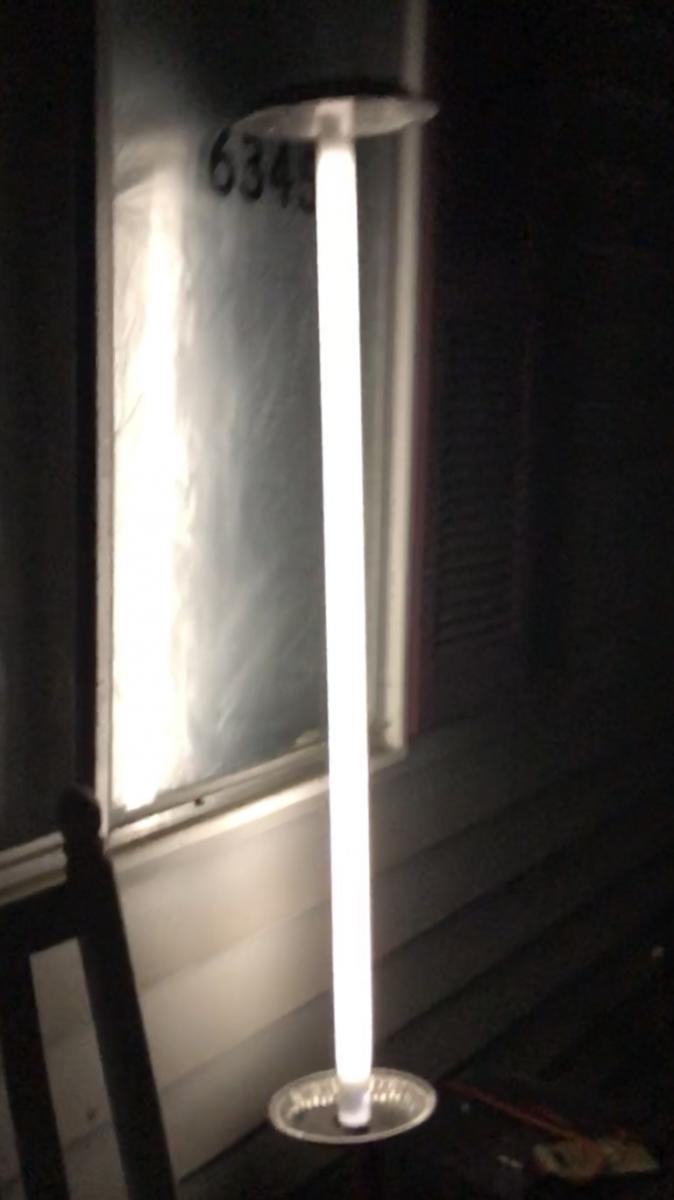

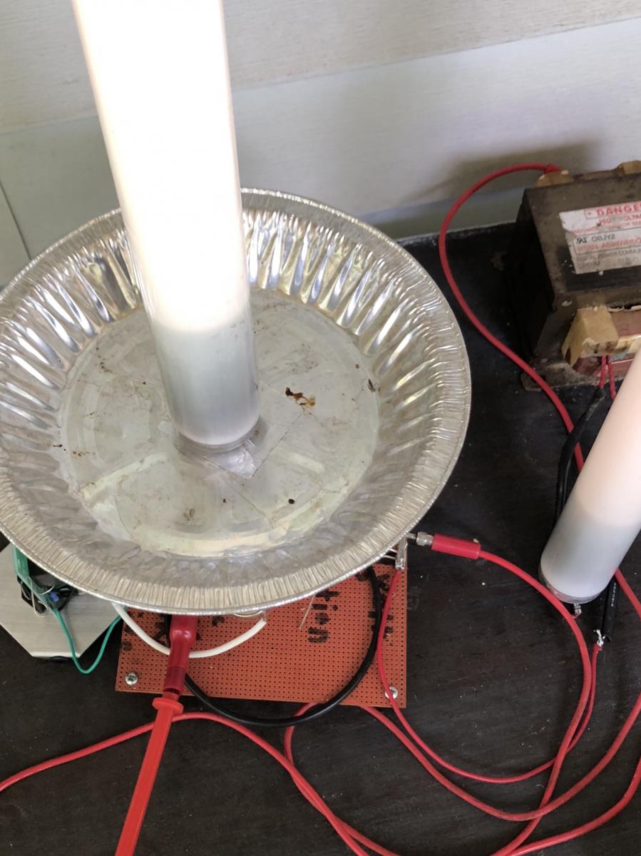

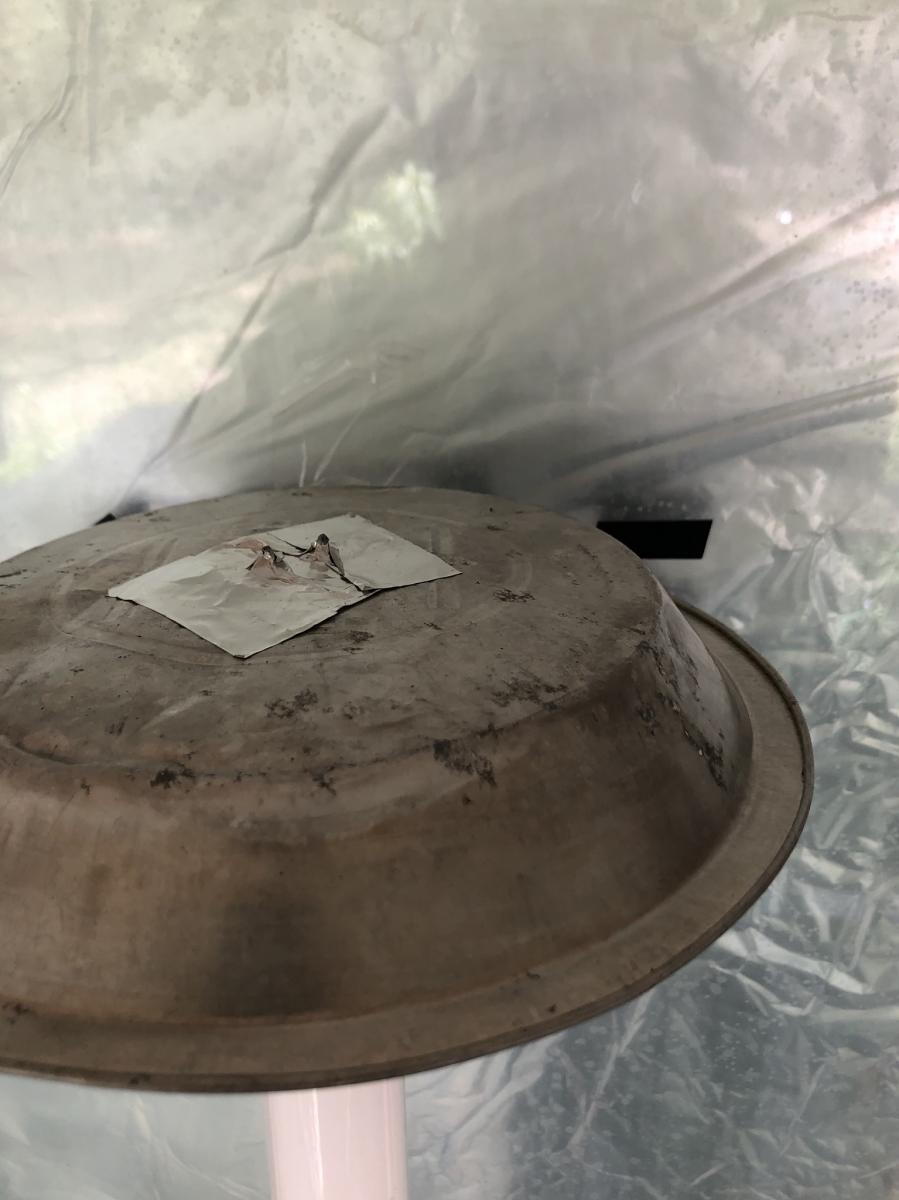

                • #98

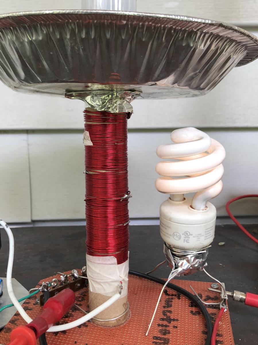

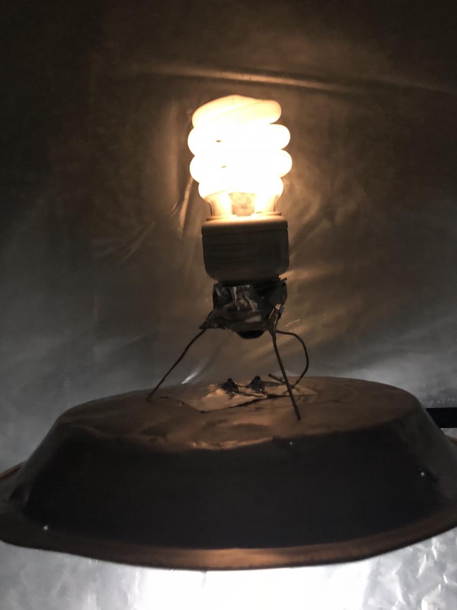

                  More shocking stuffers
                  Stocking stuffers?
                  Another junkyard build.
                  I figure the energy reflects back and forth between top and bottom pans oscillating.

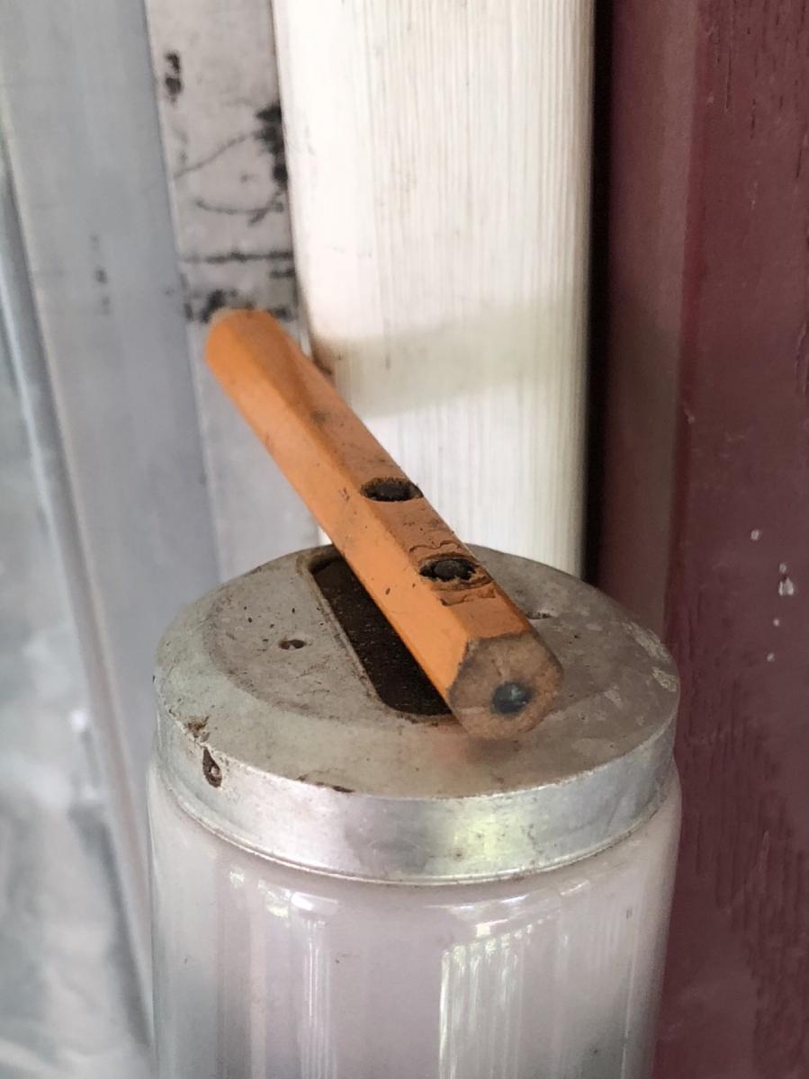

                    Spark gap
                    Simple tools and machines.

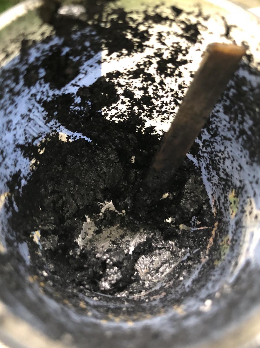

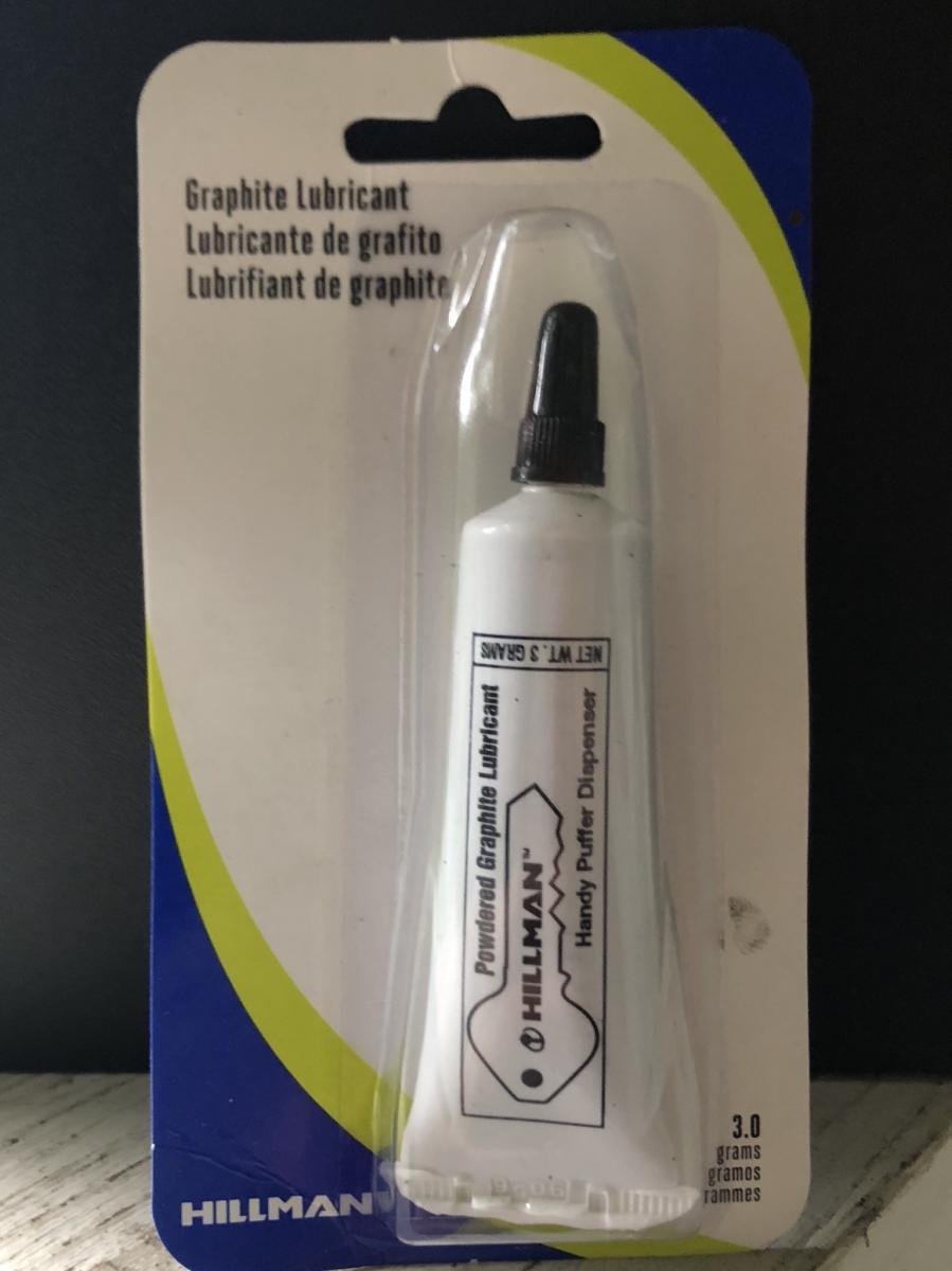

                      I have been experimenting with several types and grade of lubricants for the use on the tiny bearings.
                      The winner so far is an emulsion of Dritz oil with graphite and then blended with black moly grease, the kind I use on my big pillowblock bearings.
                      The mix keeps the song it sings proper.
                      The graphite conducts electricity, so it will keep producing spikes but consistently and without undue wear and tear.

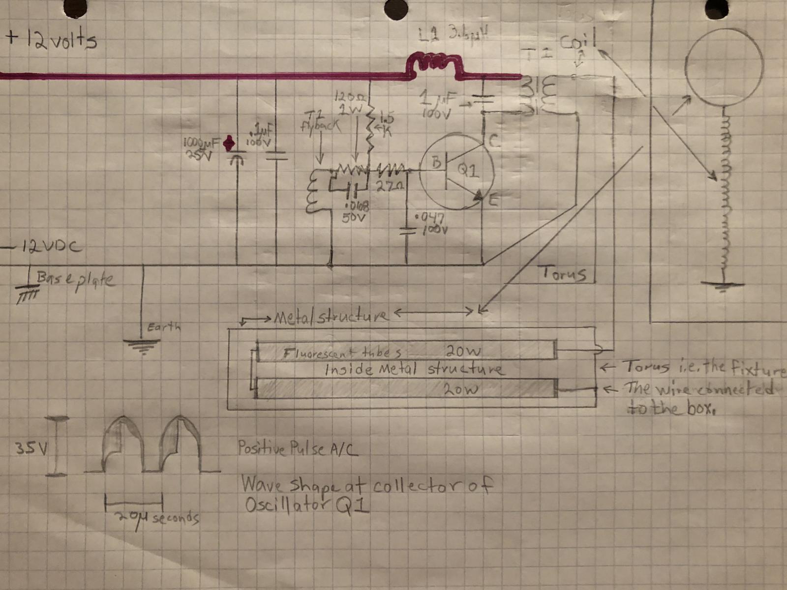

                        • Simple Circuit
                          Yes, it is a simple circuit.
                          • Yawn!
                            Well, no one has mentioned or asked if the positive pulse ac from the middle coil output would work on a Tesla coil setup.
                            The middle coil has both positive and negative pulse ac outputs, so a more adaptive person might use both.
                            Okay, the resonances of both would have to be matched with all coils in resonance.
                            Anyone else see this?
