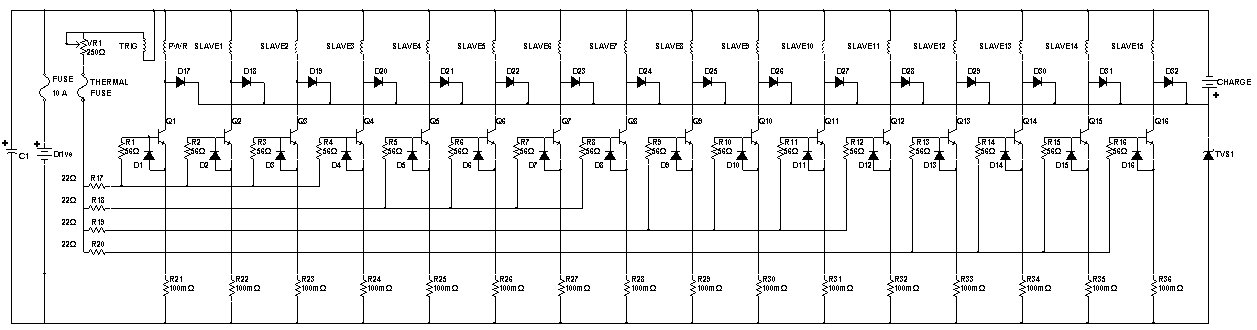

I have built this circuit and it works
Bedini self oscillator circuit:

) as of now it is pulling only 300 ma and the target batteries is going up very quickly. The strange thing was I was unable to get it to trigger at 12V, but it started right away at 24V. It took me all week to figure out that 24V was what I needed to give it a jump start.

Glad to hear that it works good for you. My aircored coils also do not start by themselves at 12v, I have to put a ferrite rod in the coil and then tap this rod with a magnet to get it started. Now I am conditioning a dead sulfated battery that has its plates in tact, so far it works very well and each discharge cycle gets more and more amp hours out of the battery. But I noticed, that if I leave this charger on a battery for too long, after it is already full, the battery does get warm, but I have not noticed any ill effects from this heat. After that overcharge, I still got more out of the battery than in previous discharge. © 2007–2026 A & P Electronic Media and its licensors · posts © their authors · Copyright & Archive Policy
