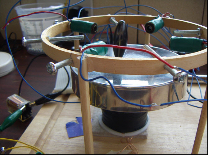

    I also tried to position a smaller pickup coil (with welding rod core) next to the magnet, but if the magnet gets too close it seem to be attracted by the steel in the pickupcoils core and bump into it. So maybe by using 2 oppositely positioned pickup coils, that effect could be nullified somehow, i am not sure.
    Or the pickup-coil must have much less core material, so less attraction occurs.

      In answer to your questions regarding the pickup coils,first the construction.They are made from 38swg wire wound onto some brass spools i don't know how many turns i just filled them.For a core i am using a small steel bolt.You can see them in the pic i have posted off some tests i was doing today with a nonmagnetic concave metal lid.The reason i was using this concave lid was to alliviate the same problem that you have come accross with the verticle spinning magnet and it works so go concave with the verticle magnet.It will still go round in a circle and pass close to the pickups but with careful adjustment they will not touch.That is why i have used the bolts as cores so i can screw them in or out for adjustment.I do not envisage any problem running the 8 pickup coils i have made for this motor following mytests today with all core's in place(see pic).I also think you could run as many aircore coils as you could get near it.I am just waiting for the postman to bring me some more bridge rectifiers.
      I do not have this problem with the angular spinning magnet as you can see in my video.with the angular magnet it's position is completly stable in the presence off the pickups but like you suspected its a ballancing act so add coils in pairs.I think the rpm's may be higher with the verticle magnet,i had my meter set on hz today and it was over 300hz so we really need a scope on this to find out what is going on.

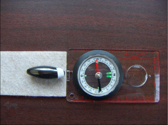

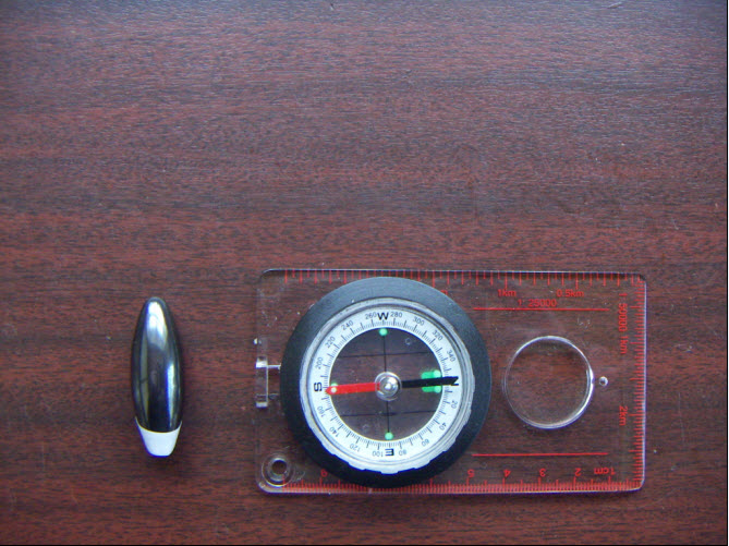

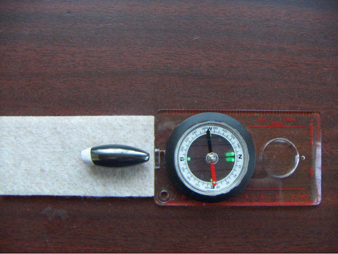

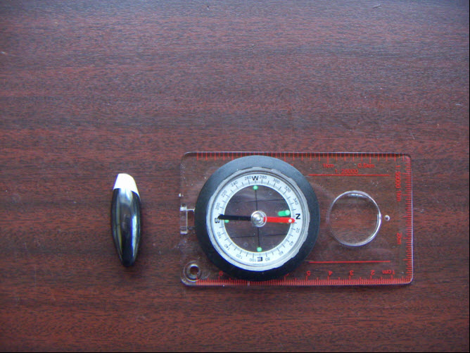

      @ All. Here are some pics off the magnet pole orientation on these crazy magnets.Regards jonnydavro.

        Why don't you guys use air core pick-up coils? Wind them wide and shallow (more like a puck shape) and you can get them much closer to the magnet.
        Remember though, when you induce current into a coil, it becomes a magnet, with or without an iron core. Nevertheless, air cores should work much better for this application.
