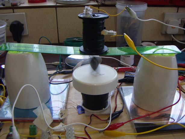

                                @ All.Today i tried adding a slave coil to see what would happen if i pulsed the magnet from both ends.The results were the rpm's seem to be higher and the pitch/sound off the motor increased but this would need checking with a tachometer.Here is a pic and a vid.Regards jonnydavro
                                YouTube - One magnet no bearing Bedini motor vid 4. Master and slave coil
