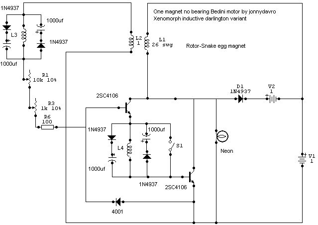

  • Hi.Over the last couple off days i have been testing the darlington config with some interesting results.
    I found for speed and current draw,one transistor was better but what was really interesting was this.I use a 12v relay coil in the trigger circuit.Sephiroth discovered that if you use just the coil in series with the trigger circuit you can drop your amps and its worked a treat on all my Bedini's to date, anyway Xenomorph picked up on the fact that you could put one in between the emitter off T1 and the Base off T2.I have tried this config and it works i found better than the standard darlington setup and there is the added benefit off being able to recover bemf from this relay coil as well.
    I have enclosed the circuit i used if anybody wants to test,but i think Xenomorph might have invented a new component.If you put this transistor setup in one package you would have a Darlington transistor with a voltage output.What you going to call it Xenomorph?

    • @Jonnydavro: Very nice that you managed to integrate this
      I believe that with different inductances you could maybe "tune" the circuit for lower amp-draw by adjusting to different resonances. I wonder if variable inductors would do the same job as the relay coils? That would make it hard to tap the energy though off the inductor.
