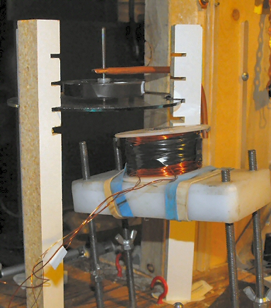

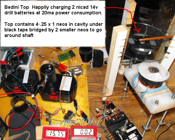

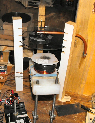

      Thanks for getting back to me, I do have reflective tape on both the top and side of the top. I thought the top metal might be too shiny so I added some black tape and also tried some green tape plus reflector and no luck with accurate tach readings.
      Sorry for messy pics attached, my lab needs a clean up but no time as usual. I have learned that placement of the coil is key to min amp draw and max charging and top stability.
      This rig seems to run best at a wide coil gap of about 1" plus an angle of about 20 deg. drawing 27ma average. The coil also needs to be offset by about .5 diameter. I also need an arm to keep the top from wandering off my glass dance floor. The one in the pic is just a flex copper tube with a hole about 2x shaft diam. drilled in it.
      You must spin up the top to about 1,000 rpm and have the coil tight to the glass to get it started, after it spins up for about 30 seconds you can back everything off for min. power consumption. It will run with less than 10ma even in this early stage of testing. about 4000 ohms resistance is in the circuit along with a choke coil (thx. Sepiroth) This configuration has a long way to go for optimization. Definitely worth testing further.
      I am currently building a better top. Coil position adjustments are critical to optimum performance and need to be in micrometer increments. I will also build a cross slide with height and tilt adjustment to accomplish this when I have time. Right now I have just spun some threaded rod through a plastic block and I can twist the height and angle up and down while manually sliding the coil around. this makes a huge difference to operation.

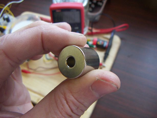

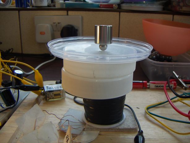

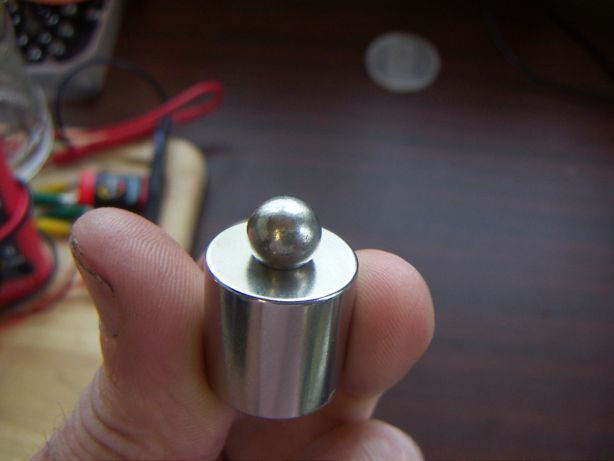

              Hi.I have some N42 20mm x 20mm with 6mm hole Diametricly magnetised cylinder magnets which i have got for another motor i am working on and i wondered if i could adapt them to work on the one mag bedini and i have and it spins fast.Is what i did was i placed an 8mm ball bearing in the hole as a pivot and it is very easy to start and it triggers the transistor from 8 inches above the coil but it gets even better.I can run multiple rotors at the same time and current draw does not seem to be affected.In the video i am running a snake egg and the N42 cylinder at the same time.I have another N42 and will try and get the 2 N42's going but i thought i would let you know what i have for now.Here are some pics and a vid.Regards Jonnydavro
              YouTube - One magnet no bearing Bedini motor.New rotor and multiple rotor tests

                    Hey Jonny, In my latest test of the top design, I suspended the top from its shaft on a neo cylinder strong enough to hold it up and so the top has very little friction at all now and the suspending magnet has the added bonus of keeping the top in one location. it cut my power consumption quite a lot. I can get the rig to run consistently on about 6 ma! at 15v. and it still charges 2 drill batteries nicely at 14ma.
                    you may want to try suspending your n42, just put a pin through a board and see if the ball bearing you are using will stick to it enough to hold it up. Or put a nail up through the magnet and use another magnet to suspend it. Friction goes way down and so did my power consumption.
                    The next step has to be a diamagnetic or superconducting levitation Bedini motor resulting in near frictionless hyperspeed rotation. Who will be the first to build one...

                    • @Synchro.I think your tube magnet idea has opened a new chapter in this project and my initial tests look really promising.This morning i had 2 N42'S spinning and it was quite easy to start so things may start to get intresting.You sound familiar, are you Zebok from utube?If so HELLO,If not HELLO
                      @Xenomorph.Hi.I put the tacho on the new rotor this morning using an aircore coil and it was doing 15400rpm on 6.5v at 29mA.I will try to get a reading when using a core later as when using a core the max magnetic field acting on the magnet is stronger some way above the coil so i will have to play around and find the best height.
                      I also did a quick test with my pick up coil using a real power hungry red Led and it lit it from 7" away so thats looking real promising and goes some way to confirm Synchro's theory on the benefits of using a strong rotor magnet.
                      I have also got 2 N42's spinning now and you will be suprised when you see that setup but i will have to go and find a new Lid from the supermarket as i only have one good one.
                      @Mark.thanks.I am experimenting with air core and maybe able to help on the centering problem.I will try and post a pic later as i can control the strong cylinder mag but i don't know if it will work for the snake egg as it requires a real strong magnet.This is the great thing about this forum and sharing idea's.One thing leads to another.

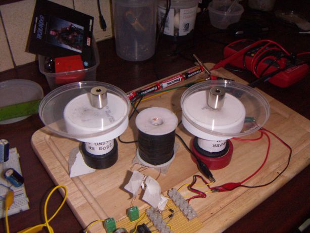

                      • Hi.Here is a vid of two N42's spinning.I am using an air core power coil for this test and it is pretty easy to start but getting them synced so they can be spun up to top speed together is a bit more tricky but doable.I found that if i just place stands next to the power coil,these magnets are strong enough to trigger the transistor from a distance and this setup seems to work really well.Regards jonnydavro
                        YouTube - One magnet no bearing Bedini motor .Twin rotor Test
