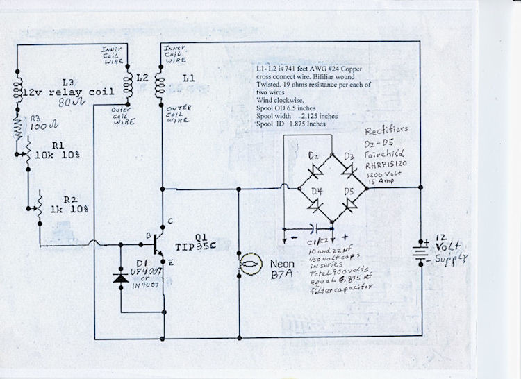

              I have wound and tested a new coil. This one is a Quadfilar Spiral Knot. I got the idea for this coil at the "Joule ef thread" below. It's working very well with a 1" sphere in the center of the upright Quadfilar Knot. The output from the second set of twin wires, is cross wired like the joule circuit then to a full wave bridge rectifier. This Bedini power, Joule output combination worked extremely well. Now I plan to test it with the 2N2222 transister and see if it delivers the Cop>10 that the Energy Thief designers say it delivers; When It doubles as a battery charging Joule thief type oscillator.

                  I succeded in attaining resonance spinning a very large 1&1/2" neo sphere inside the air core of my twin spiral. I have the output looped back to source.
                  The circuit does not oscillate unless the output's circled back to the run battery. The ratio of charge gain to primary depletion gives the circuit a COP of >2 while in self oscillation. This kind of bemf charge can be described as a bit flimsey, and those measurements can be strongly misleading. It does run pretty close to breaking even with the spinners of differnt diameters, coupled with the backloop. I got it Joule thiefing at this point; That demonstrates the coil can dual purpose.
