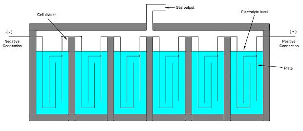

    Yes, the diagram should work fine. About question more plates or bigger plates? It's up to you. If use bigger plates, use less plates and wise versa. I would suggest to keep cell size similar to NS70 battery. You may use 6 inch plate size. Just look at battery cell plates (size and gap between plates) to get some idea.
    Leave 0.5 inch to 1 inch space at bottom of the cell (dump dirts if any). For top, leave at least 3 inch from plate to top cover. Plate gap 3mm. Electrolyte level just above plate (0.5 inch). Leave 2 - 2.5 inch space between electrolyte to top cover. This is to cater for flothing (foam) happens when electrolyste is cold.
    I have attached simple design on how the electrolyser should look like.

      I only have one question, are cell dividers necessary?
      Thanks,
      Alex
      • Originally posted by Alex S View Post
        Alex
        Yes. Cell devider is must for series cell to prevent electrolyte to cross over into other cells.
