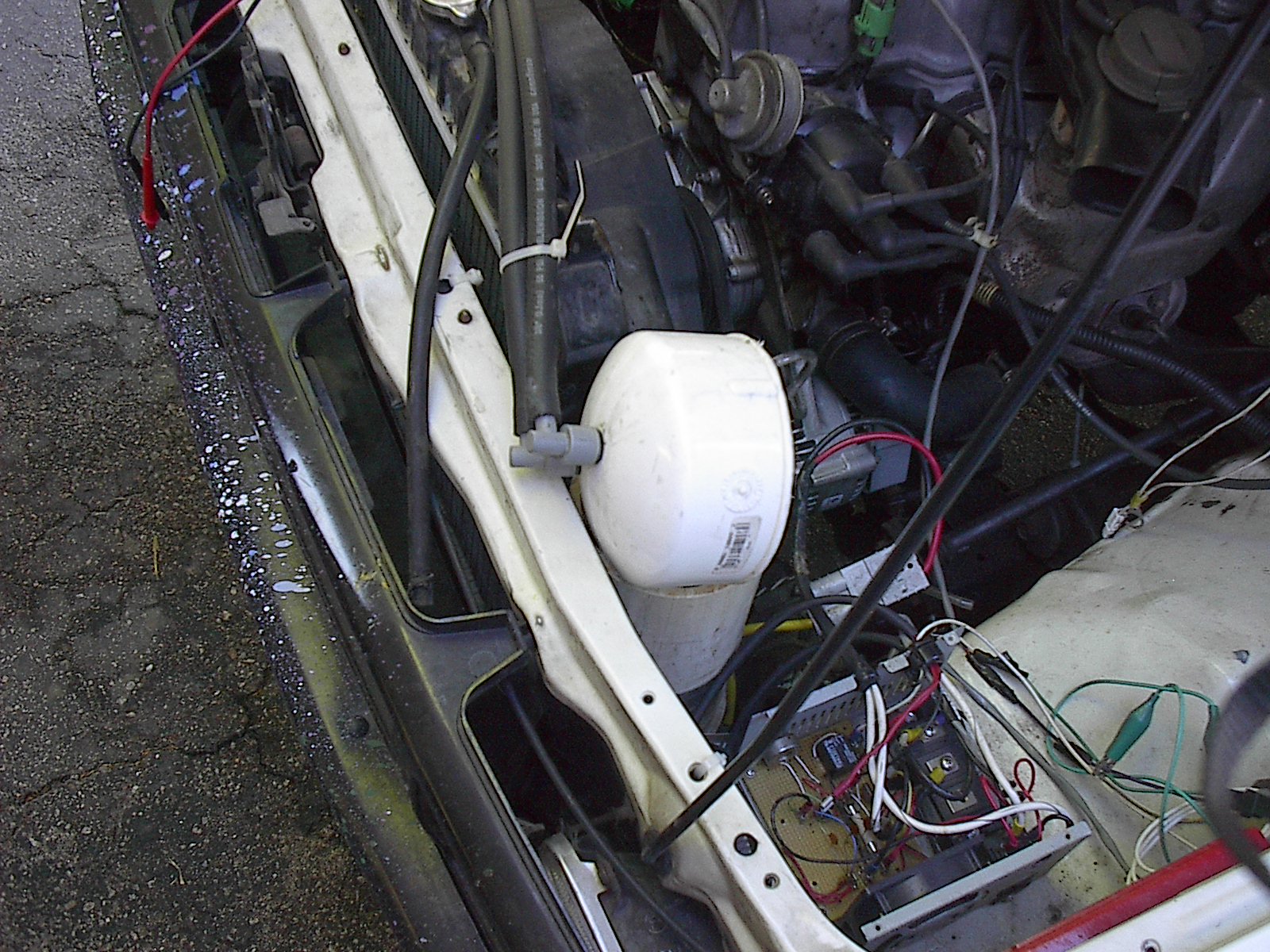

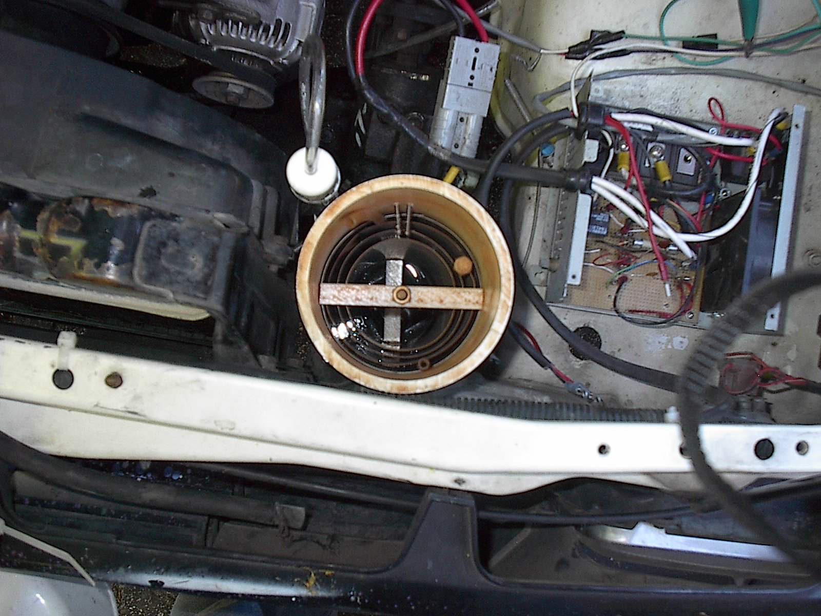

    Here are some pics of my current generator, the bolt is to tie the neutral plates together. (empty for cleaning)
    The electronic box pulses the MOSFET to the plates. Two small S.S. screws act as a level sensor.
    I built in a window washer pump to refill the system from a tank carried in the bed of the truck, found I needed to run it with a solenoid valve to keep it from flooding engine with water.
    I observed the cell producing what seemed like a large quantity of HHO as well as quite a bit of foam.
    I haven't found reference to foam except with joe cells ???
    The PC power supply box works great to house the electronic bits and pieces.
    The cap in the photo shows the 2 PCV valves and associated plumbing.
    Bigger and better things coalescing on the work bench, will post pics and test data when finished
