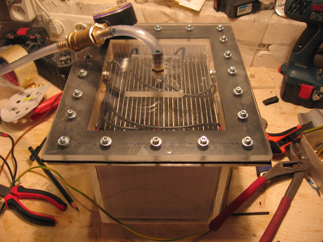

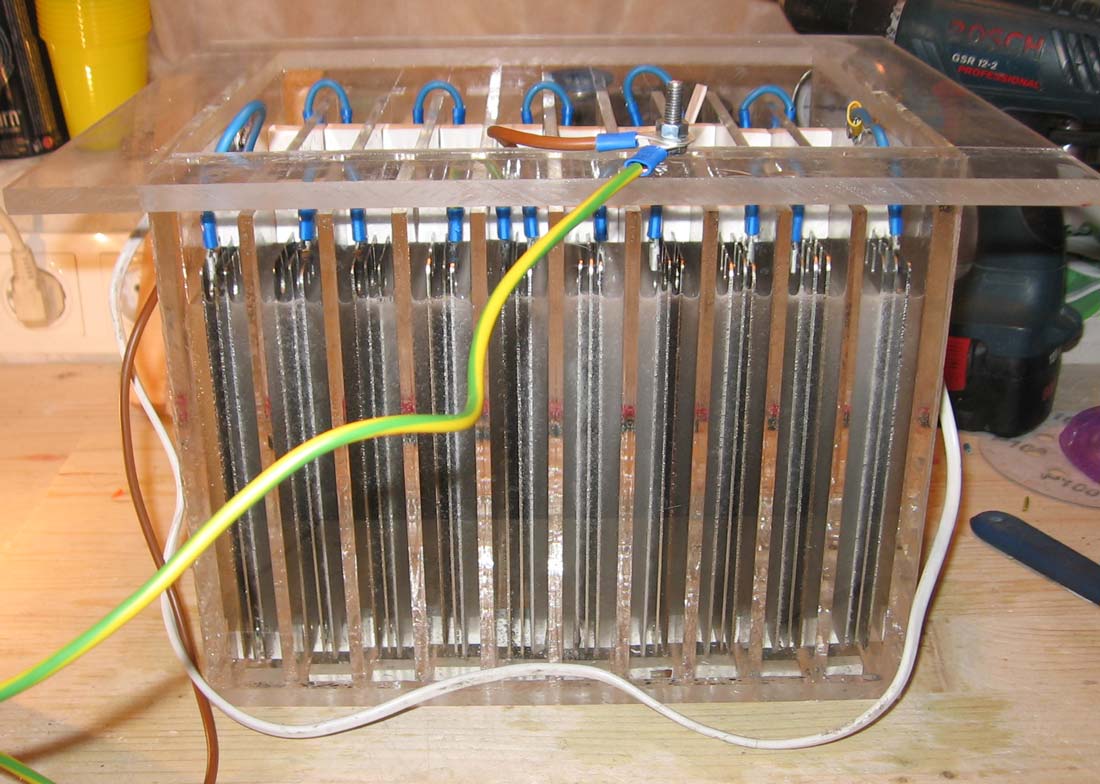

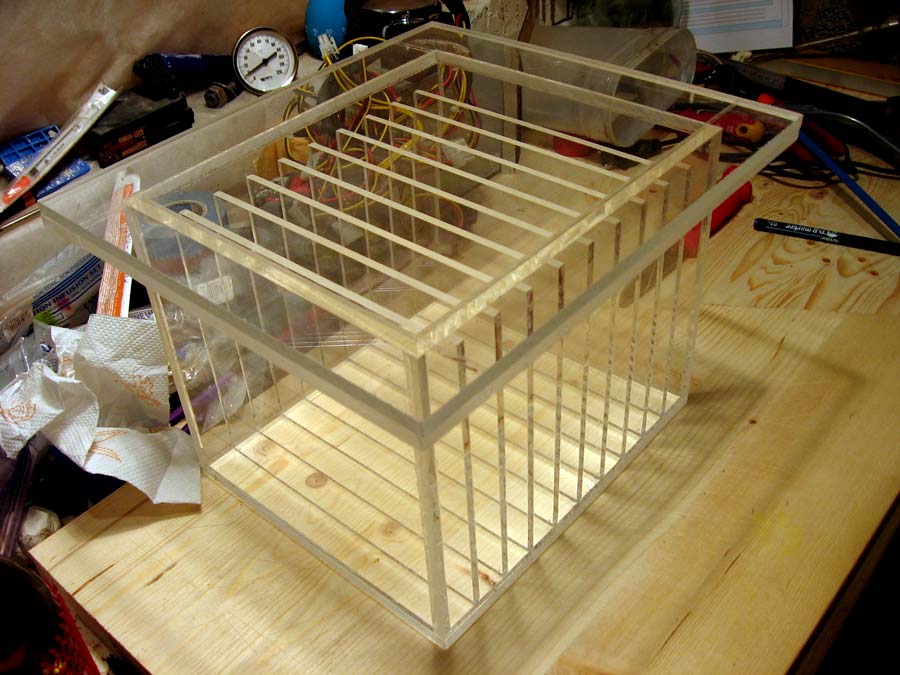

    • Electrolyser with separate cells:
      Hallo!

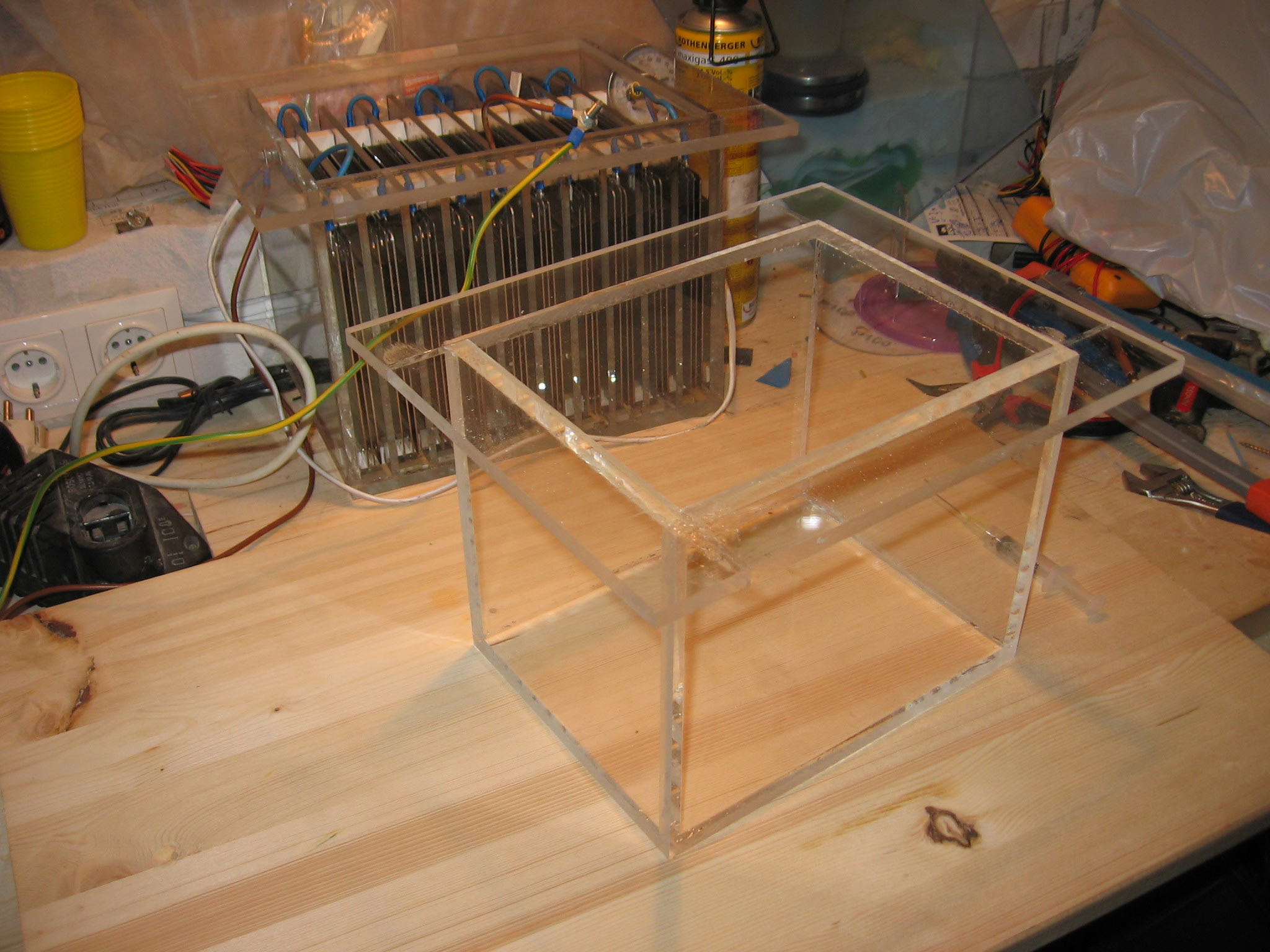

      there can be design with container, i will suggest to use plexiglass. draw a blueprint with all needed pieces in needed sizes and go to 'adwertissement materials' workshop, where plexiglass will be cutted in your's specified sizes. later you can glue them togeather using dihlorethane (CH2CL2)
      but also there can be design that did not use any casing at all
      there is container from 8mm thick plexiglas, and assambled with stainless steel plates, can be seen in attachments. also, with distancers from white eraser rubber it has 10 cellls, and 3 steel plates in each cell, but if you want to make separated cells, it will be better consider how much cells will work most effective, to get 1,47V on each cell. there are great importance of electrolyte density (i used KOH with destilled water) the more gap - the more must be density. also, if electrolyzer draws too much Amperes, than electrolyte can bee made poorer.
      but this design has some problems - low efficiency because not all of surfaces are used. and dangerous risk of little electric spark, between connectors and plates, it is not safe left electric connections abowe water line, or if, they must be solid and welded, so no spark can happen.

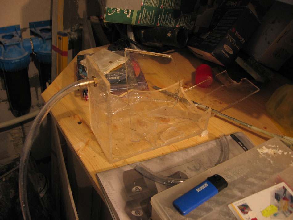

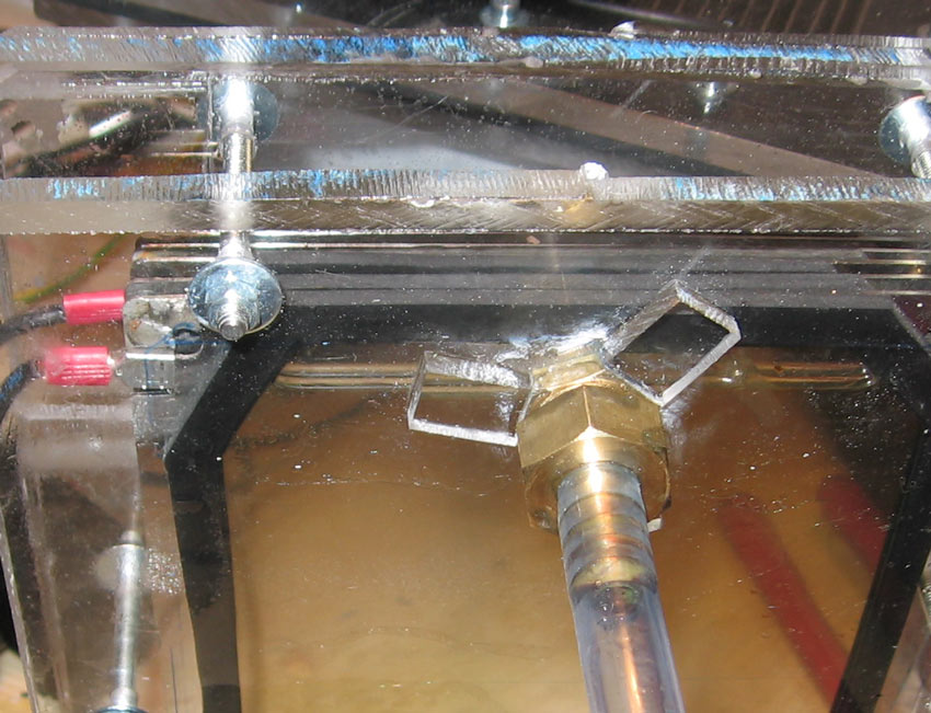

      there in pictures you can see exploded bubbler, this was made from plexiglass, it exploded because of too weak gass flow through the torch nozzle, so, flame speed excess gas flow speed, and get into torch, where it heat bronze wool, and some seconds later, heat gets through bronze wool, and bang, there goes shivers of bubbler

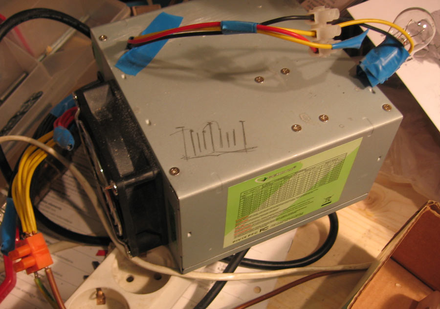

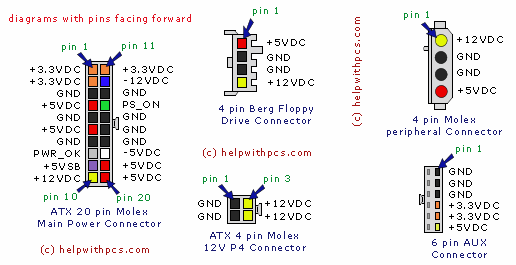

      last two files are about computer atx power supply, that can be used for electrolysis, because psu have 12V dc, and about 30Amps if two of 12V lines joined togeather (simply take all yellow wires as (+) and all black wires as (-) ground) there will be instruction how to correctly power on atx psu.
      the effectiveness in this case, can be wery good if made properly. but there was some faults with my setup, lack of ampere meter and so on...
      i am sorry for ruining your reading pleasure with my bad english...

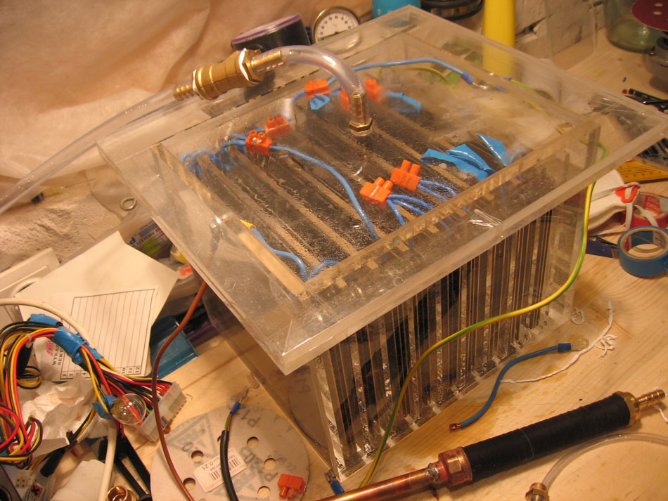

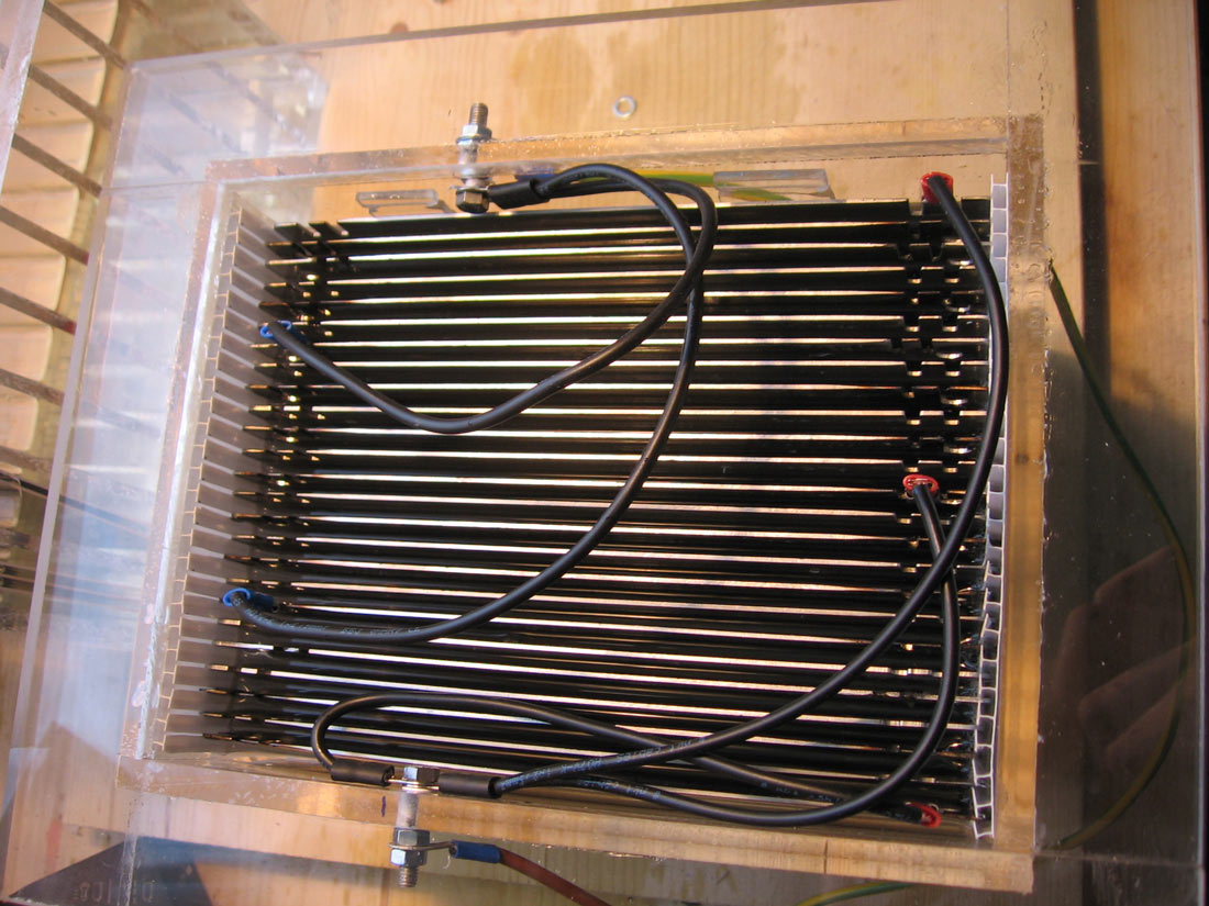

      • Electrolyser with all cells in a row:
        so, the next test setup was all 30 plates in one row, and (almost) watertight sealing between them, so, in space betveen every two plates must be an active cell. this design is even better than separate cells, because there are much less non-active sides. there are 24 cells, with 48 active plate sides, only two last ones are not taking place in electrolysis. this makes active area of 1,7square meters.
        - but separate cells - there where 10 cells, with two plates, two sides were inactive in every cell, summary 20 inactive sides or only 0,58square meter active area.
        this electrolyzer is even smaller than old one. in pictures can be seen wiring shematics, all 24 cells are divided to 4 sections, with 6 cells in each, that make 2V in each cell, if using a computer psu. but there died my psu, because strange thing happened in electrolyser - the cells where not absolutely watertight, so electrolyte can bypass between small gaps in policarbonate distancer. also, there where no hho producing, even no one bubble in bubbler
        i think, that electricity flow directly by easy way, not throug steel plates, this resulted an oveload for psu, too much amperes draw. so psu powered down, and created some smell.
        this cell design are from Yull Brown's patent drawings found in wikipedia, in HHO article. i think, if i would make correct watertight sealing betveen plates, this design ought to be effective and good working.

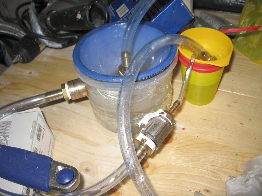

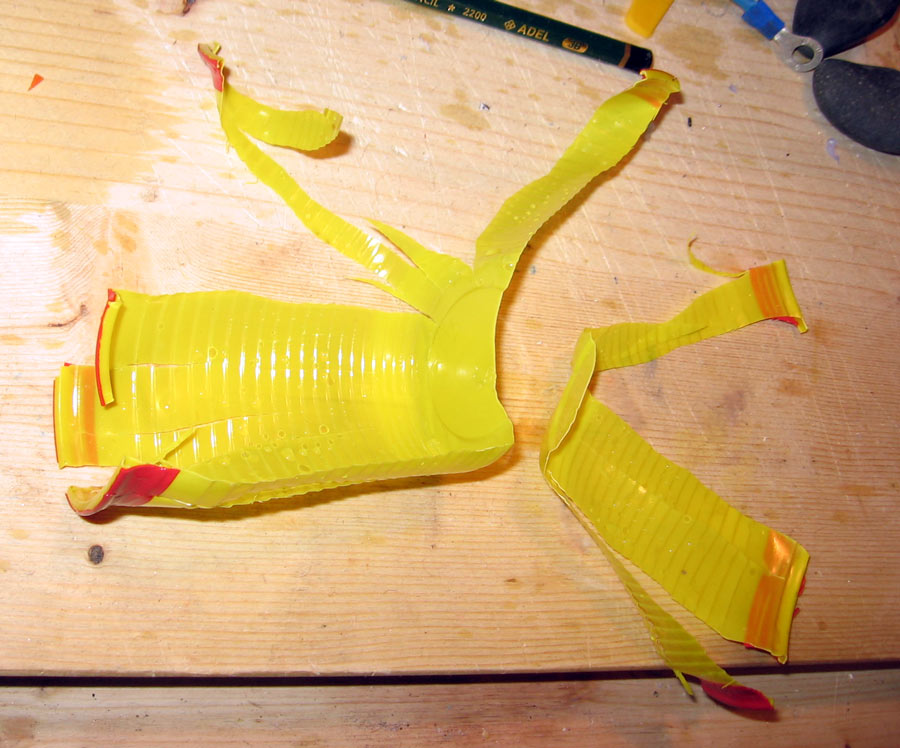

        last pictures - there were some accidental explosion, but no harmful, because of using this yellow plastic cup, for bubbler, it explodes, but it is easy restored - just take another cup, and seal it with electric tape (red) white cup with blue cower is just second bubbler for additional safety, and KOH recovery from wather vapour what comes togeather with hho gas.
        but explosion, even with so small amount of gas, and so thin and light plastic cup as a bubbler are loud enough, to make anybody nervous

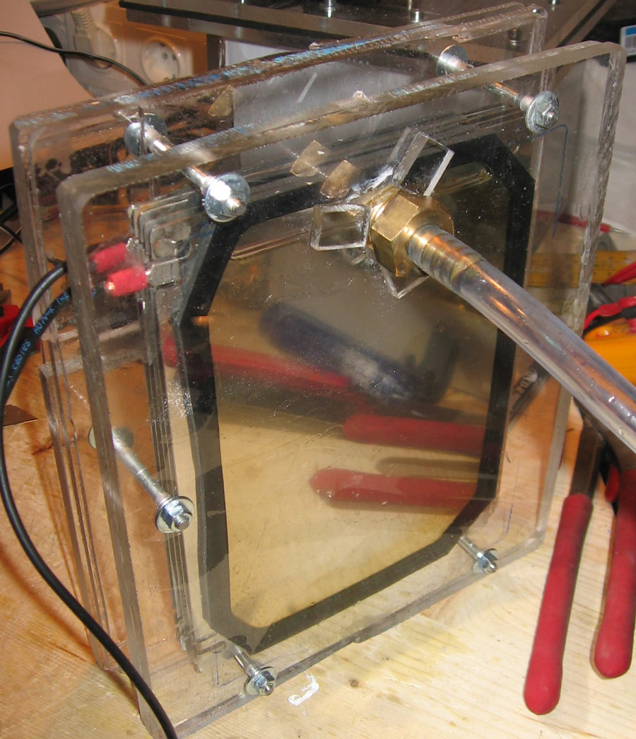

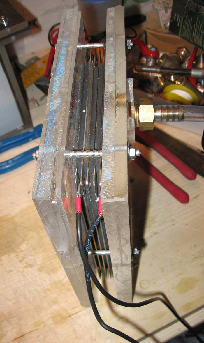

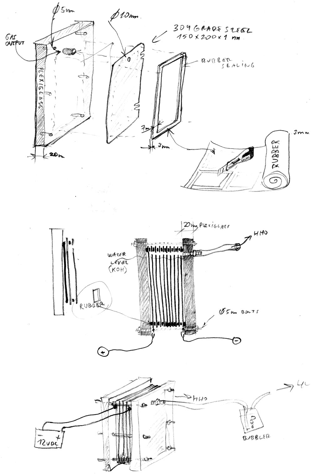

        • Design that worked best:
          the first picture is schematic view. metal plates are pressed betveen two plexiglass plates, joined togeather with screws. rubber seal between plates, are handmade cut, from large black ruber sheet, about 3mm thick. assembling was surprisingly fast and easy. of course, the best thing of all, is that it WORKS! at least, it draws ~25 amperes, and i fed it from old car battery approx ~11-12V. the gas production was awesome bubbler bubbled loud and joyfully
          now im considering about using more stainless steel plates, to make more powerful gas production, to get good stable gass flow enough for making a good hho flame.
          at the end, i suggest this type of electrolyser for everybody, because
          1) it works wery well
          2) building is easy and fast, and without tricky machinery.
          3) there are no dangerous issues - there can not rise spark inside hho generator because of bad wiring joints.
          4) wiring and connection are wery easy and safe, with normal wire connectors, and easy to change different wiring shematics, you can divide electrolyser by 4 sections with 3 cells in each, or one section with 12 cells, without even opening cover and touching the electrolyte
          only one hard work - to drill one 10mm hole in each stainless steel plate's top (for gas outcoming, and electrolyte filling)
          in first test setup, KOH was about ~1:10 or less. there are 5 plates, 4 cells. 12 volts - 3 volts on one cell. to get needed power - not overload, and not too less, you can easily change electrolyte, adding more water or more koh, to get needed electrical conductivity, that the electrolyser will draw exactly the same amount of power needed to not overload psu. also, it is worth trying to get (in many sources claimed) best effeciveness when amp draw are max but voltage on cell don't exceed much over 1,47V.
          and, if you make more sections with some cells in them, remember that if they are connected paralell - the resistance of hho generator gets low, and more amps can be drawn, and there must be taken care for the power supply.
          my apologies for awful grammar
