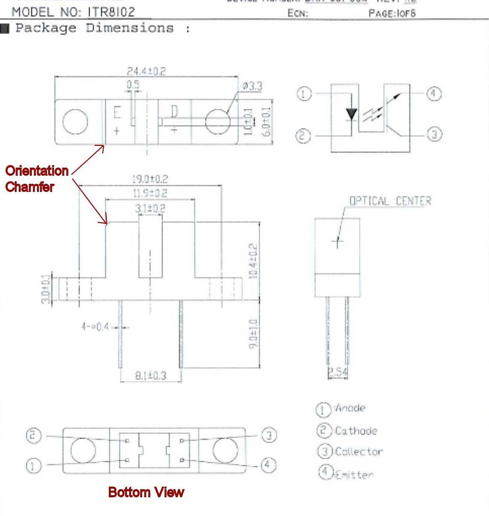

                        • Orientation
                          Sometimes when I assemble things, I make orientations mistakes. Hope the attached helps.
