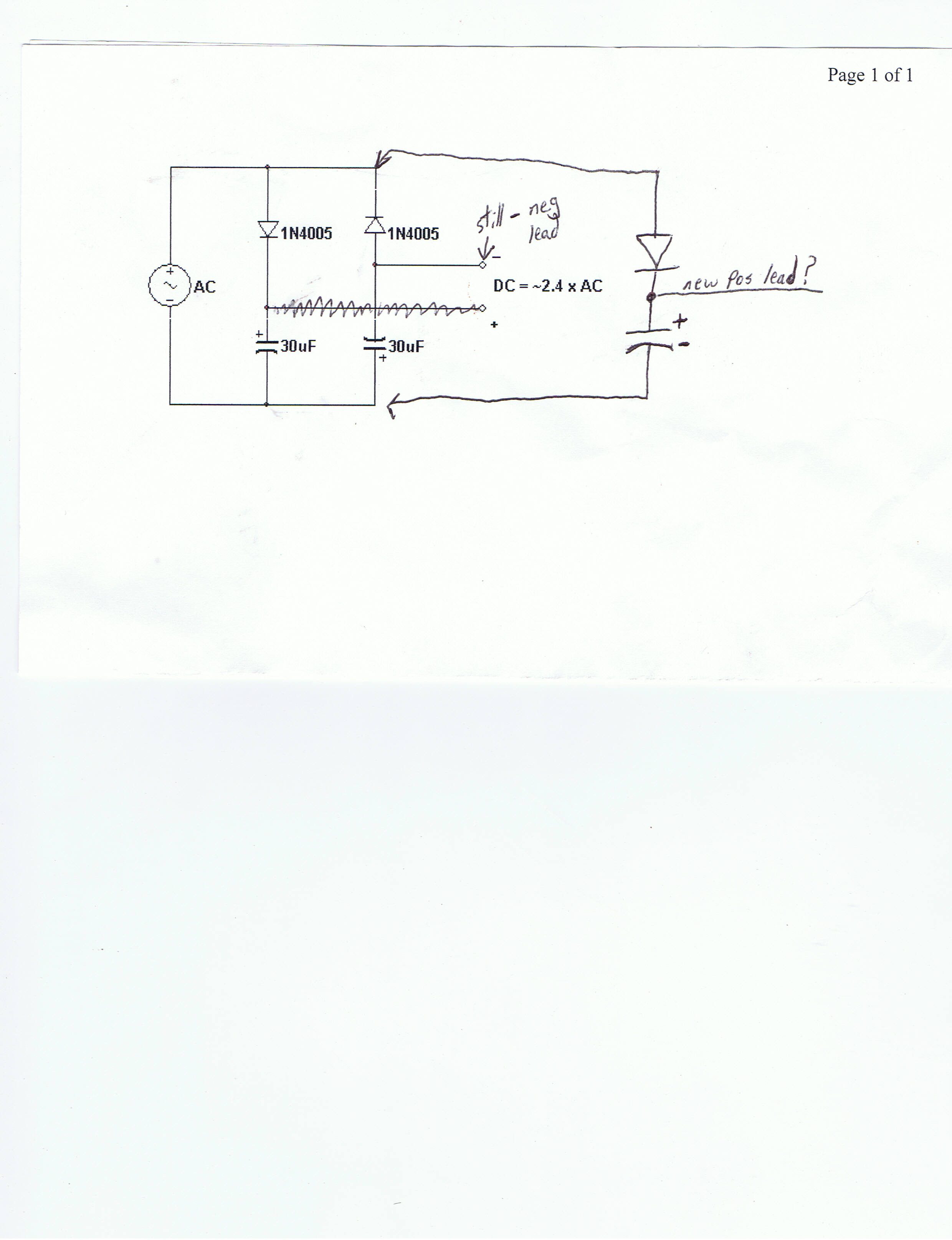

I accidentally left the MOT primary hooked up as my resistor (only 1.1ohms resistence), spun the distributor shaft by hand and dang near blew the ends off the spark plugs!!!
Works fine. I used a 75w light bulb as a resistor. At first I made a test with no vexus circuit attached, no booster side, just an ordinary spark. I made the test for longer time to get more accurate results. The ordinary spark circuit did consume all the fuel in 45m40S. Then I attached the vexus circuit with a voltage doubler. I also attached a microwave diode connecting the ignition coils LV positive to the HV output. And I attached a diode string in series with the ignition coil secondary to prevent the booster cap discharge through the secondary in between the pulses. This is the circuit that I used:
