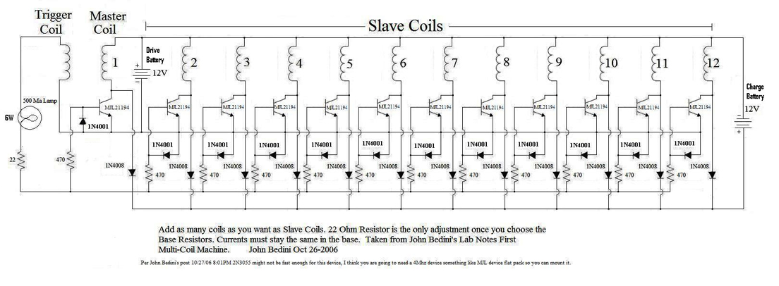

            Thanks for your help at steering me in the right direction, Aaron. I did find information about timing at the original SG forum site, and also found a nice schematic showing a 12-coil circuit using a single trigger ( see http://f1.grp.yahoofs.com/v1/sMI1SJ_...%20Machine.jpg ), so most of my questions are now answered. Thanks again, Rickoff

              You're welcome Rickoff! Do you have another link for that pic? The one you posted doesn't come up for me.

                Hi Aaron,
                The link I provided does work - I just tried it - but you must be signed in to Yahoo groups first. Go to Yahoo! Groups - Join or create groups, clubs, forums & communities and make sure you're signed in, then click the link I posted. It looks a bit blurry on my 19" diagonal widescreen monitor, and it won't print well either, so I copied it and loaded it into Adobe Photoshop and resized it for a landscape 11.5" page in jpg format, and I can now view or print out the full diagram much cleaner. Here's an attachment of same: Click image for larger version
Name:	Mono_Pole Multi-Coil Machine schematic.jpg
                To save the jpg image to your computer in best quality, right-click the thumbnail image and choose "Save Target As."
                Rickoff
