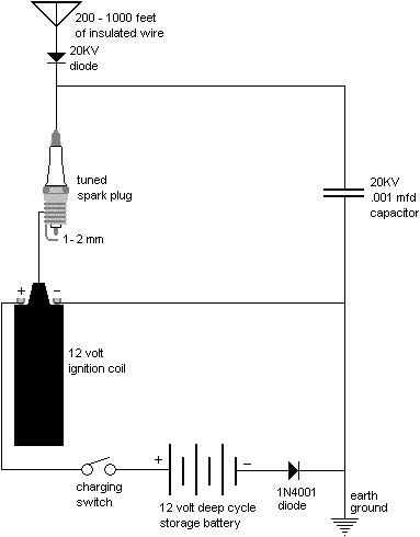

                    Earth batteries...
                    Ok, I have now three schematics for an earth battery. I purchased a 12 Volt auto coil, and have 150 FT of coax, and another 50 ft shorter, and 100 feet of speaker wire hooked up to the battery. I am using a spark plug...
                    The capacitor I am using is a motor capacitor.
                    Questions I have ....
                    1. Should I measure any voltage from the antenna to ground?
                    2. Does the UF of the capacitor matter, should I use a different capacitor?
                    3. Lightning is not my friend.... I guess i should pull the plug on this when storms come by.
                    Mart

                    • #40
                      Mart
                      When I did this experiment last year I noticed some things.
                      The antenna has to be off the ground and it can't be near any grounded object like a tv antenna. As you approach ground the antenna voltage weakens to 0 volts. The cap should be in the picofarad range at least 100v or more. Definatly remove this thing before a thunderstorm.
                      I found the voltage stratifies like thermo energy but if you are in a vicinity of ground the voltage will be significantly less. People walking by affected the voltage. If you have no choice but to attach it to metal objects use a string or other non conductor to get the antenna wire as far away from the grounded objects as it is high. Also I would put the spark gap(which is fuctioning as an oscilator in this example) right off the antenna as you dont want to bring the antanna down because the closer to the earth that antenna wire is the lesser the voltage- like putting a voltage divider circuit on it. You will only get potential very little current at all nothing that will measure easily. The Spark Plug is great but you might want to start with a smaller gap by bending the electrode strap withing three sheets of paper thichness of the anode.
                      • #41
                        RE: Suggestions
                        Thanks for the tips... I will have to pick up a different capacitor. I am using the center of a cable tv cable as pick up so it should not be touching anywhere, and it is about 20Ft in the air. ( I could go higher if I climbed the tree )
                        But I have 3 designs, the one I currently have has no diodes, I think I will move over to the one that has diodes, and see what that yields.
                        thanks!
                        Mart
                        See my experiments here...
                        • #42
                          Thunderstorms
                          Hi Mart,
                          Just having a quick lunch break at the cottage, and reading your post. If you look at the last circuit I sent you (the one with the diodes) that gives values for the capacitor and other components. I don't have the link handy here, so maybe you could post that diagram for others who are interested. I would definitely suggest adopting the "overshoot protection" device shown at the bottom of the web page that relates to the Peswiki experiment I referred to in my page 1 post concerning antenna battery charging. The overshoot protection is simple (just a few nuts and bolts, in two parallel boards, that can be adjusted to gaps between them of about .045 inch), and would be parallel to the spark plug input, but branch directly to ground. This protects your components, and battery, from high surges, so that you don't have to fear thunderstorms. Of course you want to have a kill switch device so that the system can be shut down in the event that a lightning storm is passing overhead, but a storm can break quickly and you may not be at home when it does. By all means use every possible safety precaution, including overshoot device, breaker, etc.
                          Rickoff

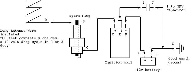

                          • #43
                            Thanks Rick!
                            I have attached both diagrams
                            I don't believe I had the first one hooked up correctly and that might be my main problem.
                            I was wondering if I should be attaching both the shielding of my cable with the center part as well
                            But for now we have had several thunderstorms so... I have unhooked it so I sleep better at night
                            I have been searching for the 20KV .001mfd capacitor this requires, and I have not come up with much. Maybee it is listed in different units?
                            I have been thinking about taking my bicycle generator and feeding the capactior with the output to see if I can get a spark. Normally I can fill a cap to 32 V with that in a very short time. I might have found a new method of collecting the energy from the SSG........
                            Again thanks Rick for your insights into this.
                            Mart
                            • #44
                              capacitor
                              Hi Mart,
                              A .001 microfarad capacitor is the same as a 1 micro micro farad, or 1 picofarad capacitor. If I remember correctly, one of the antenna battery charging article authors said that he used a cap from a discarded TV's horizontal output section.
                              I would try experimenting with the coax wire 4 ways - center alone, shielding alone, connected together at the spark plug, and connected together at both ends. Then let us know what differences you observed.
                              Thanks for posting the circuit diagrams, although the second diagram in your post does not open properly - it only shows a spark plug. Perhaps you could try that attachment again. Thanks, Mart.
                              Rickoff
                              • #45
                                Try #2
                                Ok attached it the picture again. Hope this time it goes. It does not seem to like gif files.
                                I did not think of connecting the sheilding to the wire at the end.... that is an idea...
                                mart
