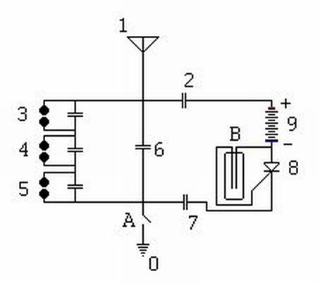

    2nd diagram
    That looks much better, Mart. Thanks. As can be seen in the 2nd diagram, the capacitor value is 1 picofarad, 20 kilovolt. The spark plug gap is suggested to be 1 to 2 millimeters, which would be .040 to .080 inch. I would start on the low side for the gap, using .025" to .035" which will give you lower voltage spikes, but the spikes will occur more often. See what your results are, then try larger gaps under similar weather conditions to see what the difference is in battery charging rate. It's important to compare under similar weather conditions, because colder days and inclement weather will naturally increase charging activity. Remember too, that whatever your spark plug gap is, the gaps in your overshoot device should be about .010" larger. As I said before, you can make your overshoot safety device form two parallel boards with adjustable bolts to make the gaps. You could also use three more spark plugs instead of the bolts. Here's a diagram of the solid state antenna charging system, with the overshoot protection seen at the left side of the diagram. [IMG] http://www.energeticforum.com/attachment.php?attachmentid=634&stc=1&d=1213558428[/IMG]
    Best regards, Rickoff

      I am thinking I want to test this by taking one of my pickup coils from the ssg and dumping into the cap to see if I will get spark.
      I did see that this would be just the thing for my windmill coils as it should not create a drag on the ssg but would discharge the current when it built up to the gap of the spark plug.
      Again thank you for your info.

        antenna/ground battery charging
        I found out that the circuit diagram on this link you posted is not correct.
        battery charged by 200 ft antenna wire.jpg - Windows Live SkyDrive
        you want the input voltage from the spark plug go to the top cap of the ignition coil as one is using the ignition coil as a step down tratnsformer. the way the diagram incorrectly shows is, as hooked up to the side terminal which would boost the voltage up more.
        So those two wires need to be swapped in the diagram. If you read the instructions on that third link then it explains it like that.
        I wonder how many batteries can be charged like that.

          Reply to Vzon17
          You are absolutely correct, and I thank you for pointing that out. I deleted that diagram from my Sky Drive. The other diagram which utilizes an automotive coil, spark plug, and diodes, does show the correct configuration. I don't know why I didn't notice the error before, except that my eyes are definitely not as good as they used to be, and I have a huge "floater" in my left eye that casts a blurry shadow upon whatever I am looking at. I hope that the faulty diagram did not confuse anyone. I did not draw that up, and am not sure where it actually came from.
          Thanks again,
          Rickoff
          p.s. - Thoretically you could charge any number of batteries, but the charging would take longer for each battery added. You can offset that by raising and lengthening the antenna wire.
